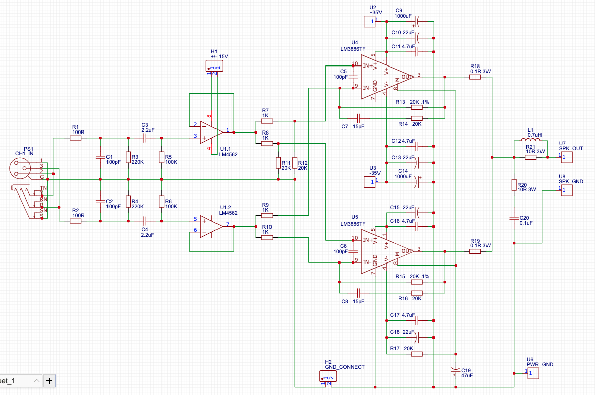

Here is the first revision of the concept that I was thinking would be a cool development on the schematics in the first post. The idea was to be able to power the amp using +/-35V. To do so, according to Tom from Neurochrome, we need to use two LM3886 chips so that they can share the load current.
Input buffers are just voltage followers - I am assuming they should not leak any DC to the inputs of the LM3886. I have DC blocking input capacitors before voltage followers for that purpose.
I wonder if it is possible to utilize servos in such configuration to reduce DC offset at the LM3886 outputs? Should it be hooked up to inverted, or non-inverted inputs of the LM3886?
Any thoughts or comments are welcomen 🙂

Regarding your schematic (I forgot to comment before):
I think you'll probably have a DC offset problem as shown. In my design, there are coupling caps between the input buffers and difference stage, which means that the effective DC gain of the LM3886 is unity. Ci in the datasheet application circuit does the same thing. In your design, the DC gain is 21. The typical and limit input offset voltages are 1mV and 10mV for the LM3886, so in your circuit the DC offset at the output could be as high as 210mV (not counting any DC from the input buffers).
You have R13 and R15 marked as 0.1% tolerance, but R7 through R12 should also be 0.1%.
The common mode input impedance is a bit low at 68.75kΩ.

Assuming this is instrumentation amp configuration, the gain of the first stage at buffers is g = 1 + 2*1k / 2k = 2; the gain of difference amp LM3886 g = 10k/1k = 10. Total gain is equal 2*10 = 20. Is that correct?
I'm still trying to wrap my head around differential signaling. I'm confused if the gain needs to be multiplied by the factor of 2 since there are two signals that are being fed into LM3886? So the total gain is 40?
Don't you worry, this got me confused till some time not so far in the past. In fact if talking about 1V RMS differential usually there's "0.5V" RMS on the positive side (i.e. pin 2 of an XLR) and "-0.5V" RMS inverted on the negative side (pin 3 of an XLR) which will have a difference of 1V RMS exactly. It's all about differential - the difference between "0.5V" and "-0.5V" being exactly 1V.
Why I say usually? It might as well be "+1V" and "0V" on the two pins - or vice versa. It's still differential, just not balanced in that case.
It's still balanced and differential, but the signals are not symmetrical (see the "Take-home messages" box on page 3 of The G Word)It's still differential, just not balanced in that case.
No, it's still 20. If you have a 1V RMS symmetrical differential signal, you'll see 0.5V RMS on the + pin and 0.5V RMS (with reversed polarity) on the - pin. Why? Because a differential signal is the voltage difference between the two pins. 0.5V-(-0.5V)=1V.So the total gain is 40?
If you have a 1V RMS differential signal that is not symmetrical, the voltages will not be exactly opposite each other, but the difference between the two pins will still be the same. For example, you could have 1V RMS on the + pin and 0V on the - pin. The difference is still 1V-(-0V)=1V.
