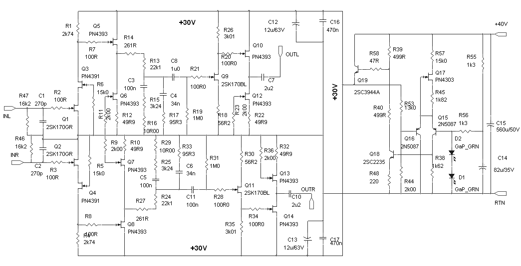

I'm waking this one up, as there is interest in some quarters in simple jfet open loop designs, and this is the first one that I did. It's basically the 2-fet Pacific design with cascode and added followers. It's hard to believe the design is 7 years old now.

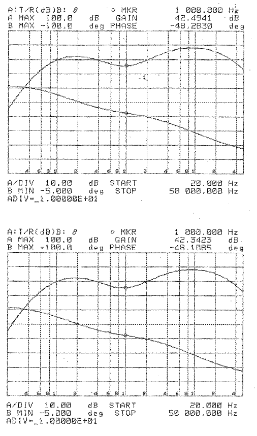

Anyway, what I did was to take the original board from this thread (not documented all that well, so I'll draw and post a schematic later) and plot the gain-phase using an HP4194A gain-phase/impedance analyzer. The gain matching between channels was surprisingly good, even for this first effort.

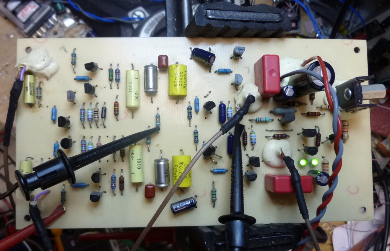

Here's a picture of the unit in question - doesn't look like much. The RIAA caps are a Wesco metalized PP (yellow) and a 33nF PP film/foil (silver) selected for 34 nF. The stubby yellow interstage coupling caps are Southern Electric (F-dyne) 1uF PC units, and the red output caps are 2.2 uF Wima MKS-4 PC. The yellow loading caps at the input are IMB polystyrenes. The on-board regulator is a discrete series pass circuit of my own design - I eventually changed to shunt regulators in later designs. The two green LEDs are the voltage reference for the regulator.

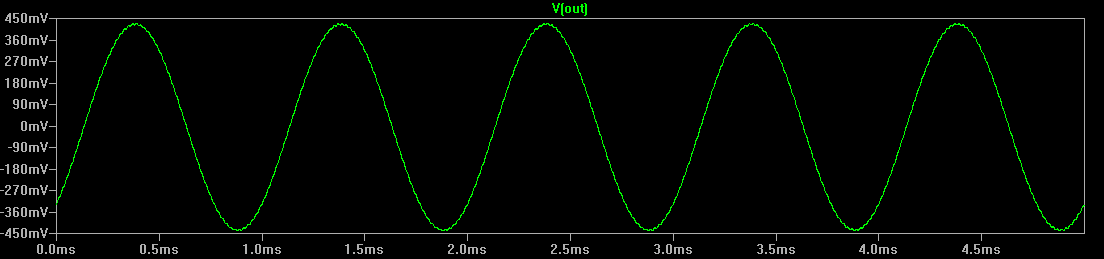

What do you think about this circuit?
It has nice gain and low distortion:
Fourier components of V(out)
DC component:-0.00435251
Harmonic Frequency Fourier Normalized Phase Normalized
Number [Hz] Component Component [degree] Phase [deg]
1 1.000e+03 5.272e-01 1.000e+00 -49.32° 0.00°
2 2.000e+03 1.399e-05 2.653e-05 -173.02° -123.69°
3 3.000e+03 6.353e-06 1.205e-05 -167.83° -118.51°
4 4.000e+03 3.297e-06 6.255e-06 -179.91° -130.58°
5 5.000e+03 2.640e-06 5.008e-06 -179.88° -130.55°
6 6.000e+03 2.200e-06 4.173e-06 -179.87° -130.55°
7 7.000e+03 1.886e-06 3.577e-06 -179.87° -130.54°
8 8.000e+03 1.650e-06 3.129e-06 -179.87° -130.55°
9 9.000e+03 1.466e-06 2.781e-06 -179.88° -130.56°
10 1.000e+04 1.319e-06 2.503e-06 -179.91° -130.58°
Total Harmonic Distortion: 0.003110%(0.003252%)

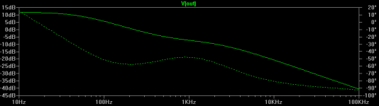

Here is the AC analysis:

Well, you have a 40V supply with a 25V rated jfet, that would give me pause. A substantial negative signal at the preamp input might put the whole Vcc supply across the input jfet. Running the VCC at ~30V would help. I start with a 40V supply and knock it down to 30V with a shunt regulator.
Cascoding the input jfet is a good idea, especially if you plan on using an MM cartridge. Miller capacitance multiplied by the first stage gain might take the input loading capacitance beyond what is optimal for a given cartridge, when you add up the contribution of tonearm wiring plus cables plus input capacitance plus amplified Miller capacitance.
As far as RIAA cap values are concerned, you might have an easier time finding parts if you use 100nF and 34 nF (33nF + 1nF).

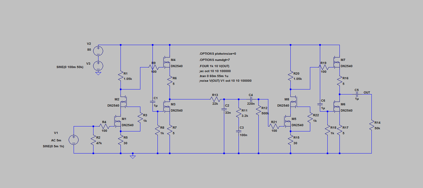

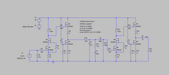

I've simulate this circuit using DN2540 depletion mode mosfets and 80V power supply:

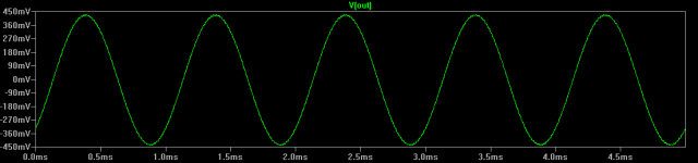

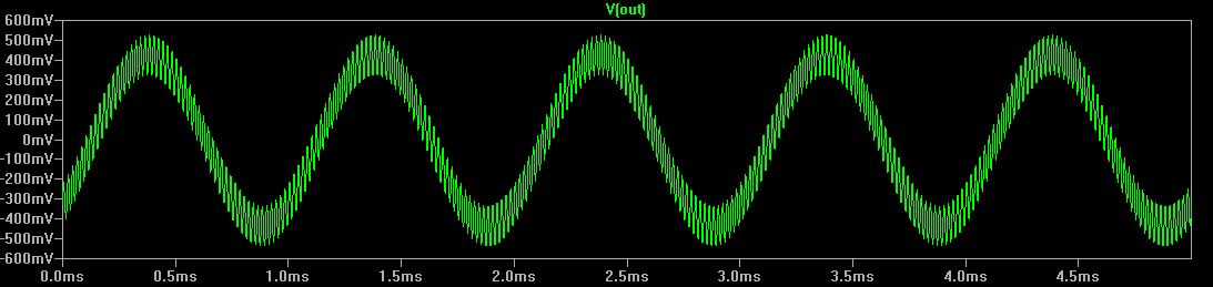

As you can see I've put an AC voltage source in series with the DC source, to simulate power supply ripple. The 1uF caps that go from the DC voltage supply to the gate of the mosfets on the source followers after gain stages are there to inject power supply noise. That noise will null the noise brought by the gain stages (yes, it's just Broskie's Aikido technique). It works. Below you can see two transient analysis: without and with these caps.
The circuit with the caps reject power supply noise way better.
The gain stages use cascoding to overpass the higher input capacitance of these mosfets, compared to jfets, and to bring gain up a little.

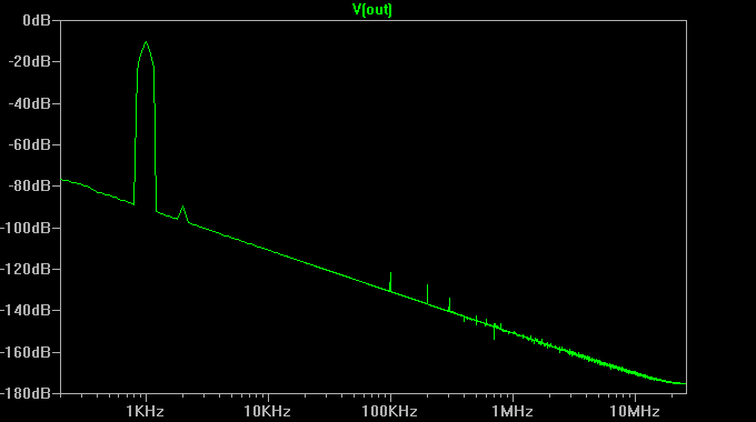

What about THD?
5mV input --> 450mV output (0,0125% THD)
50 mV input --> 4,5v output (0,15% THD)
100 mV --> 8,2V output (0,3% THD)
200mV input --> 18V output (0,6% THD)
300 mV input --> 25V output (1,47% THD)
This is the THD plot with a 5mV input:

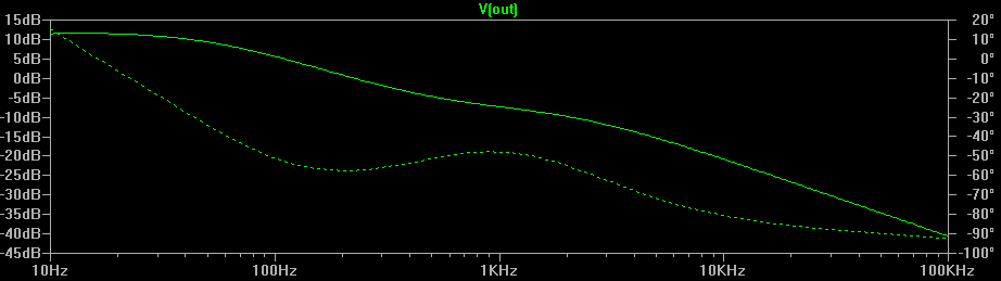

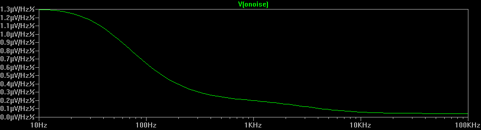

To complete the image, here are AC and noise analysis:

I generally relegate the DN2540 and siblings to current source duty because of the high input capacitance, which may make it impossible to properly load an MM cartridge. Infineon has some surface mount depletion mode mosfets with lower capacitance. The LND150 also has much lower capacitance, but at the cost of much lower IDSS and transconductance.
I don't worry about ticks an pops introducing distortion, as an open loop circuit should handle overload relatively gracefully, unlike a feedback-based amp, which may temporarily go crazy during clipping events.
