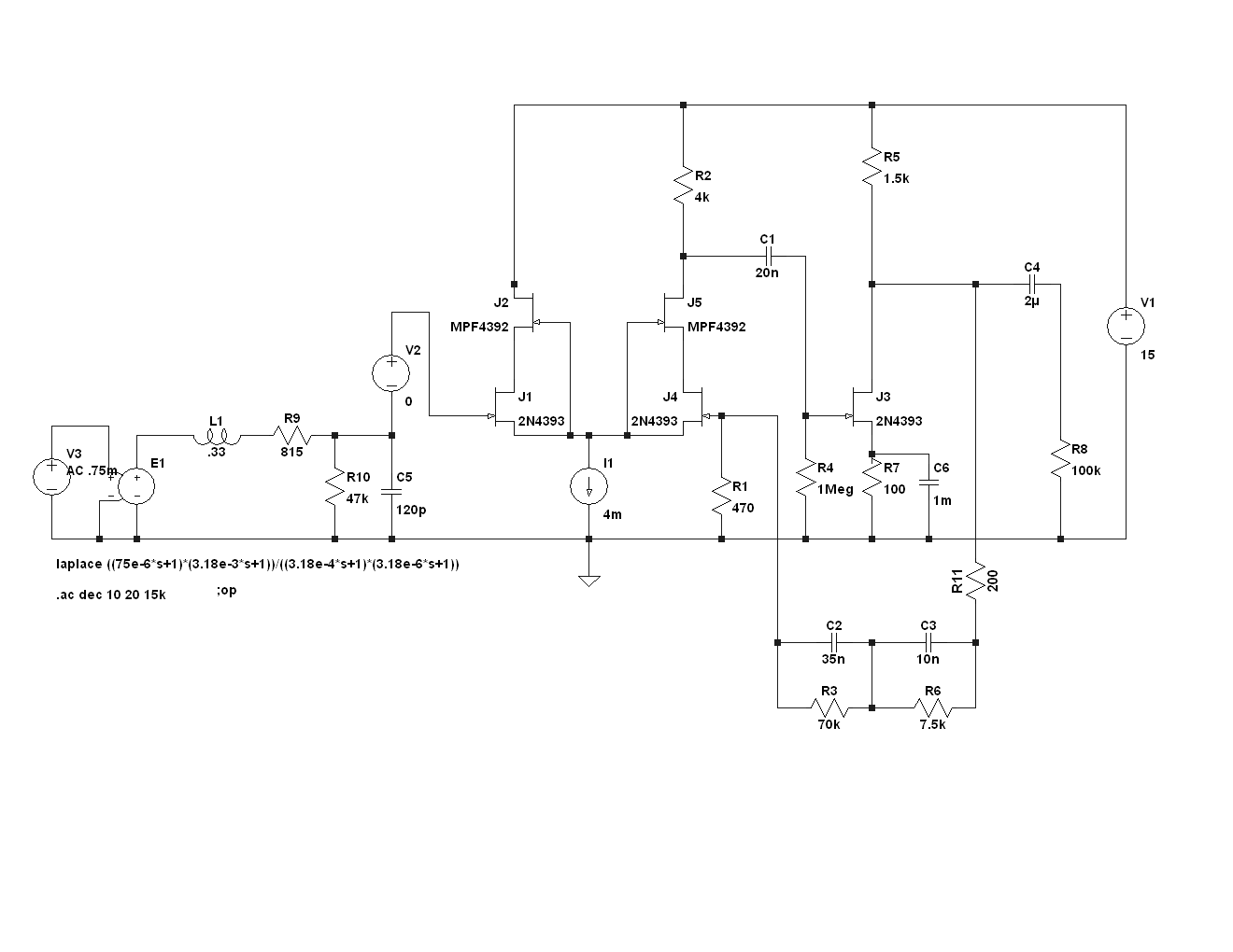

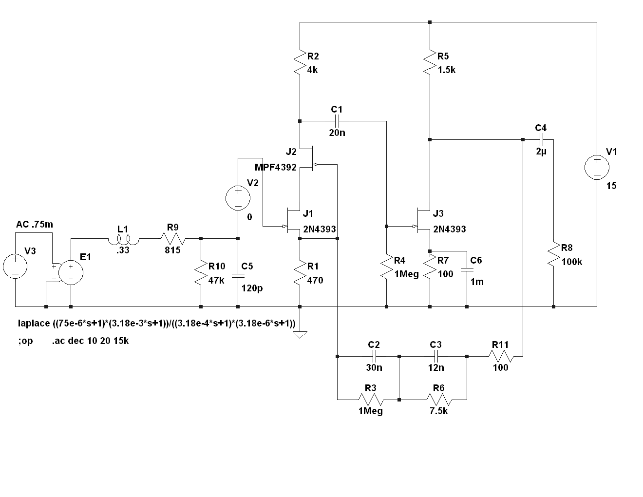

I simulated 2 versions of simple RIAA active feedback preamps with cascoded JFET inputs, one single-ended, one differential. These have Avol of 50dB and feedback network is set for 27dB gain at 1kHz, too low for normal use but easy to calculate for +/- 1dB RIAA accuracy. I checked the AC input impedance magnitude by AC analysis, applying RIAA input, 7.5mV @ 1kHz. At 1kHz se was 552Meg, diff was 498Meg, at 15kHz se was 149Meg, diff was 159Meg. So at least by simulation in these simple cases, there is no significant difference in AC input impedance with frequency, and I can't see how cartridge interaction would be different.
This is the single ended version:

Power dissipation - true, 200mW dissipation will bring a TO-92 transistor to around 100C at room ambient. However, simulations don't get hot, and there are ways around the problem. First would be to use a lower ranking FET that would have a lower idle current for the same VGS. The model Orcad uses for the PN4393 is middle of the road, probably 20-odd ma IDSS. Since the IDSS spread for the PN4393 goes all the way down to 5ma, there is plenty of room for selection of a lower IDSS device. I also tried manipulating resistor values to get a lower idle currrent, yet retain the same stage gain. I was able to get the idle current down to about 5ma. With this idle current, the harmonic structure after simulation is almost exactly the same as with the higher idle current. However, there is a better way to solve the thermal problem and several others - read on....
VGS and impact ionization - If you can get a full data sheet or a family specification for a JFET, there will be a curve for gate leakage current vs VDS. This curve is fairly flat for lower values of VDS. For higher voltages, there is an inflection point, then the gate leakage starts to rise eponentially with VDS. The voltage for this inflection point depends on FET design. For the PN4393, it's about 15V, which turns out to be pretty high compared to other FETS. The 2SK170 data sheet does not even bother to show the flat portion of the gate leakage curve. The leakage is already in the exponential region at 8V VDS. This is not too surprising, given the large gate area required to get such a low noise device.
The Siliconix FET application manual advises one to bias a JFET in the flat region of the gate leakage curve if low drain leakage is of paramount importance. No doubt this also releives any concern about impact ionization. Operating in the lower portions of the exponential region probably wouldn't be a big disaster. I imagine that just about every non-cascoded 2SJ170 design out in the world is operating this way. It would probably take some advice from a very seasoned and savvy JFET apps engineer to determine just where impact ionization will start to be a problem. Maybe I'll try giving Siliconix/Vishay a call - they're about ten miles down the road from where I work. At any rate, there's a simple solution to fix this problem for the most part, at least regarding the SE folded cascode circuit originally cited by Werner - read on...

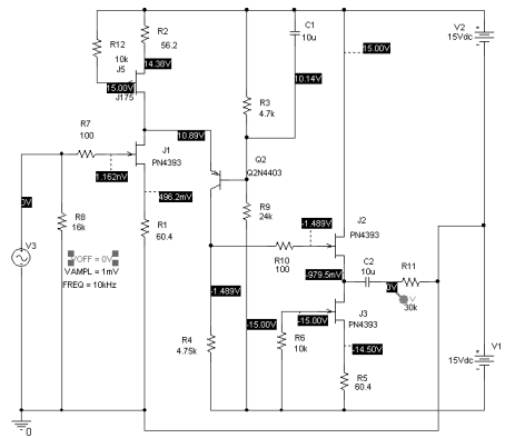

Solutions - As an engineer, I was bothered by the poor ripple rejection of the original resistor loaded folded cascode circuit cited by Werner, but also apalled by the harmonic structure of the first current source loaded solution that I simulated. I went back to the current source loaded circuit and substituted a perfect current source for the original transistor current source. I was expecting worse simulation results, but instead, the harmonic structure turned out to be as good or better than the resistive solution, with 0.005 % THD, all second harmonic.
Substituting a p-channel JFET current source for the perfect current source is almost as good. In this case, I used a J175 p-channel FET, which is normally used as an analog switch, but can be operated successfully in the linear region, just like the PN4393. This left the problems of gate leakage/impact ionization and power dissipation in the input PN4393.
The solution for both these problems is to split the power supply from a single +30V power supply into a +/- 15V supply. The input JFET and current source FET are operated from the +15V supply to ground, The rest of the circuit is operated between the +/- 15V rails. The cascode transistor works admirably as a level shifter. The PN4393 now operates at a much lower VDS, solving both the power dissipation and gate leakage/impact ionization problem. The simulation shows just a touch more 3rd harmonic distortion as a result of this change, but all the higher order harmonics are way down in the mud, and the THD is still atound 0.005%. This is pretty good for an open loop design. As usual, the challenge will be to see whether the circuit measures as well as it simulates.
The circuit I simulated is shown in the attached figure. I could work a little harder and get better output voltage centering and reduce the idle current, but I didn't bother for now. I think it is also possible to use a bipolar current source and get about the same results, and I think I know how. This is left as an exercise for the curious.

The next in line for incorporation and testing in my preamp box is a closed loop folded cascode design. The inputs are your classic diff pair using matched 2SK170s, essentially a discrete opamp. The RIAA section of the preamp uses two of these opamps with passive equalization in between. The lineamp is a pair of the same discrete opamps configured for a gain of +5.
After the results I've seen so far with the first setup, the Nikko is relegated to the shelf as far as I'm concerned. When I get the closed loop stuff in place, it will be the subject of a second thread, though I'll probably end up referencing this one. I might do a third set of tests using the folded cascode design when I figure out how to optimally use it.
I tried doing some extra cascoding with the folded cascode as you mentioned. but the results weren't worth it (it didn't do anything exciting). The input transistor is already cascoded, and adding a cascode to the current source FET eats up valuable voltage margin. It looks like the key to decent harmonic distribution with this design may be maintaining an adequate voltage across the current source. I proved this by doing a different sort of bipolar current source that minimized the voltage across its emitter resistor, and got a decent harmonic spread.
I just now finished simulating a gain of 5 version of the single ended folded cascode circuit for use as a line amp. Distortion figures are not near as good as those for the follower circuit. I get a THD of about 0.5% at 200mV excitation level, 10kHz. The harmonic distribution is ok, though. A "lower" quality of FET in the input stage actually seems to work better than a classy device like the 2SK170. I ended up using a PN4303 as an input device in the simulation, as I happened to buy a bunch of these from Electronic Goldmine, and they have decent (though not spectacular) gain and noise figures. The humble 2N5457 actually does reasonably decently as an input device in this application.
One of the incentives for continuing with the folded cascode circuit would be to show that it doesn't take an exotic Japanese device to get excellent results in an RIAA amplifier. The PN4393 will have a higher noise figure than the 2SK170, but I suspect that it won't be an issue at all for a MM or MI preamp. The folded cascode circuit also seems to really shine for low input applications. Really, <0.01% distortion for an open loop design is not to be sneezed at....

By coincidence, I've been simulating discrete transistor gain stages for headphone amplifiers, and the classic "Lin" topology with resistive-loaded differential input and single-ended current source loaded second stage can have low distortion, less than 0.005% with non-inverting gain of 3, input is U406 cascoded with MPF4392, with Jung's version of the LH0002 diamond buffer into a 32 ohm load. Avol is about 60dB and stability compensation is needed, 1kHz dominant pole.

One of the things I find interesting about wrenchone's circuit it that it is cap-coupled at the output. This is something that I've been experimenting with recently. My reasoning is that the problems introduced by a capacitor are going to be less than those introduced by a level shifter and the necessary feedback to lock the output to DC.
This is heresy in solid state, but the norm in tubes. It's an interesting option to play with.
I tried a complementary differential in the John Curl mode, but the phase-splitting wasn't sufficient for my needs. (I'm building a balanced circuit. Ideally, I'd like to be able to have the option of putting in either a balanced or an unbalanced signal and having it balanced at the output.) The plus side was that the circuit could be adjusted to have very little DC offset. I worked at it for a while, set it aside, then went back to it again before deciding to go with a single 2SK389 since it offered a good balanced output.
