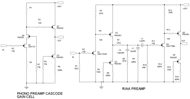

A thread late last year regarding the Pacific passive RIAA preamp inspired me to try some simple open loop circuits to replace my ancient Nikko Beta II preamp. The constraint I set was to use no global feedback. The gain cells I used are shown in the attached file.
The circuit on the left shows the gain cell used in the phono preamp. Like the Pacific preamp, it is a simple JFET common source amplifier, but with the addition of a source follower buffer to supply some output drive capability. The addition of the buffer also makes calculating the RIAA network much easier, as without the buffer you have to add in the contribution of the drain resistor in parallel with the output impedance of the JFET at the drain (no, it's not a perfect current source...). PN4393 JFETS were used in the buffer, as their high IDSS allows relatively high output current. I also had a bunch of them....
I aimed for a first stage gain of 40, and a second stage gain of 30, which gives a 1kHz gain of about 40dB when the RIAA network is factored in. The first stage had no source resistor. One was added to the second stage to reduce overall gain and to increase the overload capability of the second stage. I juggled values to get both the proper gain and approximately 15V at the drain of the 2SK170 for maximum symmetric output swing. Simulation of the gain cell using Orcad showed about 0.2% distortion, flat across the audio range, mostly 2nd harmonic. Measurements with an Audio Precision analyzer showed about 0.4% distortion, mostly 2nd harmonic.

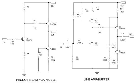

For the line amp stage, I started with a circuit similar to the RIAA gain stage, but as no global feedback was used, it was difficult to tailor the gain and properly center the output voltage to 15V. I used all PN4393s for the line amp, and ended up with a stage gain of about 16 (I would have liked a gain of 5). A gain of 16 was way too much, and made volume adjustment very touchy. I ended up with a unity gain buffer circuit as shown in the right-hand drawing. Use of P-channel JFETs in the input stage provided some distortion cancellation according to simulation (0.02% vs. 0.2%). A nice feature of the new line amp is that the preamp is now non-inverting. No Audio Precision measurements were made, as I made the circuit changes late last night, and the analyzer is at work.
I used a pair of Bourns 100k linear pots for volume/balance controls (either cermet or plastic, I'm not sure which), and law-faked them with a pair of Dale 19.2k MF resistors. I'll try other pots as the mood hits me.
So far, the overall impresssion is thumbs up, though I probably will need to improve or replace my speakers before I can get the full measure of this beast. It's been on for less than 24 hours, so I still have a lot of auditioning to do. I plan later down the line to sub in some folded cascode amplifiers with global feedback and try to see if I can tell the difference.

After a bit more listening, what I can say is that the new preamp seems to bring me closer to the source material than the old Nikko preamp, which had about 5 electrolytics in the signal path, as well as some regrettable design shortcuts. If the source material has been lovingly recorded, the results can be amazing. Two recordings in particular stand out. On vinyl, it's the Muhal Richard Abrams Octet "View from Within" on Black Saint (LP). The instruments are picked out with razor sharpness, and you feel like you're right there with the performers. For CD, it's the Berlin Philharmonic conducted by von Karajan with Anne-Sophie Mutter on violin, performing Beethoven's violin concerto. I've used this recording as a standard for a while, and each improvement I make in the system reveals more.
I selected FETs for the phono preamp gain cells to get decent drain voltage centering, especially for the second stage. The second stage had a source degeneration resistor, which would help to equalize gain somewhat. The gain between both channels of the preamp was pretty well matched, according to scans I did with an HP4194 gain-phase analyzer I have at work. I ended up using matched GR devices in the first stage and matched BL devices for the second stage. The next time I do this, I'll use matched BL devices with degeneration for both stages.
I wasn't aware of the earlier thread, but it covers some paths I've also troddenindependently. When I saw the modified Pacific design in Mad_K's thread late in 2003, one of the first things I thought about was to include cascoding, and I laid out my PCB to include cascode JFETs. I'm also aware of the cascoding used on the Pearl preamp. I used a JFET instead of a bipolar for the cascode element, and chose the cascode FET characteristics such that there would be 4-5V on the drain of the bottom JFET. The resulting gain cell is shown in the attached figure. I later removed the cascode FETs, because simulation showed that they increased odd order distortion at high output levels. I might try adding them in again to see if I can hear any difference. However, I'll wait on this until I have a chance to live for a while with my present arrangement.
Output buffers were included on each stage for RIAA accuracy and to reduce the loading on the gain JFET. I originally used a 2SK170GR for each stage with no source degeneration. The overall gain of the preamp was way too large for the cartridge I was using (Grado gold), so the second stage was replaced with a 2SK70BL with a source resistor. I also had some concerns about driving the gate of the second stage JFET gate positive during transients. The source degeneration resistor provides some back bias to the JFET gate to make this less likely to happen. The overall preamp is shown in the figure. I should add that one of the constraints in my design philosophy for this project was to use all JFETs as well as no global feedback, so the buffers used between stages were source followers with JFET current source loading.
I've been doing some thinking about RIAA accuracy. Using an unbuffered and non-cascode common souce amplifier feeding a passive amplifier, one needs to adjust the value of the first resistor in the RIAA network to include the parallel combination of the drain resistor of the amplifier and the drain impedance of the JFET. There is a problem with this in that the drain impedance of the JFET is not constant, but shifts with bias current (or as you traversea load line). You can see this immediately if you look at the V-I curves in the 2SK170 data sheet. Using a cascode transistor (or FET) will definitely dramatically increase the output impedance of the JFET( as well as making it more constant) by pinning its drain at a constant voltage. This may explain the improvement in listening characteristics observed by KYW due to cascoding.
I elected to use followers instead of the cascode to isolate the RIAA network from the gain FET. This eliminates the effect of JFET output impedance shift, and makes it much easier to choose the RIAA network values as well.

So far, all the ballyhoo on this thread has been about the RIAA pramp section, but the buffer ciruit has been doing yeoman service with my CDs and tuner lately... There appears to be enough signal level (even at unity gain) to drive my amp to a comfortable volume. All I need to do is to get up off my behind and adjust the level control on my tuner to match those for LP and CD material, and all will be sweetness and light...

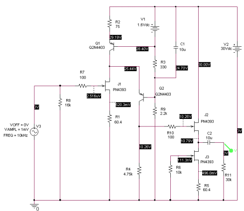

Out of a feeling of needing to look at everything with an unjaundiced eye, I did a simulation of a single ended folded cascode circuit using a resistor at the drain. I took the circuit shown in my previous post, replaced the current source at the drain with a single resistor, and eliminated the voltage source between the base of the cascode transistor and +30V. The output buffer and and all other values remained the same.
I sized the voltage divider on the cascode transistor to provide 5V from the base to +30V, and pegged the resistor at the drain of the input JFET so that the FET had about 8ma of quiescent current and the cascode transistor had about 3ma. This took 360 ohms from the input FET drain to +30V.
Simulation gave some surprising results. The gai for the circuit as I have described it was almost exactly 40. THD was about 0.004% at 10kHz with 1mV drive and 30k load, the bulk being 2nd order, with the other components vanishingly small. It will be interesting if the circuit measures as well as it simulates, though I've had pretty good correlation between the stuff I've been able to measure and my simulation results. I've been running my simulations with a rel tol of 0.0001 and 20nsec time steps.
The one big fly in the ointment is still that the circuit will have poor line rejection, as there is a direct path from 30V down through the cascode transistor to the load resistor. This may not be an issue for people willing to use a really good regulator or a battery supply. I will have to do some thinking to figure out why this circuit measures (or at least, simulates) so much better than the option using a current source. Maybe others can offer some insight.
