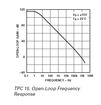

I was so curious to see that someone said he saw the OLG plot of LM4562.
I thought the datasheet was renewed and I downloaded it again.
Sadly, there's nothing new.
Of course, no OLG plot as well.
That plot is what I wanna see first aquired the datasheet and what missing in the datasheet.
I would be glad to see the OLG plot of LM4562 or LME49710.

I found it in an old version of datasheet.
It surely perform not that good for the linearty of maximum OLG.
But just like other good audio OPAMPs, due to it's very high initial OLG, it still has about 75db OLG at 20khz, which is a very good result among existing audio OPAMPs.
BTW, for OLG within audio frequency, OPA637 LT1115 THS4031 all perform well.
