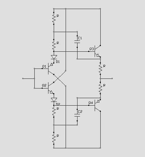

I attach one of our models, for Pre-Amplifier Diamonds
The Secrete trick here (please do not tell anybody!!! )
in this circuit .. and what is my Own Unique idea
are those 2 capacitors ... something like 1.0 - 4.7 Film Cap is enough!
(Depending on load and output level)
They will lower distortion as much as 10-20 dB at higher current outputs!
I am sure you can figure out suitable resistor values
that will fit your needs and your power supply voltages.

Chucko said:I take it the diodes are for biasing Q3-4?
I don't quite understand the function of the capacitors. Are you bootstrapping the output stage bases?
Yes, this is a good old dual bootstrapping.
AKSA and also some other good designers
like amplifierguru Greg SKA Killer Ball
.. I can not recall Nelson Pass does this, but I am sure he does!
and of course Lineup Audio Lab
uses this great technique.
It keep amplifier simple and easy, while improving performance considerably.
you only have to do a Simulation run, to verify this.
The diodes are the usual 1N4148 diodes
which will give like 0.40-0.50V across output Transistor Emitter resistors.
Those resistors are selected to a value
to get your desired Idle current in the Push-Pull stage.
