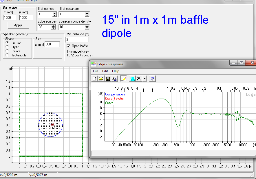

If Xmax is ok - that should be a fine OB driver. It's so easy to try. A test baffle can be made in 30 minutes. __________________
THANKS;
What size baffle would you recommend?
Phil
THANKS;
Phil
For test, just a plain baffle. Maybe double the with and hight of the woofer diameter.
1 meter x 1 meter baffle would be fine. After first test you could add some wings to eliminate some cancelation.
A fairly small plain baffle will do good quite high in frequency, and a large baffle or some kind of open baffle will have better low freq efficiency but will not extend that high in frequency as a small plain baffle.
The min. 2 drivers should be at least 18 inch. A 1 m baffle will work only from 340 Hz upwards.
I'm not sure what you say here. A 1x1 meter baffle will work below 340 Hz, not above. You can use as small a baffle you wish for bass, its just a matter of max SPL and eq.
And the drivers mentioned are 18", but less can do it. I have heard good results with 12" and 15" on very small plain baffles. They didn't work below 40 Hz, but it's ok for normal pop and rock and most other music. Personally it's not enough for me, since I also love deep organ.
