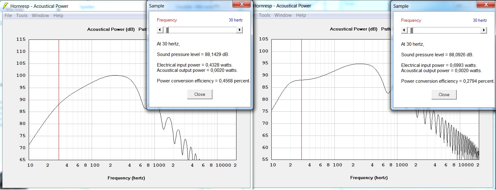

You can not compare one driver at 15 Hz below Fs and another 3 Hz above Fs as the only point of interest. A low Qts, high Bl driver like JBL 2226 and B&C 15NW100 will be much more efficient over Fs and the rest of the usable frequencies.
If i only want to play tones below 30 Hz then i would probably choose several Dipole 18, but if i want to play music i would go with a B&C15NW100 or two.
Already at 30 Hz the B&C 15NW100 (left) has a higher efficiency then the Dipol 15 (right). The efficiency is higher all the way up to 500 Hz or so.
So for pure 20 - 25 Hz tones the Dipol 15 will be a better choice.
For music pro drivers like the B&C 15TBX100, 15NW100 etc works just as well or even better dependent on your taste and economy.
Circlomanen, have you measured distortion of open baffle woofers that you promote? Just comparing simulations and T/S data is not enough. The need for eq (and thus need for Xmax) can be surprising if we want to get 30Hz out at say 95dB at 1m
I am quite certain that a B&C 15NW100 can take 2 watts of power and 3,5 mm cone-displacement without excessive distortion. The cone-displacement is the same for any 15 inch driver trying to reproduce 95 dB at 30 Hz (same baffle).

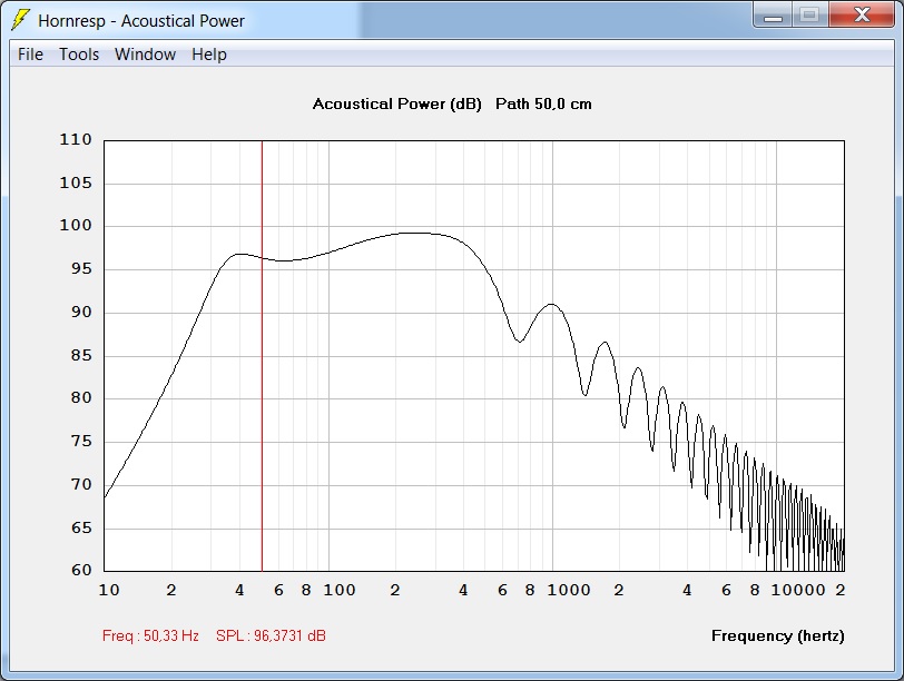

Is the spl-respons from a JBL 2227H in a 10000 cm2 open baffel (sim above) bad in any way?
Why would i not want to listen to it?
Ehh, I think above sim is dipole 15 or?
This is one under to the right is JBL according to your earlier post…...

What I mean to say is that the high efficiency is more or less thrown away in order to have some decent balance between lower bass and lower midrange
1 watt into a JBL 2227H in an 10000 cm2 open baffle (1 pi, combined response with 50 cm path length difference) will give 96,8 dB at 40 Hz. I don´t call 40 Hz "lower midrange" or "midbass". It is bass. Why should this be soo difficult to balance?

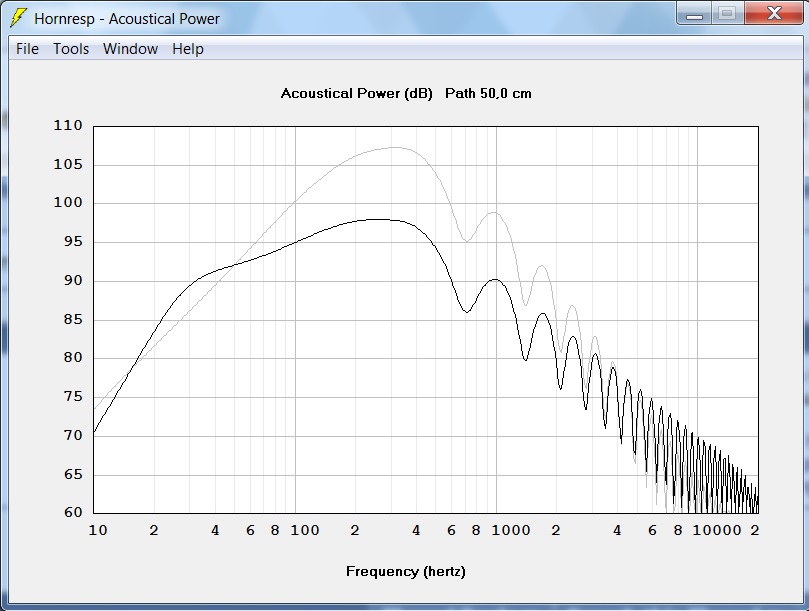

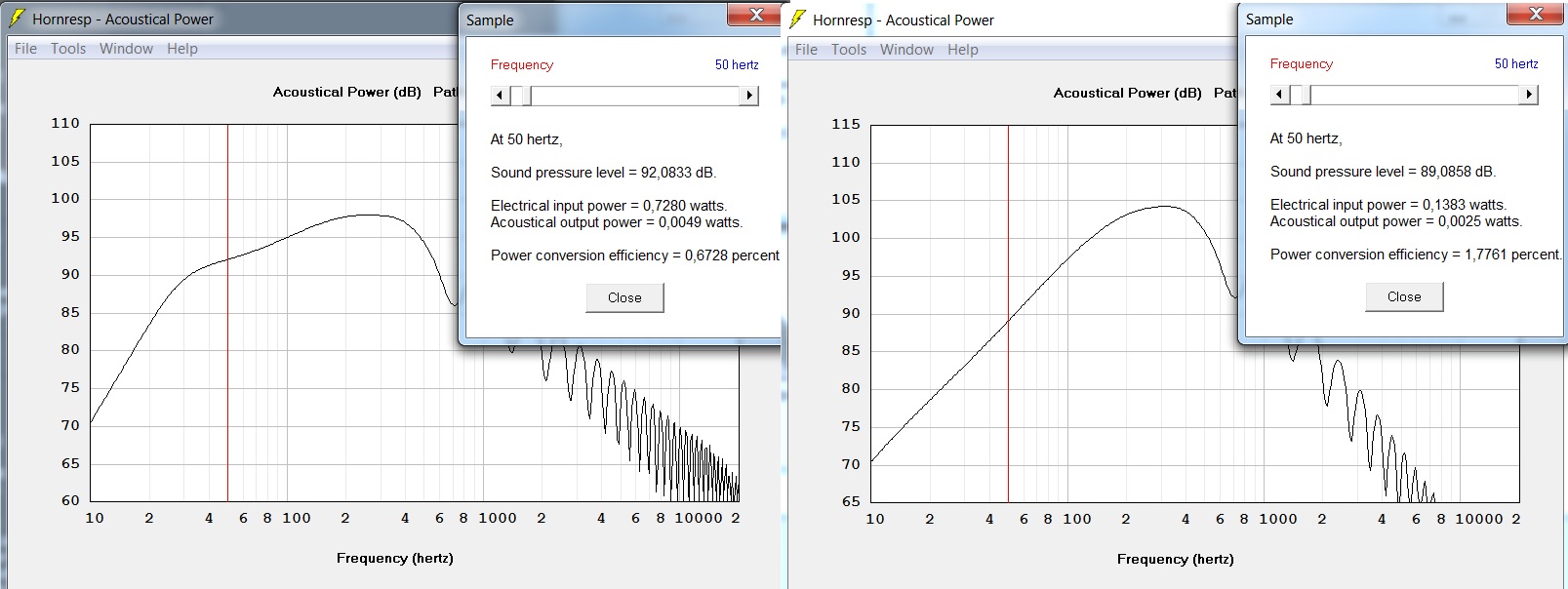

Unfortunately this is just completely wrong. I would suggest not trying to force Hornresp to model an open baffle. Something is clearly not correct. The shape of the rolloff is not even realistic. We are taking the 1st order rolloff of the sealed box and adding the rolloff of an open baffle. Nowhere does this possibly come to the shape you have shown in your graphs. You have something that is showing a high Q rolloff with a bump that simply does not exist. Simple models of the woofers in an infinite baffle show the following in an infinite baffle.
At 30hz the Dipole15 is a full 8dB more efficient. It is not until over 80hz that the B&C has any advantage at all. Response of the B&C is 82.9dB at 30hz before the baffle effect is taken into account.
To get the full idea, we model the baffle itself. The Edge is a good baffle simulator. In this case I used 24" or 609mm wide. The height is 1200mm but really isn't too critical in this case.
The baffle response then looks like this:
We can then export that baffle response and import as acoustic data into bassbox. The result shows both drivers simulated on the baffle

An "8" ohm driver has 100 - 200 ohm impedans near Fs. Please drop 2,83=1w. It does not apply. Since when does Hornresp fail predicting the spl responce from a simple OB? My experience is that Hornresp is very precise.
Can those programs simulate a B&C 15NW100 with 10 or 20 ohm series resistance?

Not every 8ohm driver has a 100-200ohm impedance at Fs. This is a function of the Q of the driver. A low Q driver will have a much taller impedance peak. A higher Q driver has much less of a peak. Look at the impedance model below which will give you better understanding.
Modelling at 1W is actually much more favorable to the B&C woofer. It is not taking into account the additional sensitivity into a lower impedance load. If we compare at 2.83V we can look at both the dual 8ohm with coils in parallel (green), the dual 16ohm with coils in parallel (magenta) and the 15NW100 (lt blue). In no case is the 15NW100 going to ever be more efficient down low than the Dipole15.
The 15NW100 has a compliance of .134mm/N which is the limiting factor on the low end in this case. The compliance of the Dipole15 is .6mm/N, far softer. This is far more significant than the motor strength in this case. In a sealed or vented enclosure, the compliance of the system is dominated by the air spring in the enclosure. The driver compliance has little effect in such an enclosure. In an open baffle there is no air spring so the compliance of the driver itself is the determining factor. Low compliance means the woofer will roll off far sooner as in the case of the B&C. There is simply no case ever where the B&C can be more efficient down low due to the compliance.
Now that you explain you are modelling with series resistance your response curves make more sense. However, all you are doing is killing the efficiency and in turn creating more thermal issues. The Dipole15 is still far more efficient even with this series resistance of 10ohm applied to each driver. It obviously has more effect at pulling down the level of the dual8ohm version than the dual16ohm. In either case, both are still more efficient down low than the B&C. You are somehow still showing far more efficiency than you should. Perhaps showing what you are using for input into Hornresp will help figure out where the error it.
The big issue with series resistance is that adding it causes a significant loss in overall efficiency everywhere. At 30hz there is a drop of 8dB and by 100hz there is a loss of 12.3B with the Dipole15. This is not at all a reasonable trade off. Much more power is required to be applied and much is being wasted in the resistor. In order to realistically do this, a very large resistor bank would need to be made as well. This is one of the situations where there is so much misconception about open baffles. Many recommend doing things that are very counter productive.
