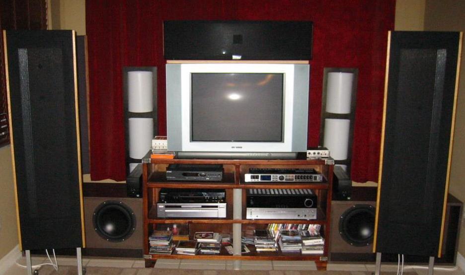

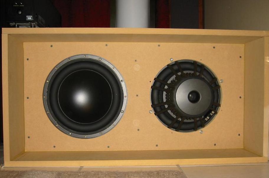

Just a normal "H" baffle. Dimensions are 34" W * 18" H * 16" D.
The woofers seemed like a good gamble at the time. I was considering the Dayton Reference 12" which were the newest thing going back then, but I spotted these on some clearance sale from Crutchfield that was buy one for $100 and get one free! To make the deal even sweeter, they were offereing free shipping on orders over $299, so I got that too! I ended up with 6, thinking of an IB set-up, but that didn't work out so I whipped up the "H" baffles and haven't looked back since.
They turned out to be really great for an open baffle system. Very quite at high excursions, no air chuffing or misc rubbing/flapping sounds and don't require much EQ thanks to the Qts of .5.
