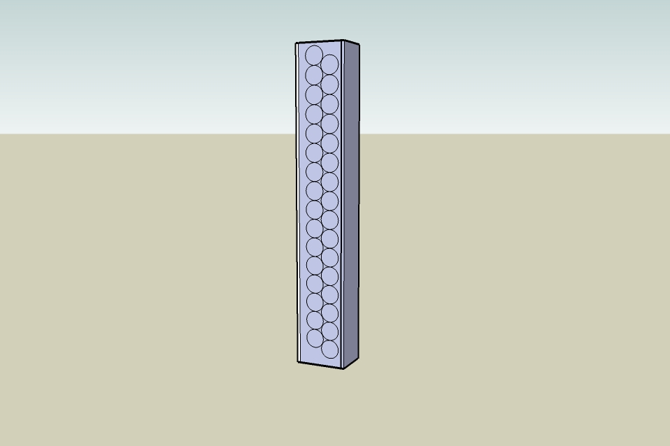

Zobsky, I looked into the Selah Symetrica. The thing I'm trying to get around with what I asked about earlier is the driver spacing Vs. wavelength problem. Steve Slater turned me on to your thread when I asked him about the cheapie Apex tweeters. as it stands now if I by the closeout 5.25" drivers, I pretty much have to roll my crossover in the low to mid 2k range, according to your tests the tweeters roll off pretty steeply at 3k. My hope was to not imitate the JBL style like Selah, but to double up the woofer line with a 1/2 offset to try and raise the level that comb lining begins. I whipped up a sketchup drawing only to illustrate what I'm thinking of.
If the Two lines will act as a point source, then I have reduced my spacing from 5.25" to 2.625"

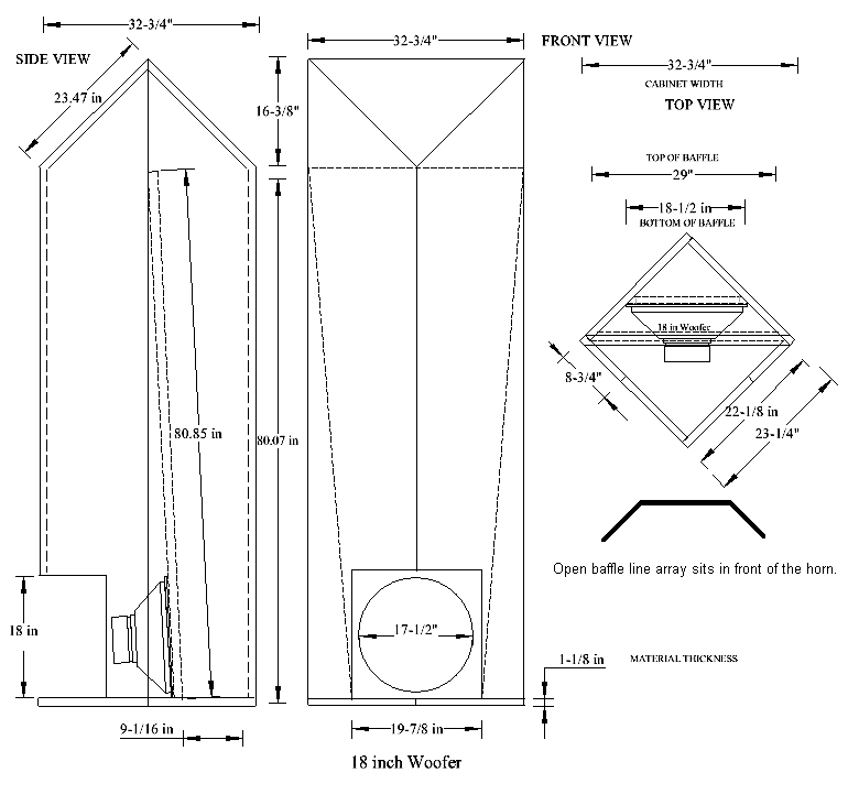

Great drawing! Do it. 🙂
With regards to OB in your work space, I've been hammering out an idea that may be of interest:
The 18" tapped horn is about 36 inches on the diagonal. I'm going to set the line array above the tapped horn's port and let the rear radiation from the array reflect against the horn. It should bounce to the adjacent walls and back towards the front of the baffle. I can adjust my wings forward if required.
mightym said:If the Two lines will act as a point source, then I have reduced my spacing from 5.25" to 2.625"
Disclaimer: I don't really know nothin about nothin. This is just some stuff I made up that sounds like it might be true.
I'm guessing that the two lines will only act like a single line up as far as... the line of individual drivers acts like the initial line. That is to say, only to 5.25" wavelength (~2.5 khz sez MM). The same logic that dictates when the individuals act as a line will dictate if the two lines act as one. Above that, you'll start inducing an interference pattern in the horizontal plane. But what do I know?

Well, I've been saved from a lot of work and disappointment.
I was still wondering about the effects of adding a second line of woofers, only offset vertically 1/2 Dia. and whether this would sum to the line source or not.
I wasn't willing to experiment without at least some confidence that it would work.
I sought out someone who builds, and sells Line arrays. When I put the question to him, his response was short and to the point, I would only be adding another line of drivers which would add more lobing issues.
So, I now need to find another Tweeter that can be effectively crossed in at 2.5K or less, or reduce woofer diameter.
I hope that this does not discourage anyone, it didn't me. Just need to back up and re think the problem.

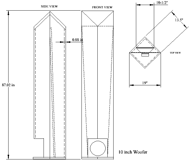

Carpenter, do you have the model nomenclature for the driver used in your bass horn?
IIRC you said it was a Mach 5 18"?
I wanted to plug your horn into Hornresp and play with it, try to scale it down to a 10-12" driver.
John
BTW in your illustration your show the Line Array placed in front of the bass horn, but with the wings apparently facing forward? am I misinterpreting the diagram?
John
There are a few details you may want to know--feel free to ask.
Yes, the 18" driver is a Mach 5 unit.
carpenter said:There are a few details you may want to know--feel free to ask.
The IXL 18?
