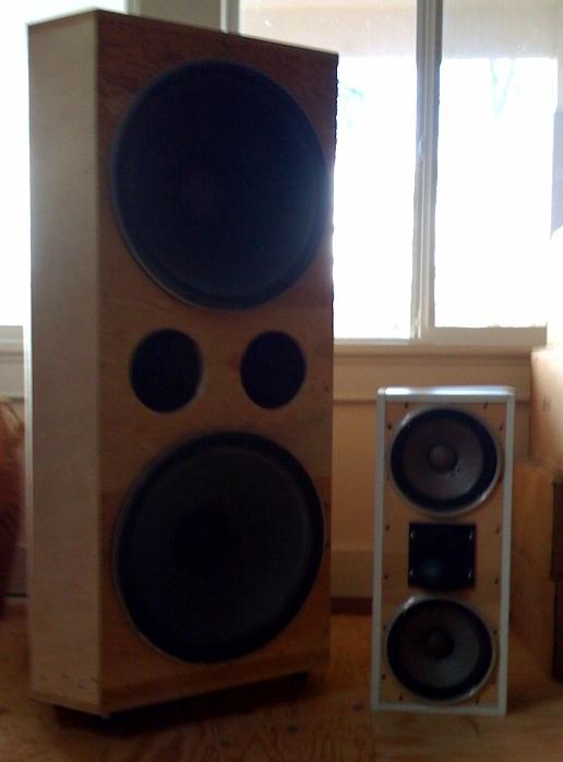

neat, looks similar to the jbl dual 8" plus baby cheek except that's an mtm. Those tweeters are super stupid expensive (2404). Just saw a new pair for sale for $900 on http://www.canuckaudiomart.com/details/105257-jbl_2404h_babycheek_tweeters__new/
even used I think they run $500.
I just say an add on craig's list for $75 each (probably needing new diaphrams).
Yea, I like 15's.
The bass feels right compared to 1 or 2 12's even at low volume.
I remember hearing the sunfire 8" sub.
Yea it goes deep, but hey, it only an 8".
It didn't move the air very well.
It's not a db thing, more of an air pressure.
But that is the whole pressure wave versus velocity wave of sound (a huge can of worms).
Like a w-bin bass horn I had, no bass, till you got about 15 feet away, or you got pounded down the hallway.
Yea, we have a diy crowd here near Iowa city, but you need a dense population to offset $$$. Diy is typically low cost until people are willing to pay 5 times the price for a driver to get that 10% improvement in sound quality. Or the guy does woodwork and would rather build something than pay full retail.
I can't even get the 2 people who are into the stuff at work to come over to hear my setup (that sometimes changes weekly).
The diyIowa is neat but I don't need to hear another cone and dome 6.5" 2 way. But some drivers work well.
I'm just lucky I have a smart audio friend (ex pa) but I play with full range stuff that doesn't interest him. He had his own 24db LR crossovers for big pa's and car audio (using klipschorn parts) in vehicles b4 there was the stuff. I'm a "transparancy guy" wanting minimal components in the audio path from amp to speaker.
We diyers are a small slice of audio, and even then we split apart over what we all feel is important.
There are many roads to audio nirvana.
Norman

I had no idea the 2404s were so valuable. I'll have to treat mine with extra care.
The MTM is actually a center channel sitting on end (sorry for the misleading photo). It's loaded with 2118s.
The bass reflex cab is loaded with 2240s. They're great for low wattage amplifiers.
Dual bass and midrange SPL 100db 1W1M. Still gets trounced by the horn, though. But, then again, my hearing's weak on the top end, so I like the added brilliance.

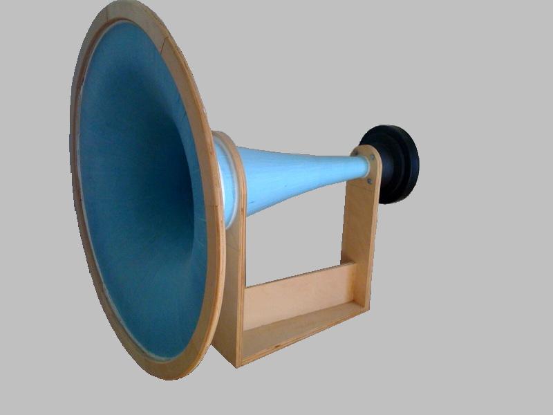

Here's a pic of the paper-mache horns I have in my primary system. They're 33" tractrix loaded with a JBL 2445:

neat stuff.
I've played with the jbl 2447 on the as2222 (cross 24db at 1.2khz).
I got an altec 291-16a that works well on a mcm bowtie horn crossed at 1khz.
I also heard my 291 on an ev hr90 horn.
I've also played with dh1a on ev hp 940 and hp640 horns.
Neat horn.
I was looking at the shperical tractrix on ebay.
Any parallel surfaces in horns = bad.
Glare or zing, whatever it is, something that's not right.
That little jbl horn of yours is probably 107db 1w/1m.
The replacement diaphram is probably $100 not including installation.
Norman
