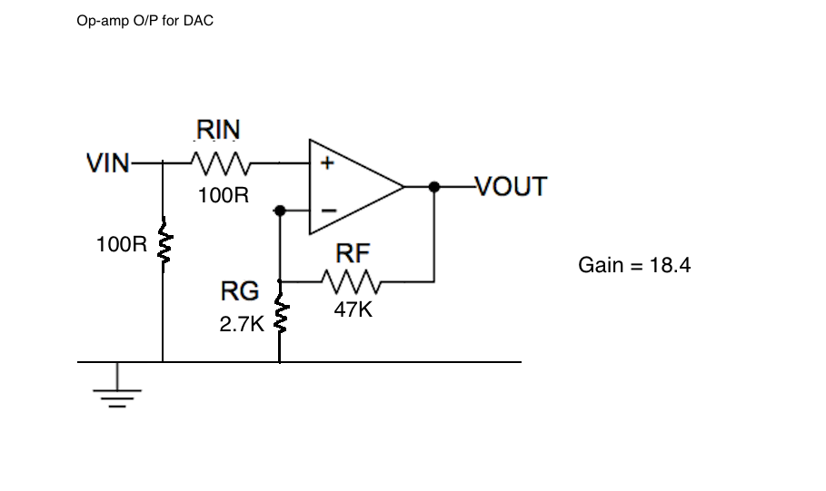

How is used the op amp in the V-DAC ? Do we talk of transimpedance I/V use, or post filter, or buffer, or, ? Characteristic needed can make one op to sound good here and bad elswhere as said already above.
According the circuitry, all those op amps ratings are useless, but the one of the op (pune intented) cause rolled in his system setup.
And anyway, according the shematic, you can't rank op amps like that cause some values are fixed (Cap and resistto feedback, etc)
There are ic dac that spread current needing more or less strong I/V, some others voltage, some needs differential op amp or shematic at their output.
For instance the AD8066 can be good sometimes or can be too thin sounding according the layout, setup, dac ic, decoupling cap choice, etc !
Also, often whatever the final choice, you may needs a work on lythic caps decoupling or DC blocker's to have the best of the few you choose at the end for the task.

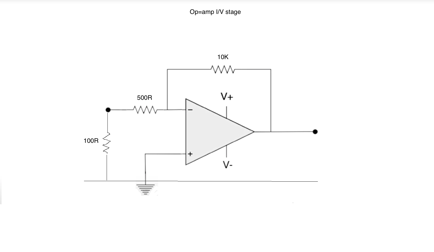

if ad1865 has an output voltage with internal op amp, you can use the non inverted input.
But if using pcm56 (current output) and the current output of the AD1865 (better), you must use the inverted input.
Reading the datasheets of such dac ic is instructive.
if we forget the values of the Resistors, yes. The I/V R is the 10K in your shematic. And it needs alas some filtering too.
It is not just about calculating the gain alas.

And this should interrest you then for the special subject of op amp used to convert current to voltage using a "virtual" ground : https://www.by-rutgers.nl/IV-converter.html
The idea is you don't need anymore to use a little value for the R like when used direct then a valve after. Advantage : a way larger flat impedance and bandwidth, which is important here (DAC coutput). The value of the R has less importance noise wise.
