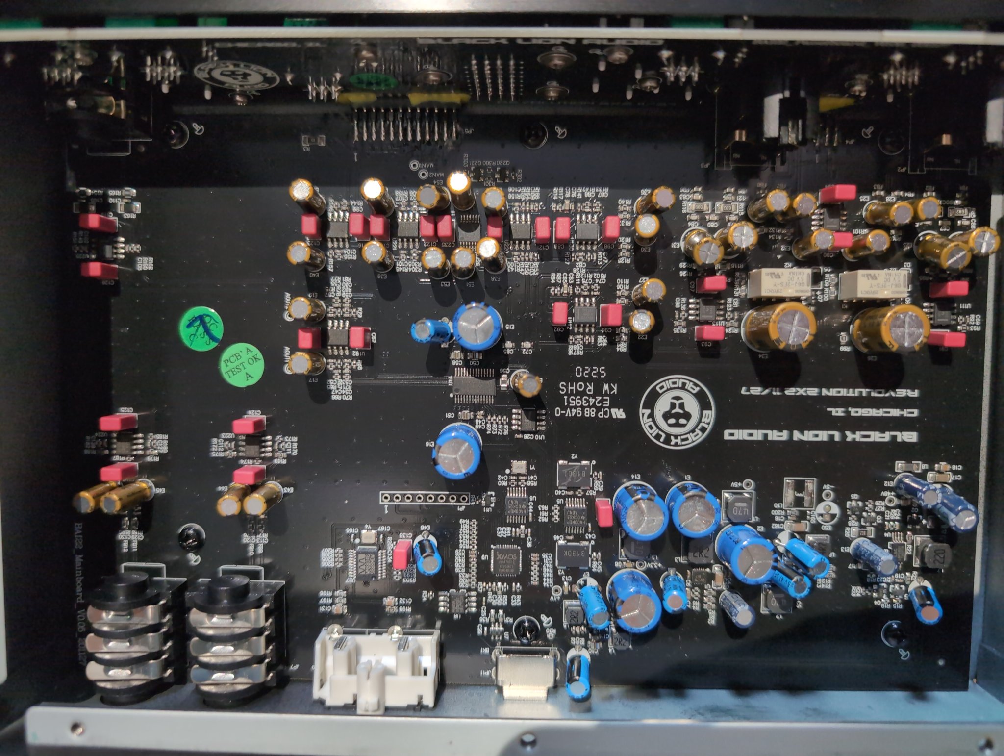

OPA2810 (headphone amp)
AD8512 (line outs and mic inputs)
OPA1656 (mic inputs)
all three are in my Black Lion Audio Revolution 2x2 Interface
imo from sonics the AD8512 on the line outs is definitely worth a shot, its a very simple output stage just containing one dual opamp per channel,
also the OPA2810 as headphone driver doesnt seem bad
i just looked into the device again to document it here, i havent A/B compared these opamps (beside the OPA1656) as they are soldered SOIC8

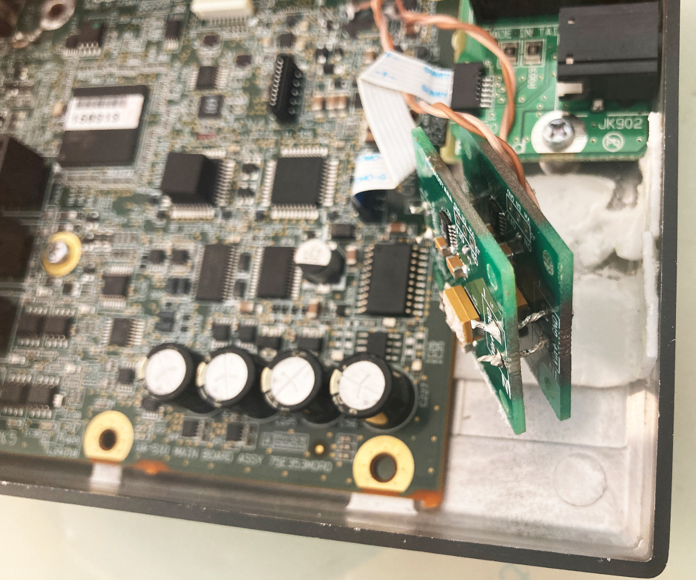

This is my Roland Super UA-S10, which I use exclusively as a DAC and headphone amp. It has a great sound! I replaced the original SOIC8 NE5532 (TPA6120A2 driver) with my favourite AD8066. Working with SOIC8 is a bit of a hassle, but it is not a major issue by any means.
The outboard power supply is my low-noise linear power supply; I also placed the 2 x {1LT3045 - 1A} LDOVR regulators (connected in parallel) inside the unit... that's supposedly good for 2A. A fantastic overall improvement.
