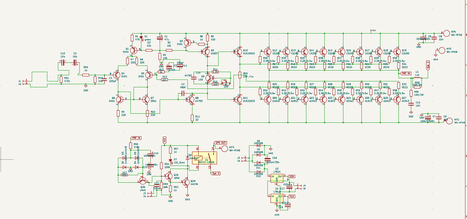

I have done making a 1000w rms amp which is giving 1060w rms at 2 ohm load before clipping . I am planning a startup and for that I need high quality and strong amplifiers , as I have made a 1000w rms amp with >1% distortion and soft start - cooling-dc protection - thermal protection . Now I want to make a 2kw at 4ohm ,,,, then I will go for 4kw or 5kw at 4ohm load (obvoiusly class H or Class D).

Yes I am familiar with amp making but its limited to class AB .
this is the schematic of my high power Class AB amp

this is the schematic of my high power Class AB amp View attachment 1438300
One way to to it.
For more power, more voltage would be used.
As noted, the challenge is moving from to 180 volt transistors to 300 volt transistors.
So what is available with decent specs changes. Is the challenge
It is not being sold or marketed as a commercial unit. Just personal use.
So for personal use it is not being used or abused in un known manners.
As a commercial unit there would be numerous issue. No need to nit pick.
For personal use the lack of many protection circuits and clipping recovery is less a issue.
Just cranking up voltage by itself gets a little ridiculous. The current draw gets astronomical. And you have to do SOMETHING about second breakdown. Cascoding works but it has stability issues to work through and does nothing about heat and current draw. But with emitter follower outputs, it really IS just a matter of adding rail commutators to the existing circuit to go class H. That is, assuming a full complementary output which is no big deal these days. I do favor using op amp input stages as it eliminates the need for a 300 volt input stage, but a Blameless works just fine. Cascoding the input stage is another option, but may not offer the user as much protection as the op amp option if the input stage gets shorted. Eventually you need to go to EF3 outputs, but hell I do THAT starting at 40 watts because I think it sounds better, especially if under biased. You just run out of Hfe and want MORE with 40+ amp output currents. I prefer to run my VAS’s at 10 mA or less. Second breakdown starts kicking in at 20-30 mA at 300V on the types that get used there. The idle HAS to be lower to allow current swing.
There are 10,000 things to nit pick over, but you can start doing that at 10 watts. No need to go to high power for all that to kick in. As powers go up, the need for output and internal protection goes up because the result of accident or internal fault can be more deadly. Even a momentary VAS overload has to be addressed - not just to make to clipping waveform look pretty but to prevent blowing the MJE15034/5 pair and everything that follows it. On a 15 watt amp, you don’t even need DC protection. Sending full 20V rail voltage to a 1.5” VC on an 6 or 8 inch woofer won’t burn it up before you can get to the off switch. Even a 18SW115 won’t take 130VDC very long, and in a large system you may not even notice one woofer out in the array right away.
