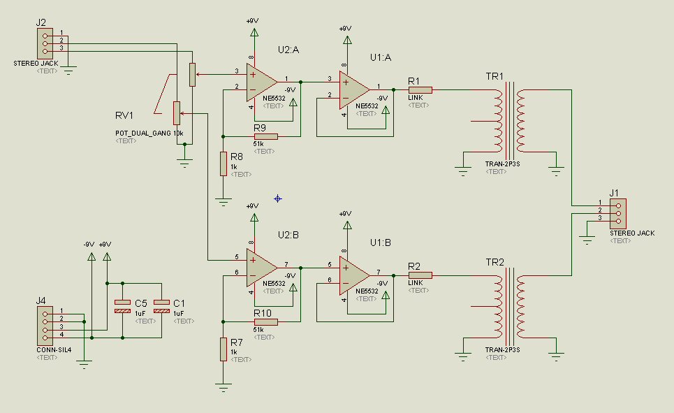

What I do have is a quirky curiosity and time on my hands at the moment. I’ve seen a few questions from people building headphone amps and I’ve noticed that the simple designs are quite hard to predict in terms of output power.
It was while trying to try to answer such a question I realized that some opamps would deliver a higher power into higher impedances than those presented by typical headphones.
I’ve often looked at those little audio transformers (Eagle LT700 and LT44) available from Maplins, and wondered what I could usefully do with them. We’ve got a Maplins locally, so it wasn’t long before I made a trip down there and picked up a pair of LT700s, a couple of NE5532s, a dual-gang 10k log pot and two miniature stereo jacks. I usually have resistors and caps sufficient for most purposes.

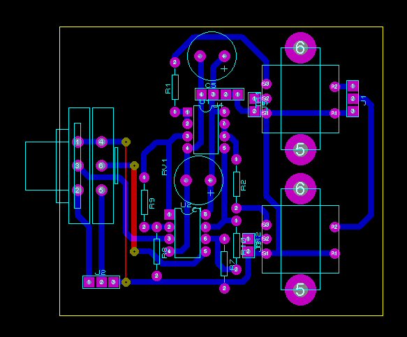

Next thing was to knock up a schematic.

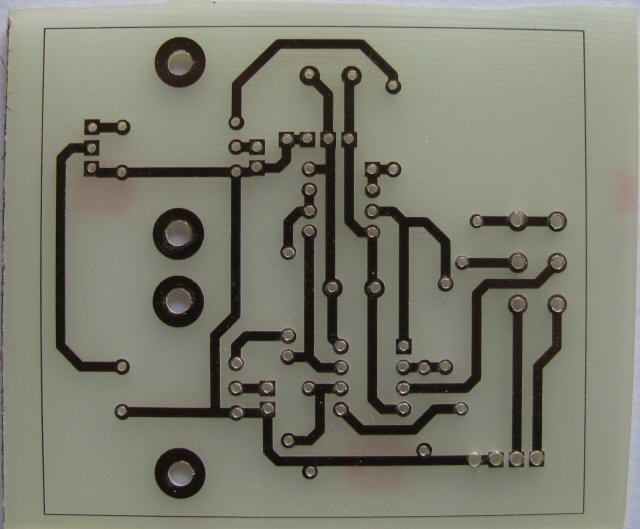

Then a layout.
w
Then etch and drill a PCB.

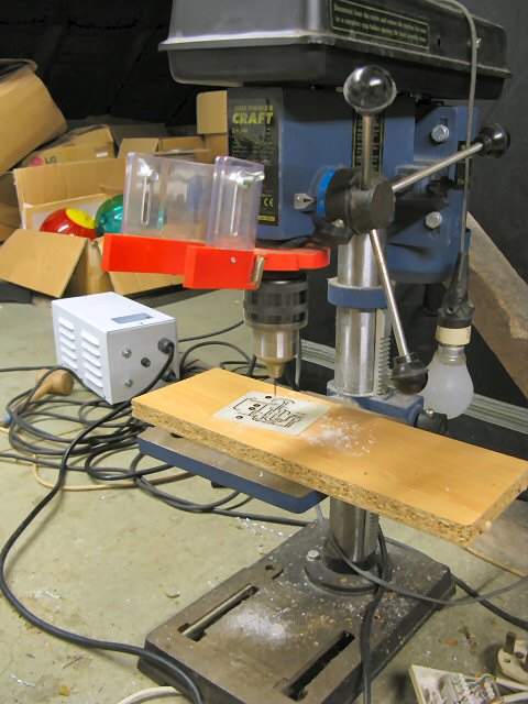

I thought you might be interested to see the drill press I drill the PCBs with. It breaks the tungsten carbide bits for a pastime, but it’s fine with high speed steel (HSS) bits.
Then populate the board (stuff it).

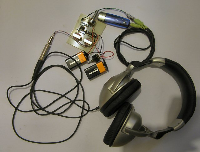

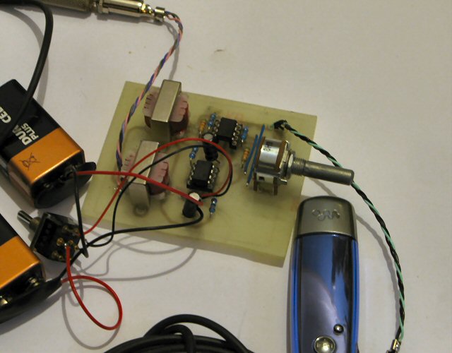

And connect up something to test it.
I’ve got a Sony NW-E003 player, it uses some kind of Sony compression, they’re notorious for poor output volume, so I connected up that, and tried a pair of Behringer studio phones which have a nominal impedance of 64 ohms and a pair of Shure E2c in-ear phones with an impedance of 16 ohms. Neither of these are an ideal match to the LT700s which are 1200ct:3.2 ohms but I wasn’t going to let that put me off.
The design departed from the usual CMoy in that it has dual 9 V batteries, I don’t like the virtual earth used there, I wasn’t aiming for absolute minimalism or miniaturization. I started with a gain of 5, but this gave me an output roughly the same as the input. Raising this to 11 and then to ~23 gave much more satisfactory results, eventually I pushed it up to 50 without any sign of clipping. The Sony must be really quiet and there must be quite a lot of loss in the transformer, but by this time the volume was such that using the Shure E2c earbuds for the duration of the Beatles’ Abbey Road album has left me with a slight ringing in my ears, so it’s probably quite enough to risk ear damage if used for long periods at this level. The transformer presents an impedance of ~7500 ohms with the secondary open circuit, the best power output is probably obtained with a 4 ohm load.

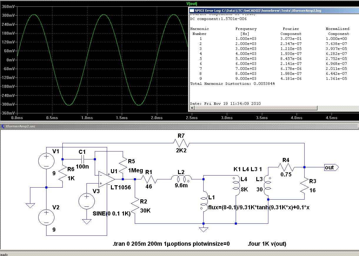

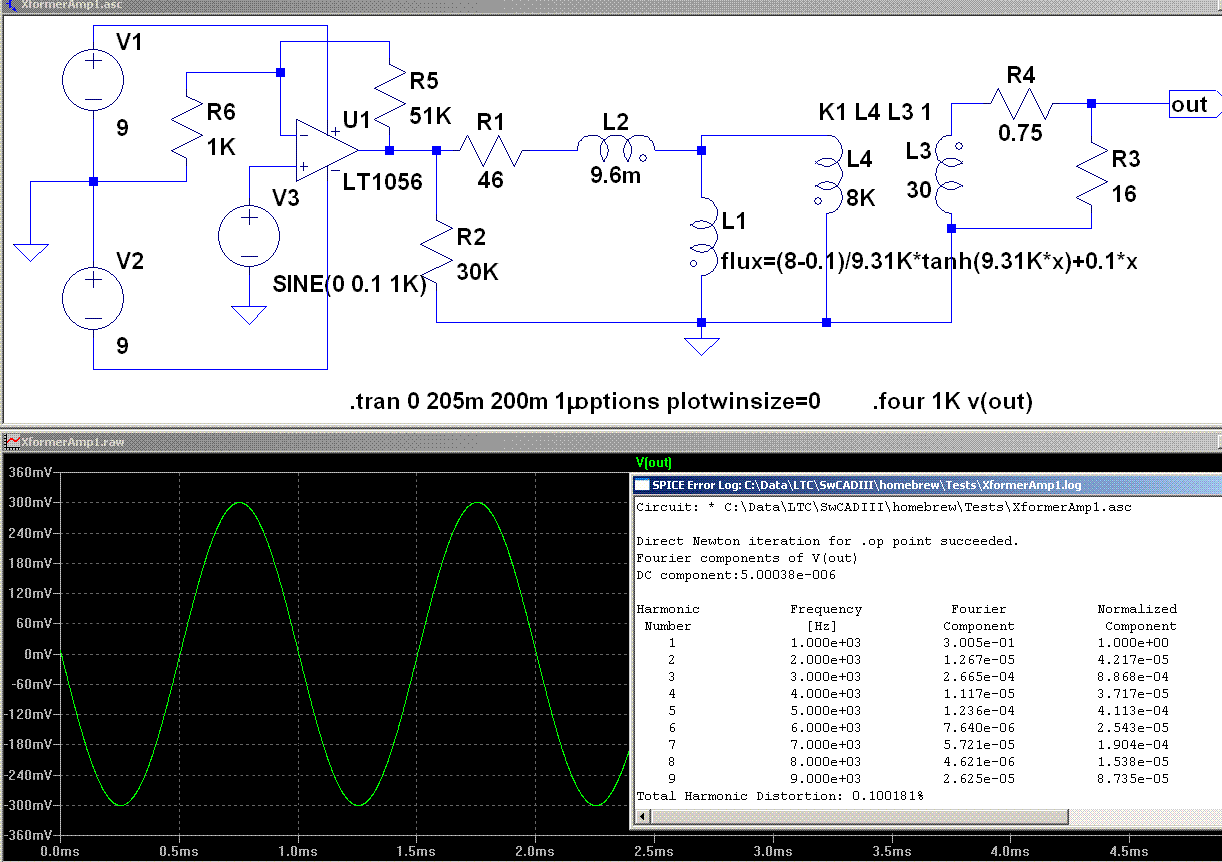

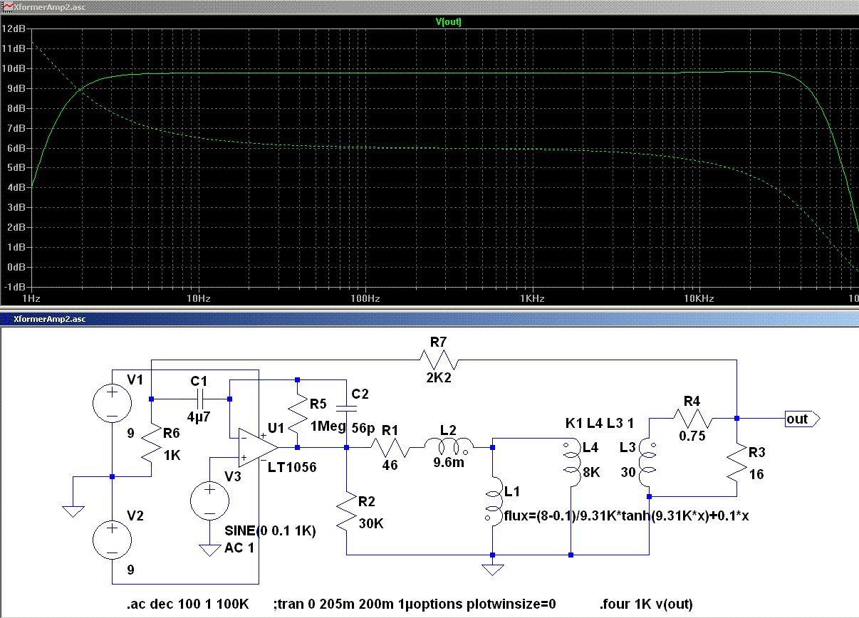

I would suggest a slight improvement: by taking the bulk of the FB after the transformer, the distortions generated by the transformer can be substantially reduced, see examples.
Stability doesnt seem to be an issue, even though the transformer's parameters are extracted from a real model.
A small additional capacitor in parallel with R5 might be needed.

Correction: C1 has to be larger than expected, due to the transformer's ratio.
A compensation capacitors has also been added. Without it, the response shows a small (~2dB) peak @70KHz.

Thanks, guys. The suggestion about taking the feedback from after the transformer is good, it never occurred to me at the time and I certainly never undertook any simulations. That's quite an improvement in THD.
As to building 'dead bug' style, this is an option I was aware of, I've built a few RF amps like this, but I don't anticipate building any more headphone amps in the near future, I didn't really have any need for even one, the place is coming down with amplifiers, mixers etc. My preferred technique is regular surface mount, I have quite a lot of SMT components on hand, and there's no drilling unless for vias for doublesided.
I've been looking at those tx's in the Maplin inventory for years with a vague inclination to tinker around with them. I'm not big on absolute performance in audio, last time I checked I didn't hear much at all over 15~16k, but I was pleased to discover a perfectly satisfactory bass. The source is anyway some kind of proprietary Sony 'MP3'.
Truth be told, the performance with many phones would probably be no worse and likely better taken at the output of the unity gain buffer. There's probably ~6dB loss in the tx @ 16 ohms with the input impedance up to 3k3.
