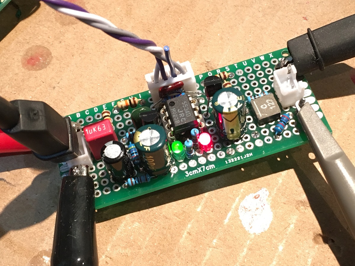

So I've got the opamps (had to make DIP adaptors, only SMT 5534A's in stock ATM, and needed a bit more capacitance to stabilize once the output devices were in the loop(s).
The output devices are the double-die Exicon lateral FETs, ECW20N20/20P20, which I had in stock - thought it would be good to test maximum load for the opamp.
So some testing at moderate power into 8 ohms (I have a current limiting +/-45V supply with max 0.5A output).
Interestingly there is more 2nd harmonic than 3rd, at about -97dB. Without the output devices the 2nd drops below the 3rd, suggesting the output devices aren't well matched(*), or that my biasing arrangement isn't great - its needs a bit of a rethink anyway as an open wiper in the bias pot increases the bias currently.
Happy it basically works.
(*) I don't try to fix the gate capacitance mismatch between p and n devices ATM.

I still need to work up to higher power testing and checkout the clipping behaviour etc, and figure out if any protection circuit is needed.
I'm also in two minds about whether the tripler opamp should just have local feedback or be part of nested loops - I can see arguments both ways.
Been listening to it through a real speaker today for the first time, monitoring with a 'scope for any RF nasties. Sounds excellent of course, though I run underbiased to keep the small heatsink at a reasonable temp. Thermal camera says about 50C max on the board, and output devices are running about the same.

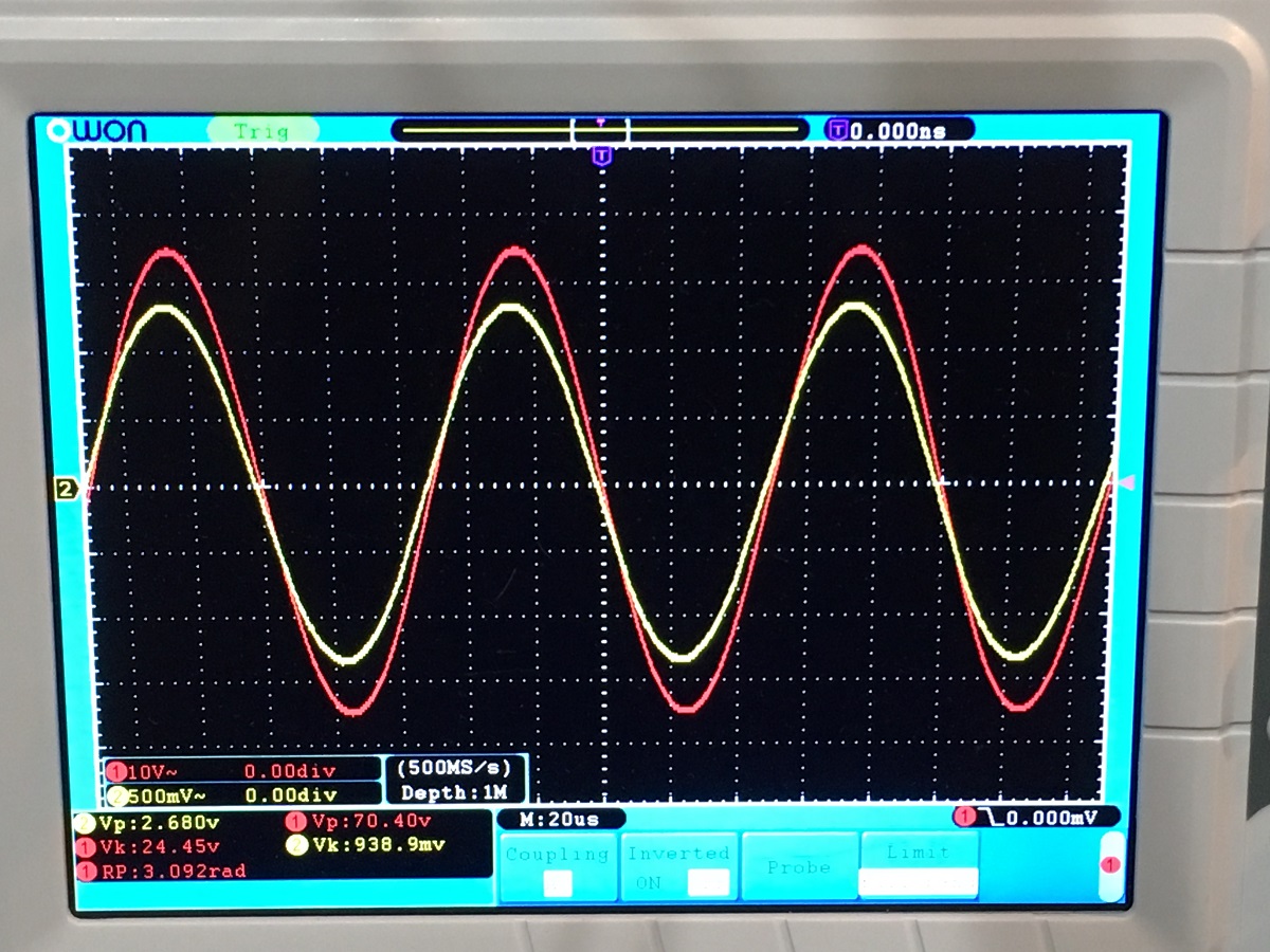

Have you considered bootstrapped opamps? I got 70Vpp with addition of $1 worth of parts to a 5532.
Surjan Dogran's Easy Peasy 70v peak-peak Opamp for $1
Jan Didden suggested that with addition of two zener diodes, the output swing cound be doubled to 140Vpp.
70Vpp (red trace):
70Vpp (red trace):
