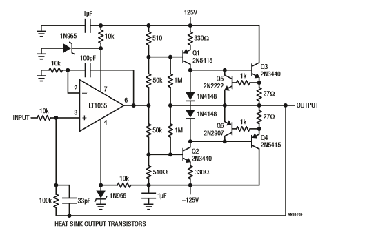

Thread Surjan Dogran's Easy Peasy 70v peak-peak Opamp for $1 and
EDN May 13, 1999 https://m.eet.com/media/1152270/24127-45890.pdf

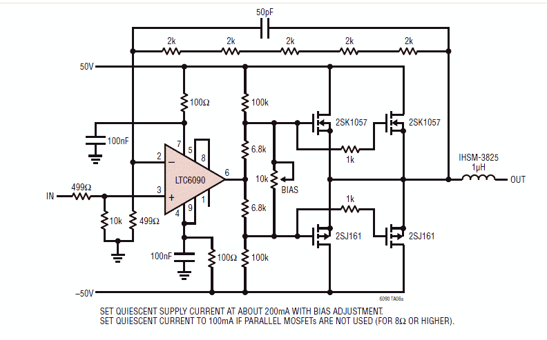

The TLC6090 is +/-70V with about 10mA drive https://www.analog.com/media/en/technical-documentation/data-sheets/6090fe.pdf
One application in there is for LatFets on p21 (attached).
Maybe the TLC6090 can also be stacked like your circuit for +/-100V ...
BTW Floating bridge is by Brady, Wireless World, Sep 1980 and Oct 1980.

Hmm, that transistor circuit rather finesses the problem! Oh well.
[ edit: Ah, not quite, its still limited to a x2 gain for max swing as one opamp input is tied to ground, in fact it will burn the opamp if over driven, the non-inverting input needs protection. For greater than x2 swing I think the transistor approach can be stacked, but is limited in gain in the same way - the opamp approach keeps all the voltages better controlled which matters for stacking. ]
I've realized the transistor bootstrapping circuit of Surjan Dogran's can go up to a tripling of output voltage swing if the gain is set to 3, non-inverting. This version uses 50V rails, runs an opamp at +/-18V (limited by a zener for protection) and has the bootstrapping split into a DC and AC path to allow the bootstrap factor to set optimally even though the rail voltage isn't 3 times 18V.

This circuit could drive a similar circuit using the LTC6090 to triple the swing again (LTC6090 swing is 140V), so upto 270V swing would be possible.
