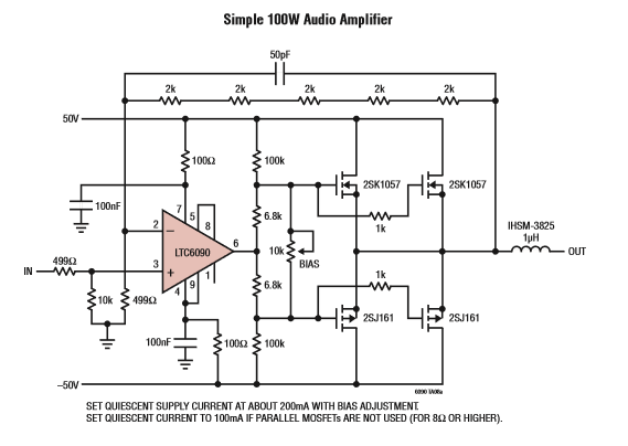

The schematic below ?
Good question . I would use the LT0690 since I'm not big on slew rate
and go for all the intrinsic stability available .
You would have to try it and see .
Isn't the gate resistors arrangement a bit unusual for paralleled output mosfets in this schematics?
I would have a 1k at the gate of each output .
AND
Use leds for bias .
Indeed. Might have been a rush job. MOSFET driving impedance looks a bit high in general.Isn't the gate resistors arrangement a bit unusual for paralleled output mosfets in this schematics?
Doesn't take much to drive lateral FETs (as opposed to vertical types)Indeed. Might have been a rush job. MOSFET driving impedance looks a bit high in general.
See AN-1645 Application Note from TI http://www.ti.com/lit/an/snaa045a/snaa045a.pdf

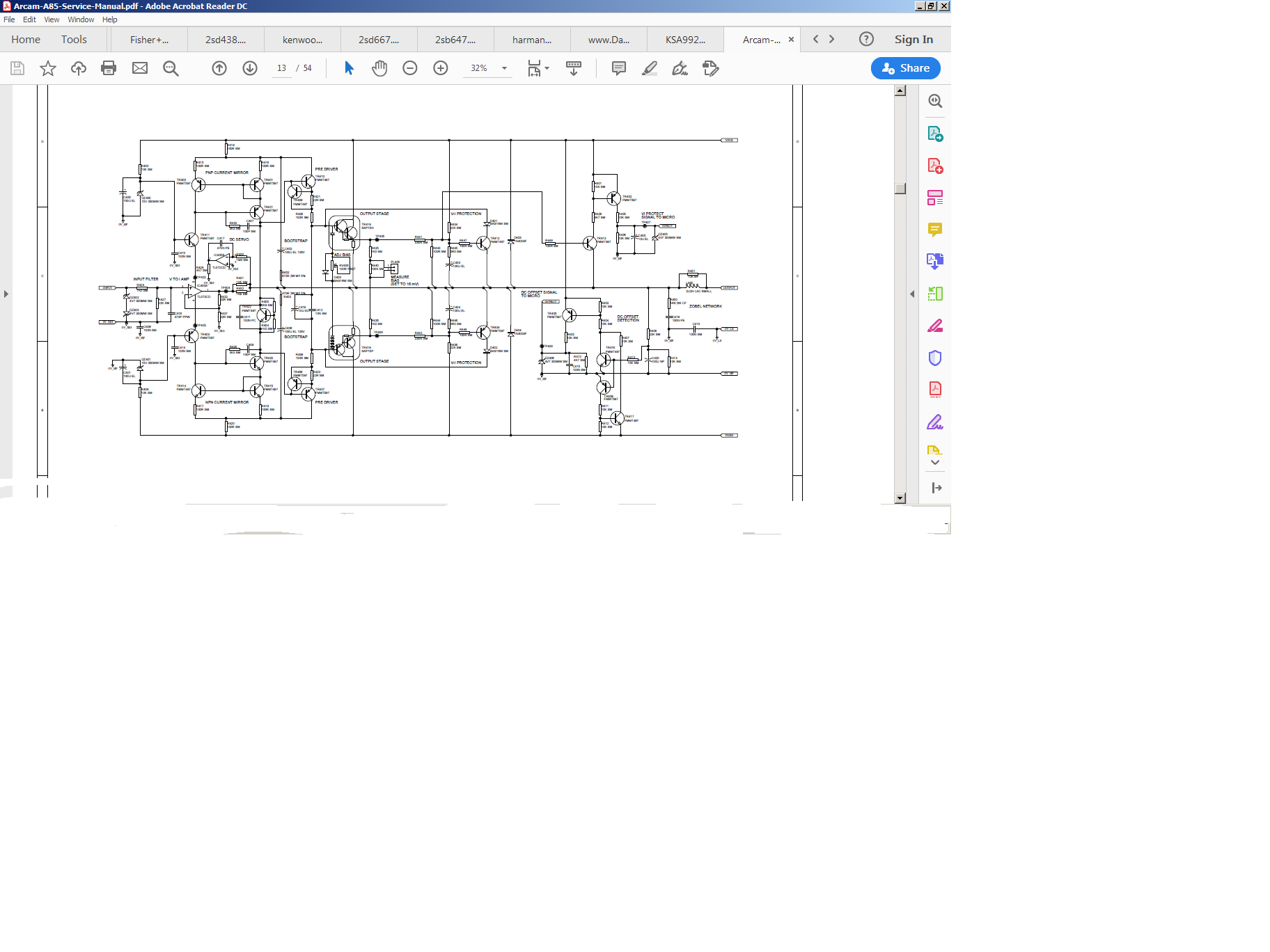

I can make your life easier -- I still have a tube of LM4702.

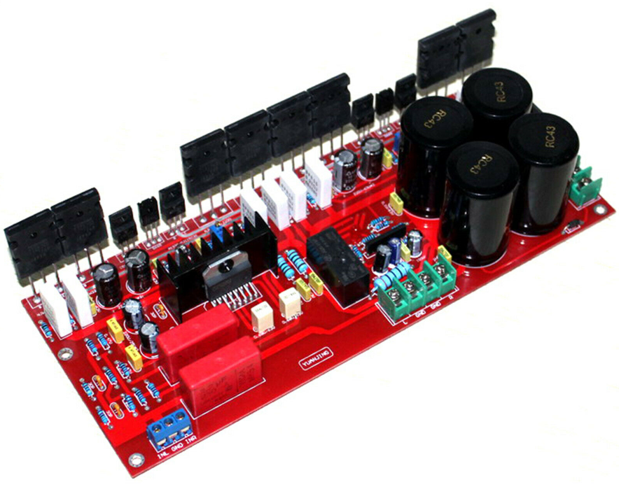

As in the middle of this board ?
The IRF/Vishay MOSFETs need extra drive capability, lateral mosfets not so much.
