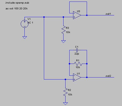

I quickly drew it in LTSpice and it showed the same response, at least within the audioband.
When I get home, I can post a picture.
I use a series resistor in the connection between output and -ve in. Not just for distortion reduction but also for improved DC offset - so the input bias currents give rise to the same voltage at each. I put around 100pF in parallel with this resistor so the input capacitance doesn't degrade the phase margin.

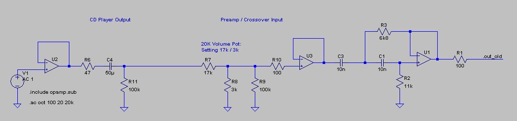

Is it like this?

Is it like this?
You have drawn your signal source as an ideal voltage source, which means that the + input is driven from a zero impedance. If there is a DC blocking capacitor somewhere between the source and the buffer that you haven't drawn, then you have matched the impedances at DC, but mismatched them at signal frequencies where the DC blocking capacitor is basically a short.
Matching the impedances at DC only makes sense when the bias currents are big enough to worry about. Are they?

Here is a simplified drawing, ignoring the cable and the input RF shunt capacitor network. This is a simplified tweeter circuit I am building.
With volume pot, the impedance varies, and 17k / 3k is the normal position. I know I can not get it 100%, but I am trying to get the impedance as close as possible under normal (17/3) condition.
As for the Sallen Key, not, I don't know how to match the + /- impedance.
What you said makes good sense. It appears that I can get a few mV DC offset with LM4562, but at most 0.5mV with opa627, because the opa627 has a lower bias current.
For filter application, I can not see any possibility to match the + / - input impedance at AC. Getting them closer may be possible, but matching seems impossible.
With your tips on impedance matching, I have now come up with this Sallen Key implementation, with + / - input impedance matched, both at DC and AC.
Is it the way you would do the impedance matching?
With less than 5pA input bias current of the opa627, is it worthwhile?
Without the impedance matching, I found 0mV - 0.2mV DC offset with opa627. This DC offset is not a concern. I am more concerned if distortion is increased with AC signals.

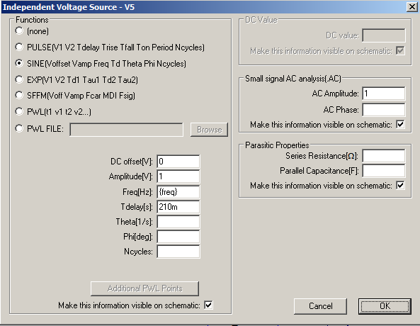

Hi Bill, You could run a transient analysis on the circuit and do an fft to see what the effects on distortion are. Note that the distortion results will more than likely be better than real world, possibly by a large margin, but it will at least give you an idea whether it increases or decreases distortion.
I just lifted this out of my sim for my active crossover:
.tran 0 320m 220m 0.1u startup
.options plotwinsize=0
.param Freq=1000
.four {Freq} V(.out_standard_implementation)
.four {Freq} V(.out_matched_impedance)
.options ptrantau=1e-8 #I can't remember what that one does, but think it has to do with finding the dc operating point.
set your ac1 as per the attachment. change the param Freq=1000 to test the distortion at different frequencies.
You will need to comment out your .ac line. stick a ; on the front :)
It will take a while (I found running for 320ms helps a lot with getting a clean result, you can try less if you want to speed it up.
When the sim has finished go to view spice error log and you will have the distortion analysis for each. right click on the waveform window and choose fft to do the fft plot.
I hope you didn't already know all this ;)
edit: also to ensure more real world results make sure you put in some reasonable values for your caps ESR and ESL. for small film caps you could use say 16 ohms for Equiv Series Resistance and 6n for equiv series inductance.
Tony.
