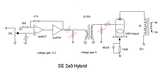

Anyway, based on his design, this is what I have in mind. To be frank, I have good experience with opa627 and several opamps before this, and I feel they should be given a chance to drive tubes directly.
But this design has limitation to the quality of the interstage trans.

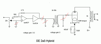

I am not sure what to do with the items marked in red. Can I just take them out?

You can omit all the items in red. However 2a3 grid stopper may be nessecary. But i never found a need for them in my 2a3 n 300b amps
Regarding the question about the capacitance. I am not sure until i wind the trans and work it out. What you should be more worried is the capacitance on the secondary reflected. That could cause some distress to the opamp if iit is not loaded with enough current. However i recommend to use 15ma for the opamp and you are home free. Considering you are using buffer stage, your current drive is high with lower output impedance
Therefore driving the 2k trans should be not a problem

Leave the grid stopper there ( close to the grid ) and the input resistor to ground will only be useful if you plan to remove the trafo for any reason and leave the grid open.
The resistor from plus input terminal of the input stage to ground is useful . While operating the volume pot , if any small discontinuity occurs, the output dc will change causing scratch noises at the least. With high quality pots this problem will be minimal. You could avoid that resistor - one component less that might color the sound !
I'm not sure about the resistors at the output of the BUF634. The resistor in series and shunt with the transformer will surely have some affect on frequency response but that depends on the circuit following that and the behaviour of the transformer.
If you have some recommended values with a specified transformer , go ahead and use it.

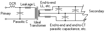

burnedfingers said:So umm...are you even the slightest bit aware what an interstage transformer does to an electric signal?? Anyone??...
Tim, please tell us won't you?
See attached.
It gets uglier the more precise you want it.
Who knows what the complex combination is on for example a multiwinding one (CT'd or multisection primary or secondary). I know for example Hept'AU7's has a 90 degree end-to-end phase shift at some frequency, I forget what (10 or 30kHz maybe?).
Tim

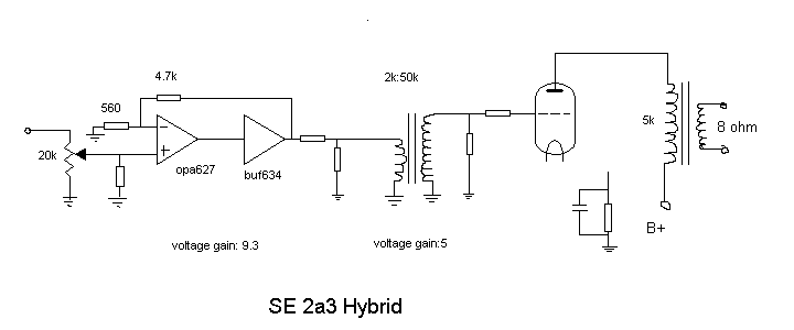

skyraider said:What I have in mind is something like this:
I'm running a (PP version of something like this right now using an AD815/AD823 hybrid to drive it. The cheap EDCOR interstage is probably the biggest limitation.
I never did like the idea when colin proposed to me to get me to wind the 1:5 trans. But again sometimes its it good to challenge the norm. In the end game it is colin that will decide whether it is good or not.
I orginally proposed the 6c45 it to 2a3.
When he proposed the 1 to 5 idea, i dislike the ide but i knew he was serious with it. So instead of just critizing him i turn the energy into something more productive like how to make the trans. I suspect if he included a feedback loop around the interstage that would help the square waveform
Yeah, that got a major chuckle from my input transformer guru.
Out of curiosity, have you measured the frequency response of the total amp?
It seemed to follow what you would expect from the triode connected EL34's and the output tranny. I might get around to looking at the whole picture someday, but hey this is all for fun afterall.
