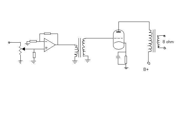

I am thinking of using OP627 to drive 2a3. One of my concern is the output current requirement to drive output tube. I am not EE, but I think this should be easilly solved with a BUF634 buffer. Both of these chips has been used succesfully on SS preamp designs.
Suggestions?

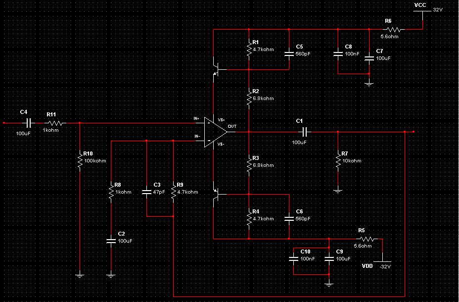

adjust the feedback values to obtain the desired gain and bandwidth.
the power supply rails at this example are +/- 32 volts, but depends of the opamp, you could carry them to +/- 36 volts.
if you only need 45 volts peak to peak, a good start is a power supply of the +/- 24 volts with a 5534 op amp. I think that the 5534 will work fine up to +/- 32 volts, but you need to check the voltage at pin 4 & 7.
I chose a single opamp because they have low crosstalk, remember the output voltage 45 volts peak to peak, but you can use a dual opamp with +/- 18 volts maximum supply rating
the circuit has black background, if you can't see nothing, please contact me.
Op-amps generally run off +/-15V rails. A 2A3 needs about 45Vpk to drive it, whereas your op-amp can probably swing to 13Vpk. It's not current that's the problem, it's voltage.
Yes, that is the first limitation. I was thinking of interstage trans to solve this.. but this will limit the design to a good interstage trans, thus offset the cost reason.

However, from the feedback I gathered, the opamp is limited by output voltage. Other than this, any other technical challenges?
skyraider said:
IOne of my concern is the output current requirement to drive output tube.
It shouldn't be a problem if you're running class *1 since the only current flowing is that charging the Miller capacitance of the output valve(s). If the opamp can output a few mA, maybe class *2 operation may be a possibility.
Checking the datashett for opa627+buf634, this should be able to go up to 250mA, which is more than enough to drive the interstage trans.
