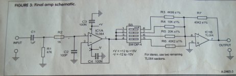

I built this gain booster for one of the ways of my active system. It works, but the right and left channels are misteriously mixed: input in either channel finds its way to the other channel as well. The tester beeps when applied to legs 2 (or 1-they are shorted in this circuit) or 7 (output) of each opamp, only when they are powered. No shorted solder on the board. I am using two 8-pin opamps. Happens with different types I have tried it with.
Any ideas?
Thanks in advance

When a simple circuit does not work, no matter how many times you check it or rebuild it with new components, this is a fairly clear sign that you have misunderstood something. Your rebuilds include the same mistake. Your checking is simply comparing a mistake on a built circuit with the same mistake in your head, so it always looks fine.
Show us the circuit diagram of what you thought you built - not a vaguely similar diagram using different chips but the actual diagram you used to build from. Then show us what you built.
DF96: The diagram I posted is exactly the one I built , except mine does not include C1.

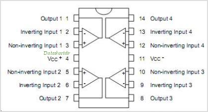

The circuit you gave was for a 14-pin quad amp. You used 8-pin amps (duals or single?). That means 'transposing' pin numbers as you go; very prone to error, and very likely to give the symptoms you have found. That is why I asked for a diagram of what you built, not something slightly different.
When you draw out what you built, or add new pin numbers to your existing diagram, it is quite likely that you will find your mistake.

You are right. am using opa2604ap. They are dual. The diagram attached shows the two stages consisting of + and - inputs and the output; plus voltage supply.
Only difference with the quad is -v is on pin 11 in the quad but on pin 8 in the 2604. Also + and - pins are in inverted position in this opamp compared to the quad.
