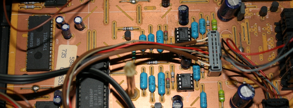

Please look at the schematic: http://www.file-upload.net/download-2761113/DP1001_SM_KENWOOD_EN.pdf.html
There is already as default an additional small film cap at the opamps.
Page 10 row 5 column AF there you see C27 between supply pins + - of opamp IC2 !!
Page 11 on the top left near the off going from pcb there you can see C98 also between supply pins + - of the opamp IC1 !!
Can you tell why there the caps are between opamp suplly pin + and -, and the the big supply caps are connected each to the ground?

In the manual on page 10:
In the signal path at the audio output at the RCA jacks there are caps connected to ground for cancelling the HF in the signal!
In the power supply there are only the big caps connected to ground. After that there are circuits called "AVR", they are "gyrators" , electronical inductors to smooth or cancel ripple. So there is no need for further HF cancelling in the power supply.

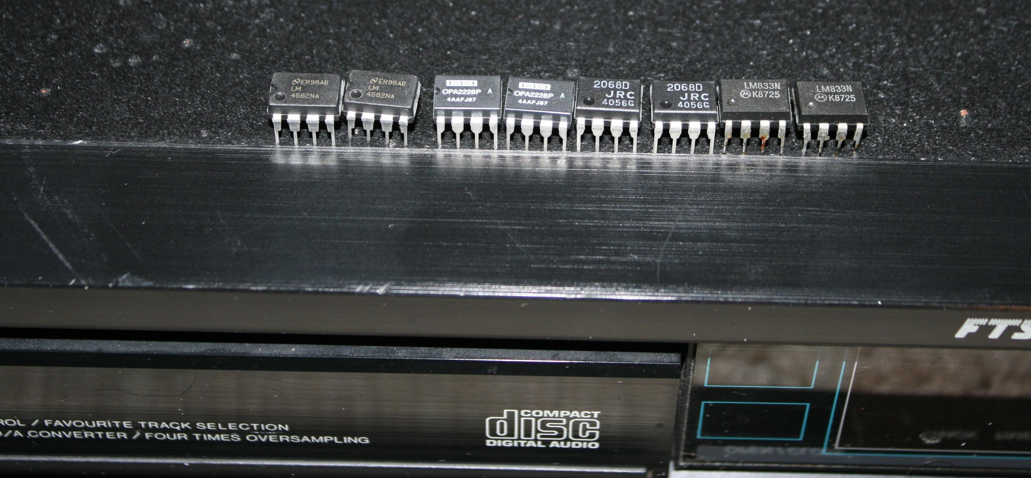

I only want to try a better opamp from NJM/JRC.

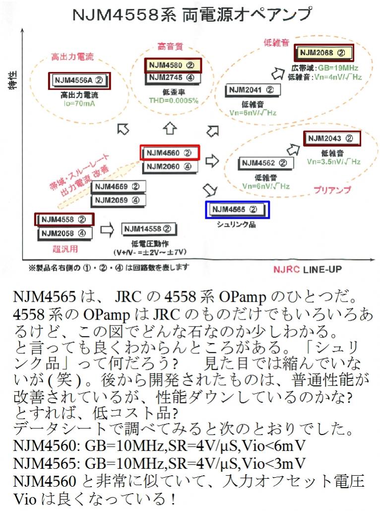

Here is an older overview of opamps for audio from NJM/JRC:Can someone japanese?
I think the NJM4580 and the NJ2068 is worth a try.
Otherwise the NJM4565 is put again in the player.

Why japanese? They have english page (for characteristics):
Products list[Semiconductor Selection Guides[New Japan Radio]]
As I said, i did try 2068 and where OK, better than original LM833. Denon and Harman Kardon use 2068 as higher end OpAmp in their products.
Personally, I stayed with LM4562.

The text below roughly says:
NJM4565 is one of JRC's 4558 series of OPamp. There are many in JRC's 4558 series of OPamp and you can use this chart to slightly understand what type of product they are. There might still be something that you may not understand. What is "shrunken product"? Not visually shrunken in size (laugh). It was developed more recently, did it get better performance compared to the previous product, or was there a reduction in performance, low cost product?
According to the datasheet,
NJM4560: GB=10MHz, SR=4V/uS, Vio<6mV
NJM4565: GB=10MHz, SR=4V/uS, Vio<3mV
Very similar to NJM4565, better input voltage offset Vio!
I think product shrink refers to die shrink.
