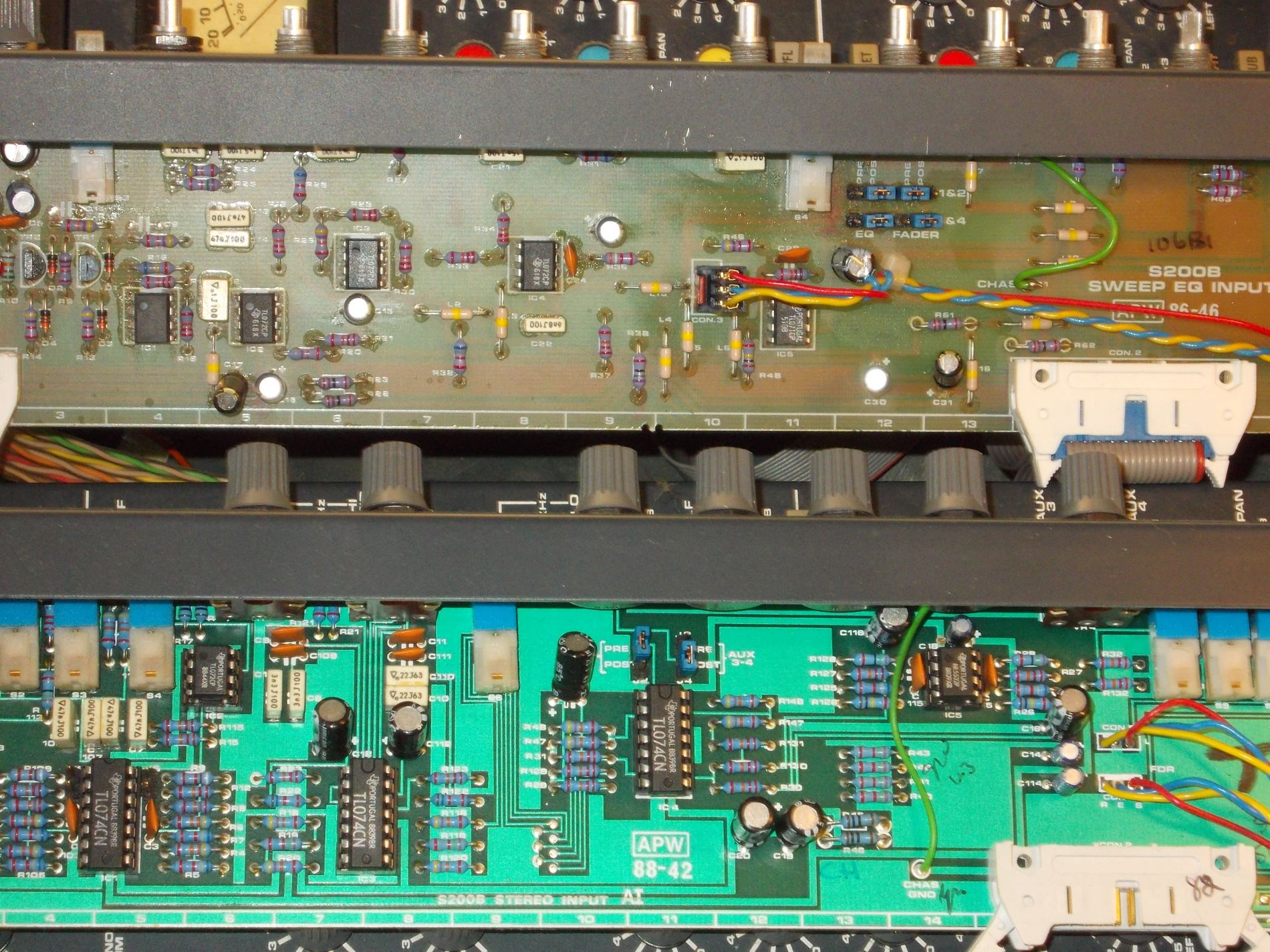

I like the the sound of EQ built around TL072, but I find the consoles with full of TL072/074 sound a little murky (slow) in general. Middle class consoles with full of TL07x from 80s-90's such as SoundCraft, SoundTracs, Neotek, all share the similar sound signature. I'm sure that some consoles such as Neotek and Trident are still considered to be very desirable by many for their warm analog sound. The consoles built around 5534 usually sound cleaner and punchier. It's not uncommon that the consoles with the mixture of 07x and 553x, and 07x are usually found at EQ parts.
What do you mean by tl072 sounding slow? old TI tl072 had 13v/us and unity gain internal compensation too.Now they are 20v/us parts ...Ne5534 has a slew rate of 8...9v/us at unity gain with external compensation.
To 'sound slow' uses words to describe a perceptual experience.
A slow slew-rate refers to a measurement. A slow propagation delay could also refer to a measurement. Same thing for a slow rise-time.
They are all different contexts which affect the meaning of the word 'slow.'

Besides any tl072 ever used can be replaced by opa2134 or 2132 ...try swap them and hear the difference cause their parameters are really different especially output impedance and you'll quickly realise that the impedance of the next stage plays the most important role in how a tl072 sounds.

TL072s have poor overload recovery and are hissy as hell. If you think they sound 'murky', it's probably because of the blanket of hiss they leave everywhere. They are great outside of the signal path as drivers for metering or simple DC duties etc. I'd hate to see them discontinued.
