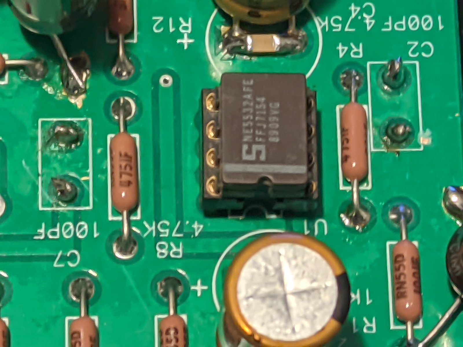

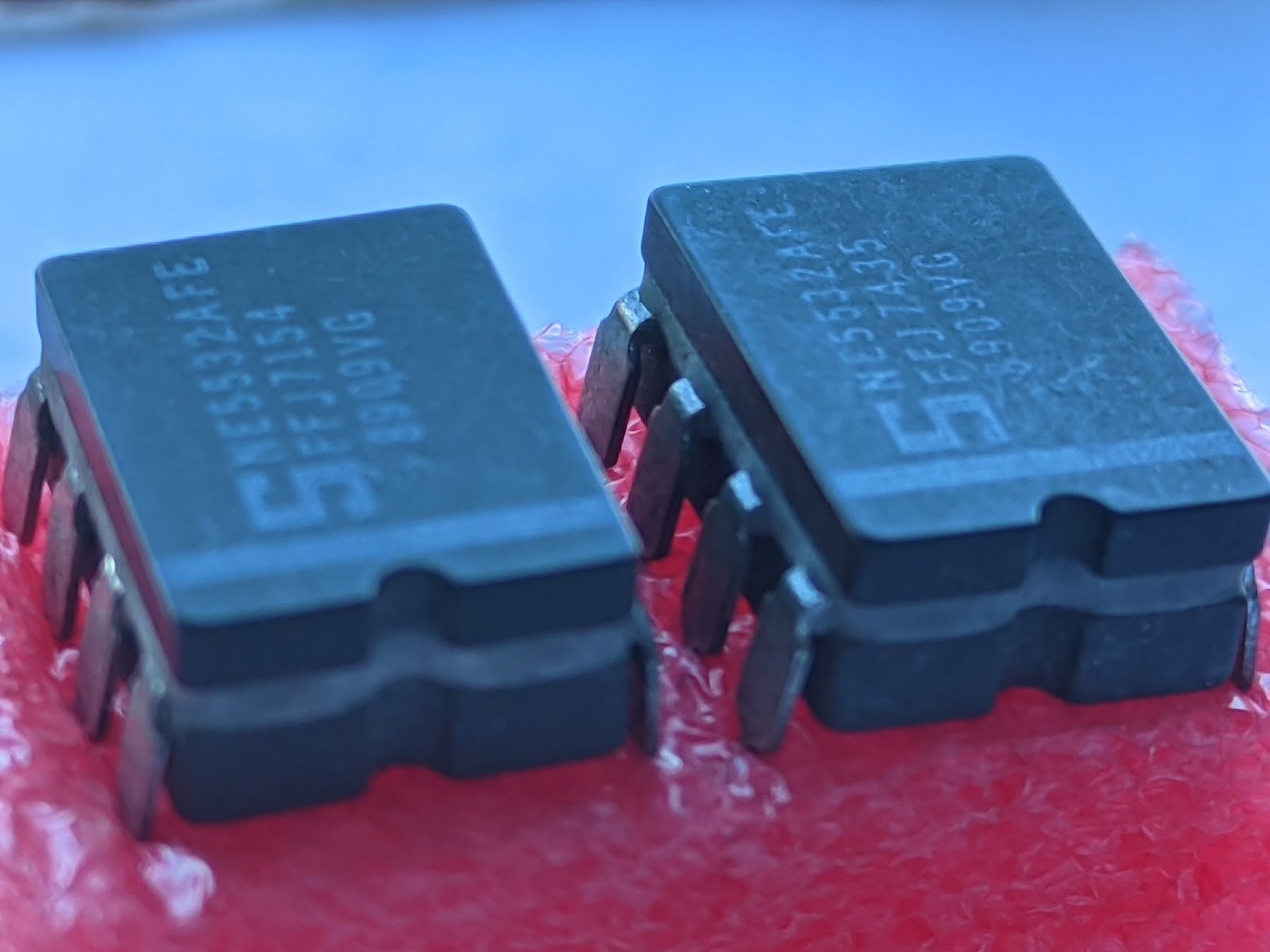

The ceramics arrived: 10 grams of 2 op-amps. They are built like a tank.
One was placed in WHAMMY😎

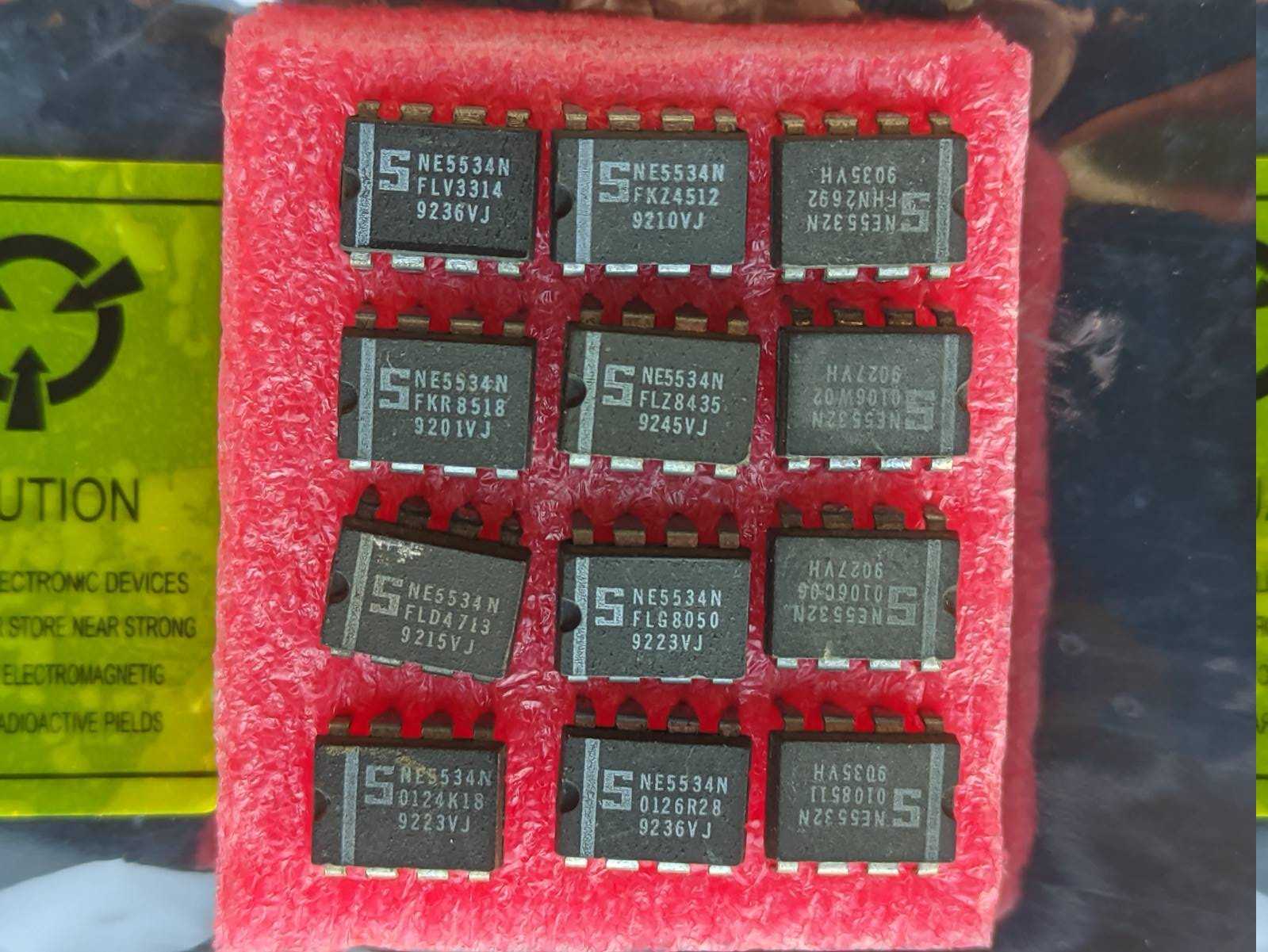

I've also started stocking up. I'm waiting for another 10. I think the best are the production years 1987, 1988, and 1989.

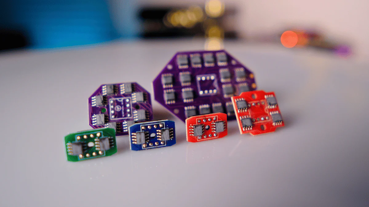

Seems the audiophile opamp scene have gone a full circle from IC's to discrete and now back to IC's, VirtualHiFi thinks they have found a solution using lots of opamp IC's in parallel:
Recently, discrete Op Amps became popular.
Since they are built with individual components, many consider them to be better-sounding than the regular integrated Op Amps we know very well.
I agree. I tested many different Op Amps, and the discrete ones always truly shined and sounded superior.
However there is one trick that can be done with regular IC Op Amps - paralleling them

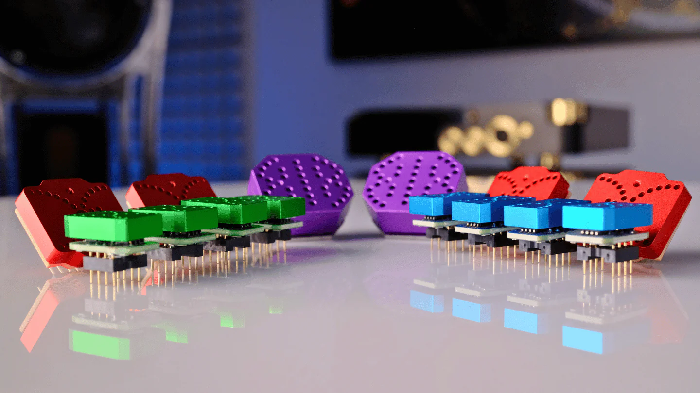

The candy bundle below are yours currently for a discounted €848,70, down from €966,78. :)

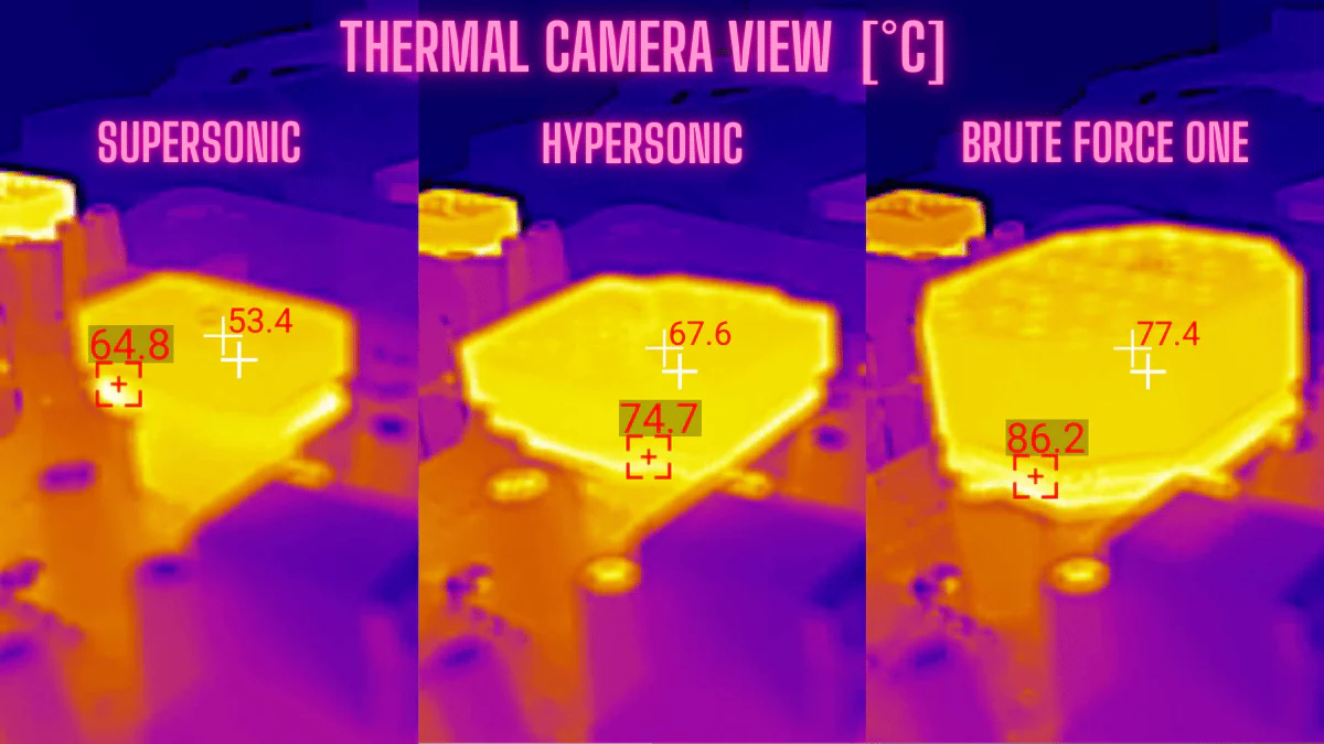

and running them hot (up to 42 mA / opamp):
Ok, where is the catch? Why is it not that popular?
Well, there is a price to pay for that enhanced performance.
First of all, it’s the increased cost. There are multiple Op Amps instead of one, which makes the device cost multiple times higher.
The second thing is size. That increases multiple times as we multiply the number of Op Amps in parallel.
Also, the more Op Amps we parallel, the more power they draw.
So, not only most circuits never were designed to provide the needed power, but excess heat also needs to be dissipated by additional radiators, which increases the cost and size of such Op Amps.

You cannot simply parallel opamps directly, each opamp needs its own local private feedback and the load isolation resistors before combining the outputs. While we can spot some 1k resistors on those boards (on the underside) it is not clear how this would cater for the required specifics for a given circuit.
