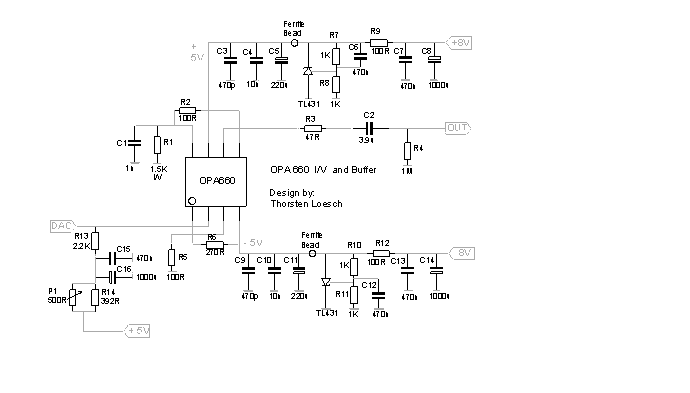

OPA660 Circuit
Kuei,
In a previous post where you first described your circuit, which is now shown in its complete schematic form, you made the following recommendations for inclusion of a low-pass filter to eliminate the higher frequency duplicate images.
Excerpt quote:
This has no lowpass, I would recommend a 62nF capacitor to ground on the output, this forms with the 51 ohm build out resistor a 50KHz 1st order lowpass, sufficient if the DAC is operated with 4 Times oversampling or more. You could make the Filter 2nd Order by paralleling the I/V resistor with a suitable value capacitor.
For a 50KHz 2nd Order lowpass we use a 33nF capacitor on the output and a 1nF capacitor in parallel to our 1k5 I/V conversion resistor.
In the schematic, I do not see a capacitor to ground with the 47 Ohm build out resistor to form the other filter pole. Was this omitted by accident or found to be not required? I was preparing to build the circuit based on your original verbal design recommendations until I saw this recent schematic.
Could you please advise?

Koinichiwa,
Well. First, the circuit, while inspired by my lunatic ravings is still fully designed and implementd by apassgear and I'm terribly chuffed that he gave me credit.
I am not certain if apassgears CDP retains oversampling or not. THe key I think is that adding lowpass filters and such is amtter of choice. If I where to make a commercial product I'd probably make both the suggested output cap and the cap in aparallel with the I/V Resistor switchable, simply because some systems will sound best with no filtering at all, while others will need loads...
What I did was to suggest several possible approaches that I have myslef employed in similar situations. I do belive in "pick and choose". Use of my ideas, writing philosophy and the like what suits you. I won't hold it against you if you like something I don't or dislike something I do....
Schnitzer
As you can see from my first post on this thread I'm still using a digital filter which I guess is a 4X oversampling. Though I might test a nonoversampling connection in the near future.
I have a gut feeling that this DF is better than a low pass filter at the analog stage, though I can't confirm.
As far as I know, correct me if I'm wrong, this is the first implementation of an I/V analog stage done with OPA660 so some precautions were taken to ensure that this implementation worked from the beggining and so it did.
For this reason I added a small cap, 1n, in // to the I/V resistor just to get rid of higher reflections, for what it might be worth. Since I would prefer the simplest circuit possible I may also get rid of this cap. But this has to be done with some foot on the ground to start tweaking.

apassgear said:
One question, a little off topic but reffering to this CDP.
I saw on the schematic of the Adagio posted on your web site that you use a reverse polarity for the additional cap on the MSB, a 15u Os-Con.
Well, the schematic was drawn by a friend and contains some errors. However, the Tilter pin's of the TDA1541 are all negative in Voltage (I measured), so the Cap needs to go positive to ground. I used 3u3 BTW.
