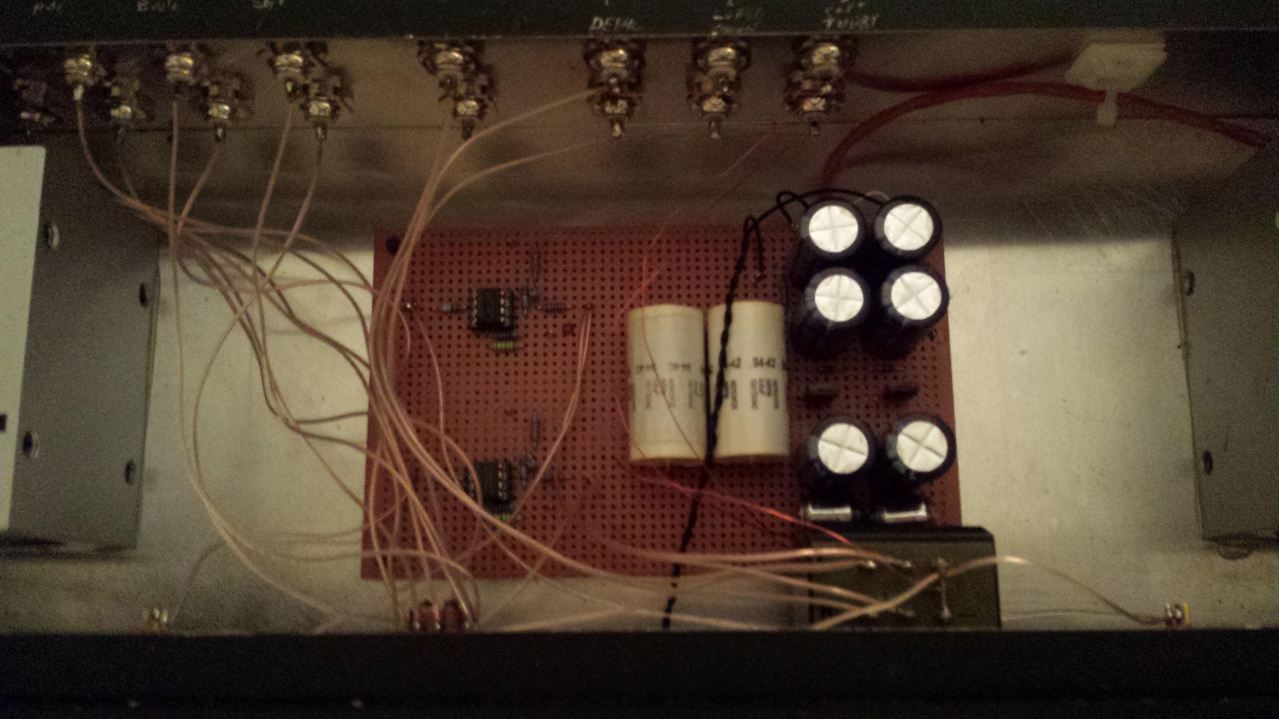

OPA627 Preamp Dynamic Crosstalk Issue
The unit only had crosstalk with the input open. Shorting the input, xtalk gone.
Close or same L to R and R to L level approx -60db. Starting about 3k with rising response.
That's usually caused by capacitive coupling between the channels.
Start by shielding the input wiring, and improving its routing, with
more physical separation between the channels' input wiring.
