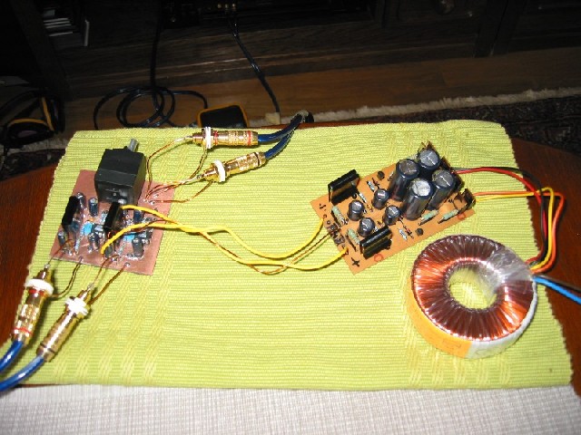

Re: Re: preamp (stereo) pcb layout
Will it work,if the first op amp is layout for opa2134?
Alcaid said:
Here are pdf files, but you can't use a opa2134, because it's a dual opamp, and this design is for single ones.
bottom layer:
just finished my opa2134 & buf634 preamp. It sounds different,I dont know about better. I think it maybe a little clearer.
jaudio said:just finished my opa2134 & buf634 preamp. It sounds different,I dont know about better. I think it maybe a little clearer.
Compared to what?
Alcaid said:
Compared to what?
First thanks for the help the opa549 amp,It is working.
I have one preamp that is a combo of Esp 02 & 97, it sound pretty good. I also have a preamp with 4 sockets for dual op amps. I tried different combinations of op amps(opa2134,ne5532,412,tl072,lm353,etc). so far I like 2 ne5532 and the 2 412 the best. I had the opa2134 & buf634 and the ne5532 & 412 running for least than two days,so that might be a doesnt sound as good as it should.

I built a couple of headamps to see if I could hear the differences between opamps. I found the cmoy was very sensitive to opamp selection and supply voltage, while in a $12 kit headamp it seemed to make little or no difference, so I concluded that everyone was right, in some circuits the opamp makes a big difference, in others, very little. 😉 So using better quality opamps will make an "improvement", just the improvement may be enormous or so small you can't tell.
I have to admit my testing procedure wasn't very scientific and just based on gut feeling, but it produced an answer I can live with.

Re: sound of single opamp?
It IS less sensitive to decoupling capacitance.
But used correctly the OPA627 is better.😀
I think Matjans knows all that, I've been telling him for a long time.😀
Just a final note: a good PSU decoupling will do no harm to any op-amp. The OPA627 will sound at it's best, but also most other op-amps will.
But there is not such a thing as the best op-amp for everything in audio applications.
I/V conversion, line preamp, phono preamp (MM, MC...) the implementation and component values used... there is always one op-amp that shines on one circuit and may sound less good on another.
There is no universal solution.
But if one knows where to use a good bipolar and where to use a good fet-input op-amp, that's a good starting point.
