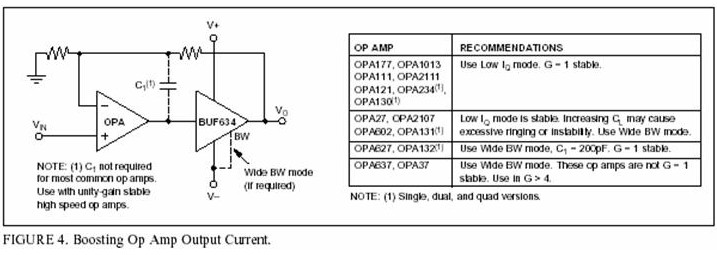

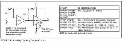

There is some more stability info on the '634 data sheet, relative to the selected opamp: (hope you can read it)
Jan Didden

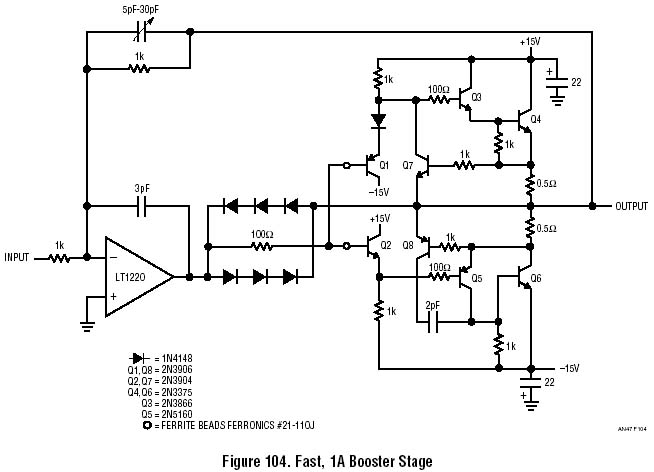

Re: High Speed Amplifier Design Application Note
Elso Kwak said:
Hi, An explanation for all this (driving a buffer with a high speed opamp) is beautifully explained in this application note by Jim Williams of Linear Technology:
http://www.linear.com/pub/document.html?pub_type=app&document=50
Even features a discrete and better sounding buffer than the BUF634........
This is interesting, but I have the buffers, and going discrete would cost me more. Maybe a version 2 though 🙂
Hi Elso,
Very interesting! Thanks. Williams is one of my hero's, I have lots of app notes from him (and his two books of course).
Required reading if you're serious about this!
