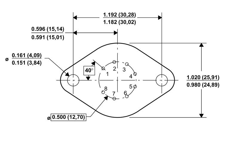

I will try out OPA544 next. I don´t really need the power. Very cool are those high voltage high current OP amps in TO3 with 8 pins - only i don´t know how to mount them on a heatsink - if i drill than many holes there is not much heatsink left for thermal contact.

till said:have to drill a lot of holes?
This is one way...
I know some way out there is a TO-3 8 pin IC socket! With heatsink! 😱

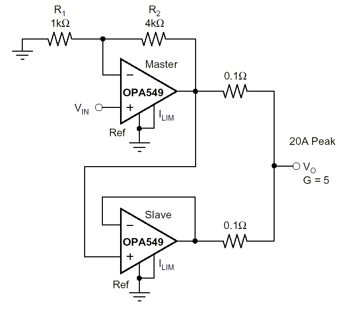

parralel/bride of opa549
http://focus.ti.com/download/trng/docs/seminar/sigcond_5.pdf
page 20 the super power amp.
Have any body build this circuit used for audio.
does the resistors have to mached ?
It look very simple I wonder if the parralel side will "fight" and get very hot.

TI parallel circuit
The reason I was asking for comments over that OP549 parallel arrangement, is because they do not a very good thing, as pointed up to me by Kuei Yang Wang over a bridging circuit I had seen.
The output of amp A1 feeds the input of amp A2, which means it's feeding distortion and all that.
Once again, it was no suggested specifically for audio. So I wonder.
Carlos
Carlos

Heatsink
10 holes per OPA549...
I tried making a prototype heatsink with an aluminum plate measuring 9x4x0.25". I copied the mechanical drawing to PPT and adjusted its size to exactly the same as shown in the drawing. Then I printed it out on a paper, cut it, pasted it on the aluminum plate, punched, then drilled 10 holes using drill press. The whole process could be done in 10 to 15 minutes except for the making taps for mounting the amp. Before installing the amp to the aluminum plate, all the pins were masked (insulated) with heat-shrinkage cable cut to the 2/3 of the length of the pin.
In short, drilling holes is not so much time-consuming and you have enough area, which will contact the amp, for heat transfer. If you can find a heatsink for TO3 devices without any pre-drilled holes, you have no problem.
I'll post some photos if you're interested. 🙂

The reason for paralleling them is not so much for current, but for power dissipation reasons. If you run those opamps with 8A with their maximum supply voltage for any length of time with any voltage across them (like in a linear amp), they will go into thermal shutdown and not work well. Paralleling them makes the effective allowable power dissipation be equal to the sum of the power dissipation ratings of the opamps, and will allow for greater output power.
