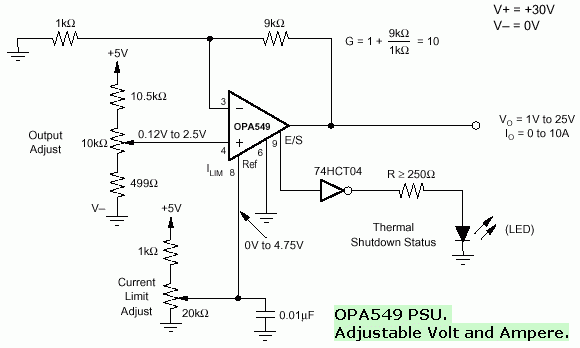

OPA549 can drive motors and also be used
as a powerful Ajustable PowerSupply. And power amp.
The picture below shows an appl. from datasheet:
Adjust. 1-25 Volt Output
Adjust. 0-10 Ampere CurrLimit
with 2 potentiometers.
Probably you can use another OPA549 as a Negative PSU
to get a dual supply. plus minus 8 Ampere!

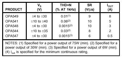

If using speakers with high enough impedace, why OPA549, wouldn´t be 548 better?
If you're saying that OPA548 would be better than OPA549, is it because of THD? Would the defference btwn 0.01 and 0.0015% be audible? Just curious. 😕 And I see that those THD values were specified at different output powers (70 and 35 Watts).
Well... at the same PS voltage, OPA549 can give more current than OPA548 can. So, "power-wise" I would go with OPA549 especially for the subwoofer project that I'm planning. 😉
