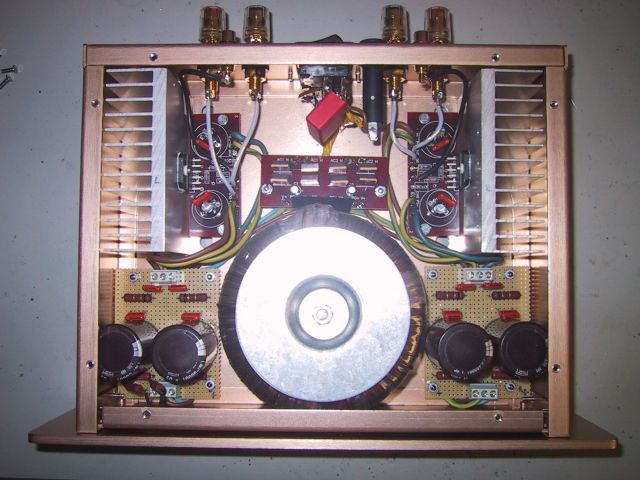

I use my BosoZ preamp to drive the amp. The gain setting is fine.
Yes, the toroid is very close, and this could be the reason for the hum. I will try and move it outside the chassis if this is persisting.
Have a look at the chassis from the top. Fairly packed😉

Nice symmetry, but that toroid concerns me. Might be the one who's humming through your speakers.
Me too. I saw a lot of chipamps on this forum with the trafo very close to the amp boards though. I hoped to get away with this setup. I like the small chassis🙂 Moving the trafo away from the chassis, will tell if that is the problem. It is only a slight hum, but annoying anyway.that toroid concerns me.

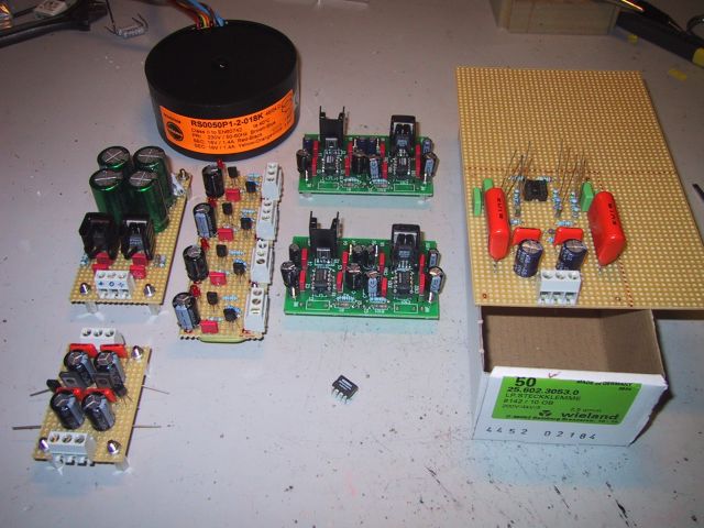

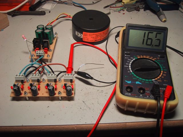

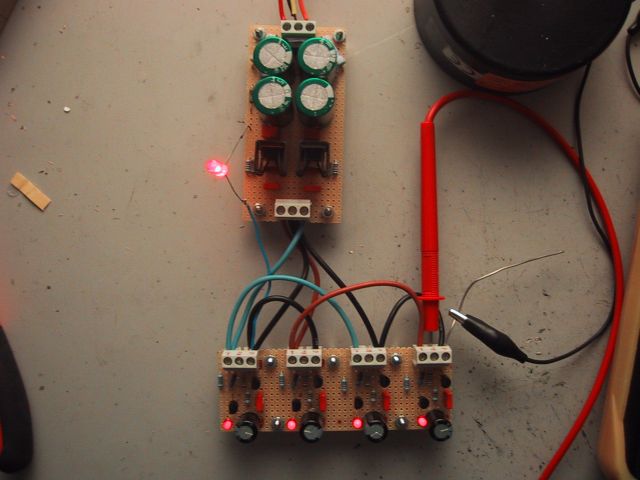

Just finished the supply boards for the OPA627/BUF634 preamp.

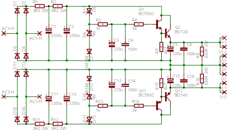

I used Nuuk's schematic here: http://www.decdun.fsnet.co.uk/gainclonepre.html#gcprepsu1 . Well, more or less at least🙂 There is two times +16,5/-16,5v, so each channel is to be fed from its own supply. I must confess that it was a bit time consuming, P2P wiring this supply
Have a look at the boards.
Steen.

That looks really good, Alcaid. I was considering a discrete regulator too, but decided on Nuuk's reg supply in the end.
Have you seen this page on voltage regulators: http://www.tnt-audio.com/clinica/solidstate.html .
Lots of good info.
