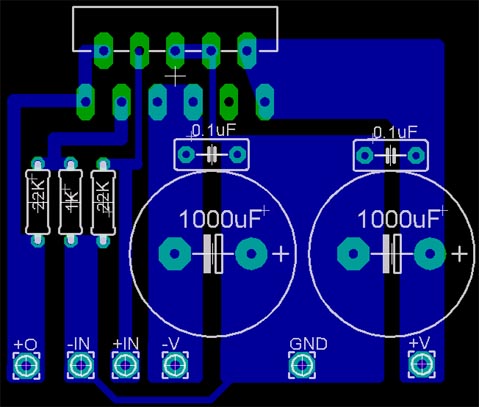

I built this amp in one weekend.
But it's not cased yet...that may take 3 or 4 weekends for me 😀
I used Alcaid's OPA549 schematic, 330uf caps. The board for each channel is 1 3/4 inches square, point-to-point wired.
I made sure to "double up" on the wire thickness in the power input lines to the chip, as well as the ground, and the signal Out.

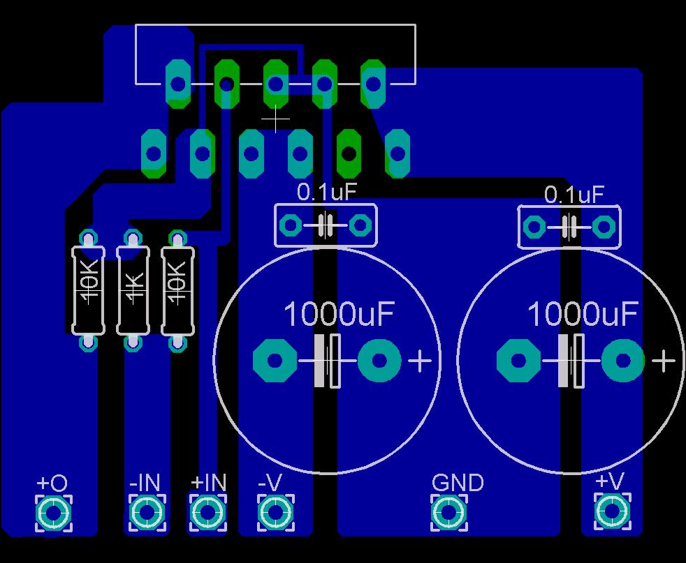

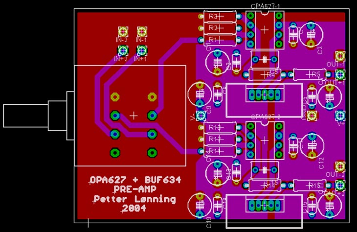

I etched Alcaid's PCBs to find out that all my drill bits except bent 2mm one are missing... Anyhow I just love your schematic and PCB!
It will be nice 2x10W@8Ohm/2x20W@4Ohm amplifier when finished 🙂 That will happen in few days, I hope.

JannaCassandra said:How much power will i get with OPA549 using +/- 25V?
Something around 40W with 4Ohm load or twice less with 8Ohm.
