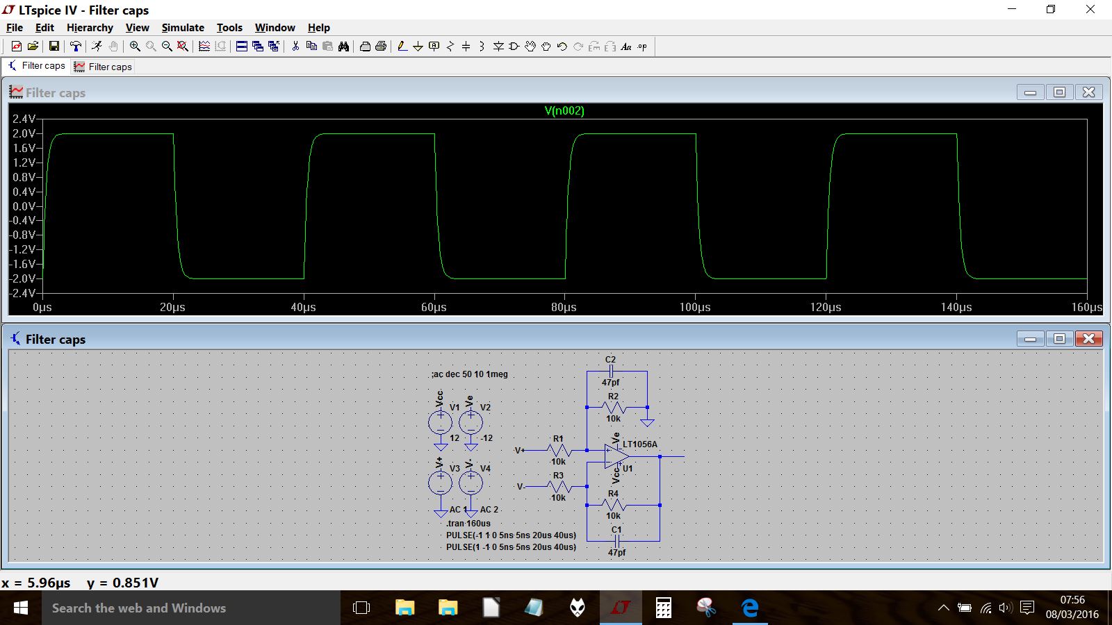

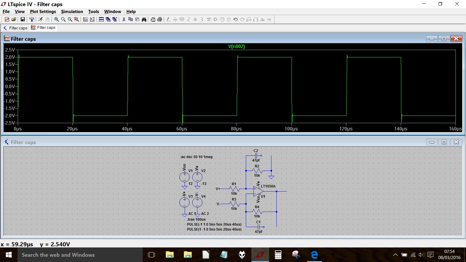

I'll guarantee you won't see any difference on a scope between the different caps (apart from differences due to tolerance). What you will see is how the addition of the caps affects the high frequency response of the circuits causing an increase in the rise and fall times. In other words the squarewave will be more rounded.

Thanks a lot for doing this Mooly, pictures tell a much better story.

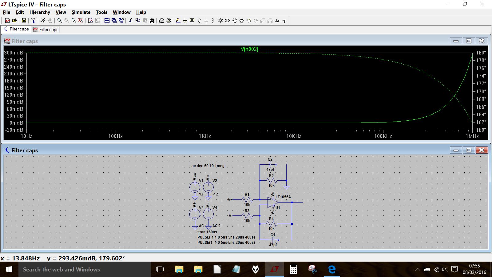

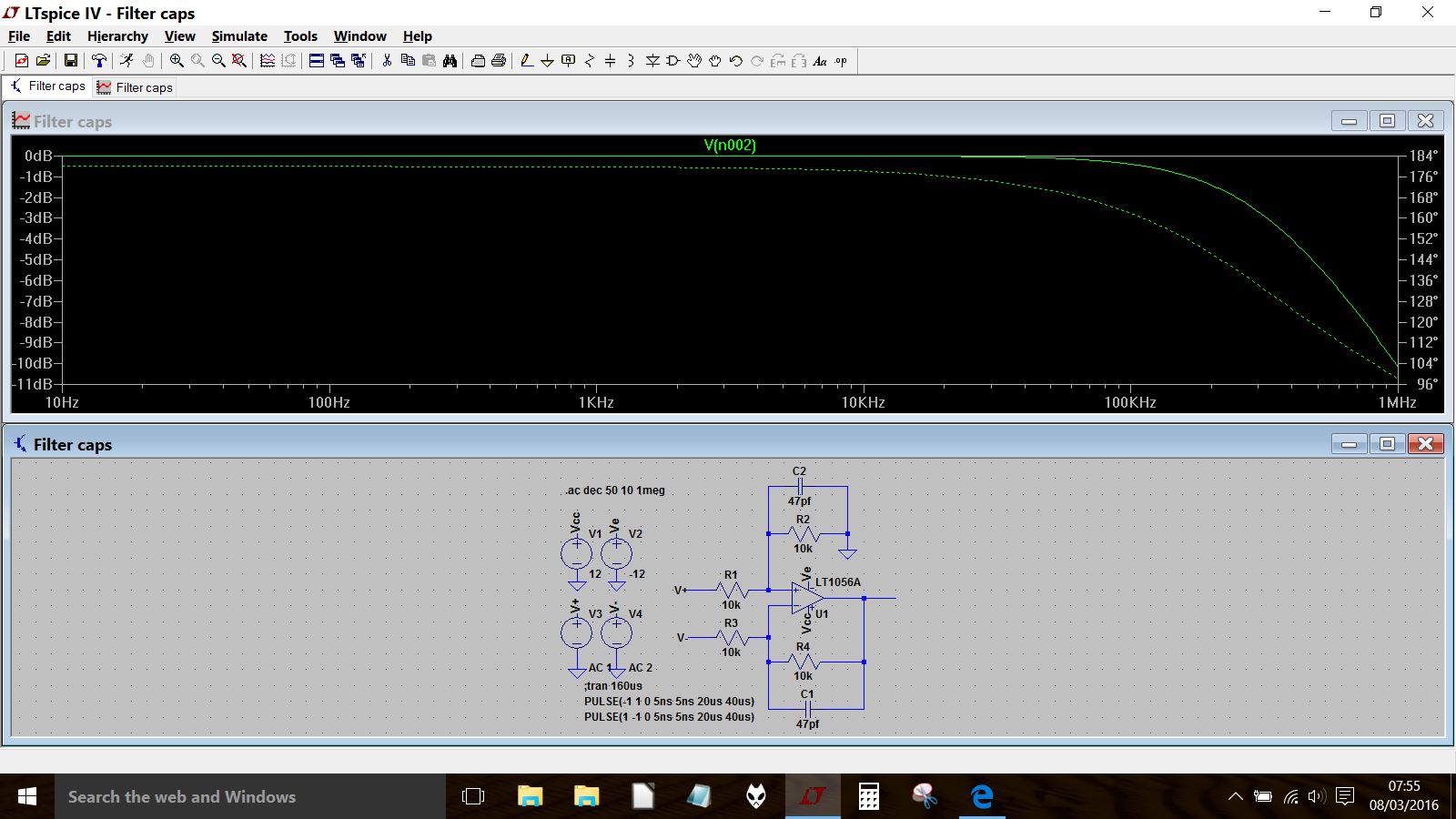

This is what you will see using 47pf caps. Frequency here was 25kHz. Also look at the response of the circuit with and without. The opamp here is not unlike the OPA2604.
