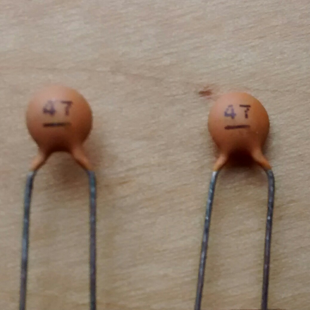

Yes. A COG or NPO dielectric should be used. They tend to be quite linear. You should certainly avoid X7R and Z5U dielectrics.
You may also find silver mica caps, and film caps, and they should be good also.
Thanks, I'd better try to track some down then, I have no idea which sort I have used. They just say 47 and look like the ones in the attached photo.
Those are cheapo compressed disc ceramics and if I'm not mistaken, the 'Multicomp' brand. Not an ideal choice it must be said... however can you actually discern an audible difference when substituting something else.

The zero tempco ceramic NP0/C0G have a painted black strip across the top of the coating (usually). I have some NP0 with just the number (pF) and not even a voltage code.
Well to be fair to the Multicomp brand ceramics, they are C0G/NP0. I just have lots of practical experience of compressed disc ceramics and how they were a major failure item in generation after generation of equipment going leaky/noisy and so on.
These unmarked one are probably 50 volt DC rated.

I just found out that they came from a Maplin selection box of various value ceramic caps. So probably the cheapest available.
I might well get some of the ones you recommend, a few quid spent to get something quiet and reliable (and hopefully better sounding) is well worth it.

These have no other markings than those shown, so I don't know the voltage rating either.
