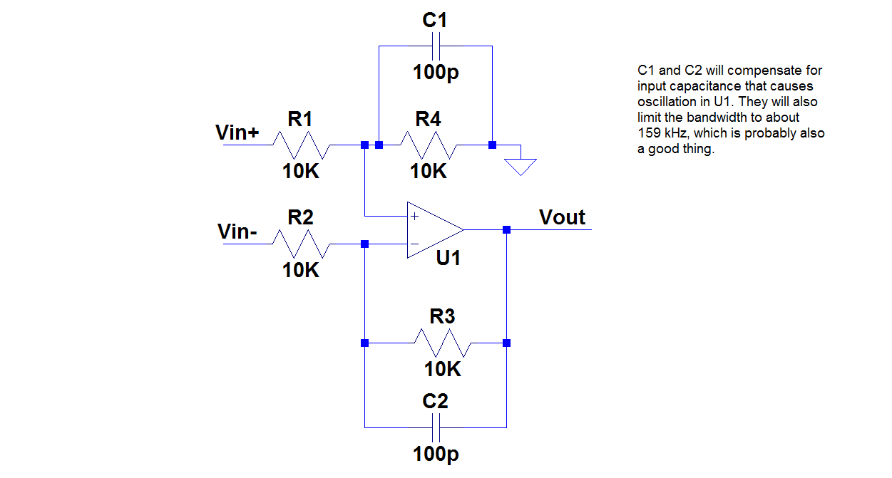

I have a circuit that is causing me problems with a 2.2 MHz oscillation. This is a proven circuit (with older op amps, it is supposed to work with NE5532, TL072, OPA2134 and LM4562 "etc") and seems to not like the OPA2604. I have isolated the input buffer from the rest of the circuit and that makes no difference.
The input buffer is formed from one of the two OPA2604 op amps and is very simple, each input is via its own series 10K resistor, with a 10K from the output to the -ve input and a further 10K from the +ve input to ground.
The oscillation is a very pure sine wave and is only visible on the -ve input to the op amp. I am wondering if the only way to fix this is to go to slower op amps. I am guessing that this is a problem formed by a compound of stray capacitance, local PSU bypass caps and the 20MHz bandwidth of the op amp. The chips are soldered directly to the board, no chip carriers. Local bypass is 0.1uF with some 10uF board level bypasses from a regulated +/-15VDC supply

You are probably seeing excess phase caused by the 10K feedback resistor to the negative input. If we assume 4 pF of input capacitance in the chip and bonding pad, and 6 pF board parasitics, then there is a pole at 1/(2*pi*10e-12*1e4)=1.6 MHz. That's certainly low enough to make a 20 MHz GBW part into an oscillator...
It will get worse if you probe the negative input with a scope, since that adds another 10 pF.
Best cures, assuming you want to keep the opamp?
1. replace 10K feedback resistor (from Vout to negative input) with a short, or
2. bridge 100 pF across the feedback resistor
Of course, there could be other problems, but the description above would be my leading candidates.

Are you saying these are configured as inverting amplifiers ? If so then shorting the 10k from + input to ground could be beneficial. You may simply need a small (say 4.7pf) cap across the main feedback resistor.
I didn't post the circuit because ESP (who make the board) make quite a thing about copyright. I could probably redraw it, it isn't very special. This circuit is configured as a simple balanced audio input taking +ve and -ve from XLR connectors in a normal pro audio configuration. I don't think that shorting the +ve input to ground would be beneficial in this case would it?

You could try out a 10 nF cap from the V+ to the V- pin of the pampas. Are you sure your +/- 15V power supply is working OK ?
Would that be in addition to the 100nF already there?
DC outputs look good and measure accurately.
47pF across pins 1 and 2 (output and -ve input) in parallel with the 10K definitely changes things, amplitude much lower and frequency shifted to about 5MHz. I have also noticed that the filter sections (using the same op amps) are not oscillating in this way but the output buffers (set for unity gain unbalanced outputs) are also oscillating.

Try looking here Balanced Interfaces at Fig 4 and it is the Simple Single Opamp in the top left of the diagram. All resistor values are 10k as in the drawing.

I didn't post this earlier, but having seen what we are now looking at it seems more appropriate. I found the OPA604 (single of the 2604) oscillated when used in a similar configuration which is here,
http://www.diyaudio.com/forums/anal...u-have-checked-see-its-stable-havent-you.html
I'm sure djoffes solution above will work, I'm just a bit surprised the OPA(2)604 is so unhappy in this configuration. 100pf as suggested is bang on the money and would give a -1db point of around 80kHz
Now that looks like a very good idea! I will try it out tomorrow and report back. Is it better to use the smallest value possible or is 100pF an optimum? You people have all been very helpful, thanks a lot.
This will do the trick, I think.
Yes, I had read that thread, it was very interesting and I have a 'scope. I noticed some HF noise and wondered what it was, I took a look with my scope and found all this oscillating going on. It made me wonder how many people try these things and don't realise what could be wrong. I didn't choose the OPA2604, they were already fitted when I got the project, they seem very well suited to the purpose, so I persisted with them.
