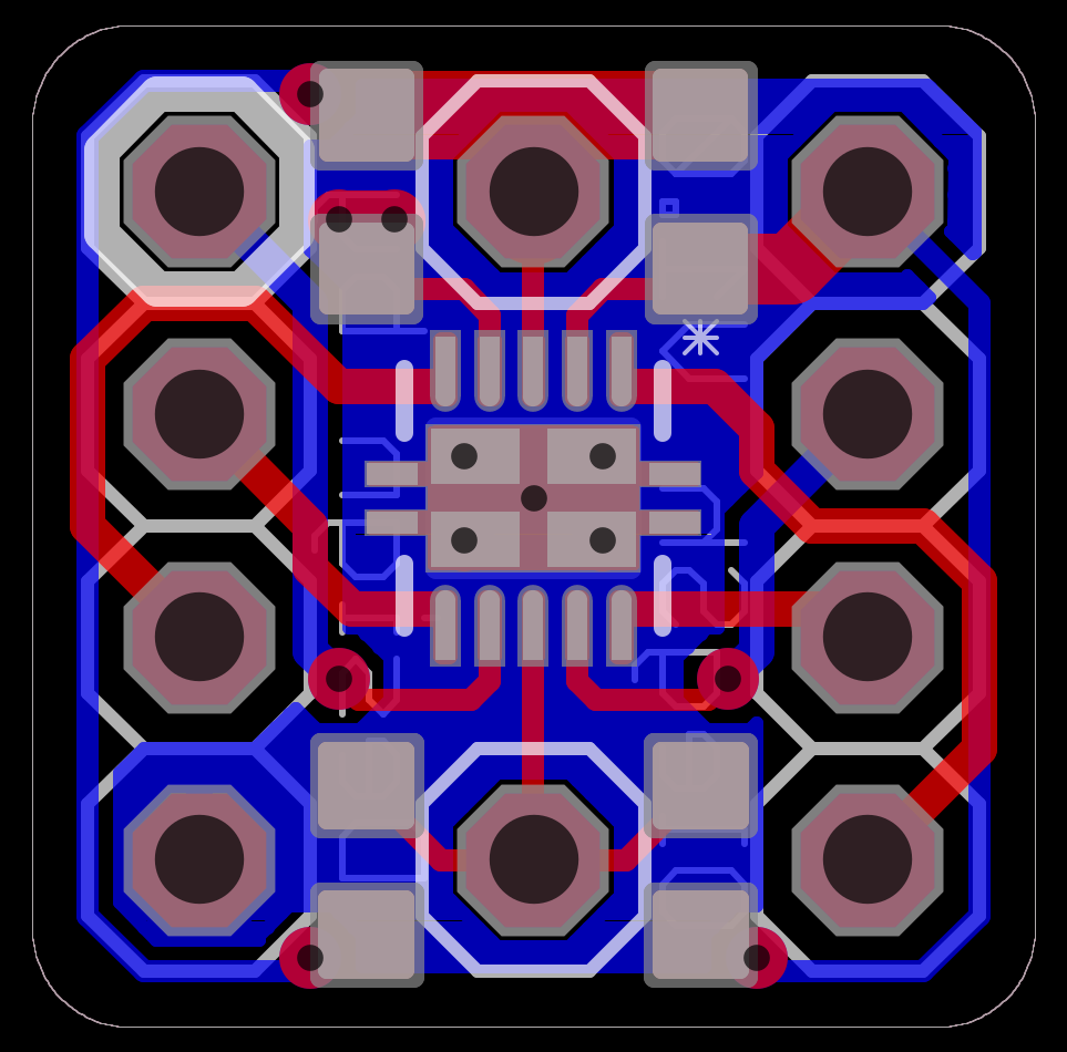

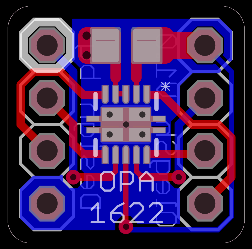

I'm totally fine with your initiative. If there will be leftover PCBs that you would wish to sell on 'bay I don't see a problem here either. So go ahead.
I've corrected some small "imperfections" on the adapter PCBs. I'll post updated gerbers today if I have time or tomorrow.

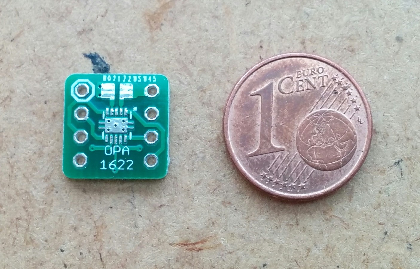

It looks like I should take an action and make at least a small test run of 10 adapters and may be assemble a couple of them by hands to confirm that the adapters work. Maybe agdr or someone else is silently doing it but we don't know it so far. In a week or so I plan to submit another batch of other PCB designs for manufacturing and can add 10 adapters to my order. I think it makes sense to produce only simplified version of the adapter without EN and GND pins. What do you think?
As I mentioned earlier I do not plan to run a GB of assembled adapters but I can easily supply some amount of bare adapters if there is interest. If agdr is already doing it then I'm out. I do not want to interfere with his initiative. I hope he reads it and can comment.

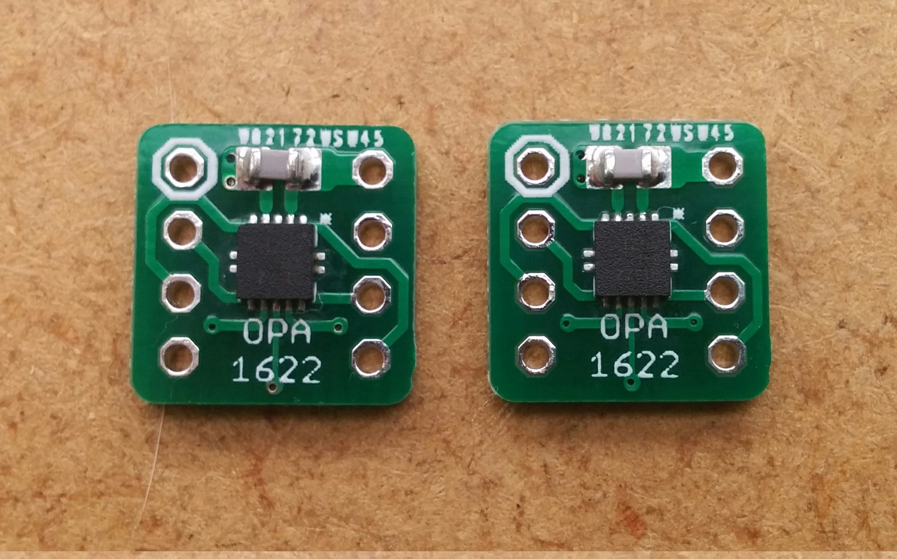

Since agdr is not going to produce the adapters for now, I'll probably make a dozen of adapters and try one if it works as intended. If it proves OK I can manually assemble the rest for interested diyers. This will probably be a single run of ~10 adapters since there is no real interest in them. So far only a couple of people expressed their interest so I assume that even 10 adapters is more than needed
I plan to place an order at mouser around this weekend. It will be delivered around Wednesday next week and somewhere around next weekend I should have a couple of adapters done for testing. The price will depend on how many ICs I'll fry during assembly. Assuming one adapter costs me around 1Euro, OPA1622 is around 7Euro at mouser plus small ceramic cap and pin headers, so rough estimate is around 10~12 Euro per assembled adapter (pin headers are not soldered but included) plus paypal fee (~1 Euro) and delivery (4 Euro registered mail, 2 Euro regular mail). If someone wants to assemble adapters by himself just drop me a PM. I have around 50 bare adapters which I don't need I plan to assemble just few of them for ammel68 and may be a couple of other diyers who have difficulty to solder VSON packages. I have no own interest in these adapters.
