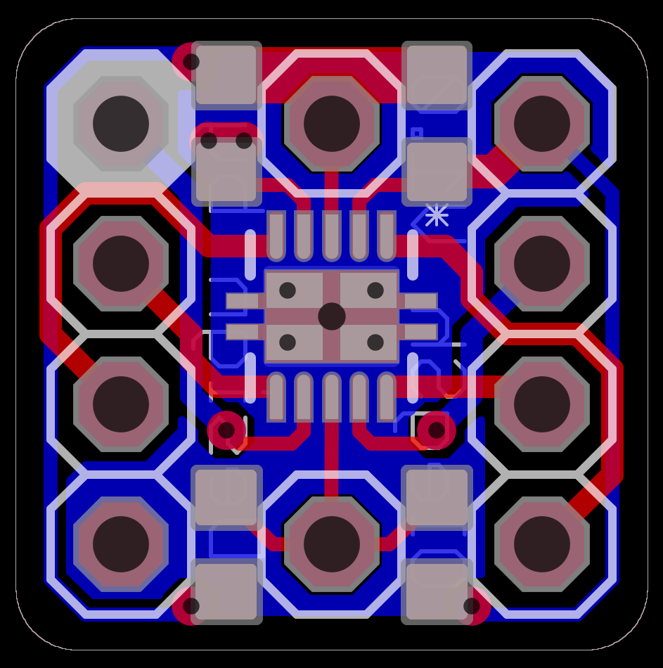

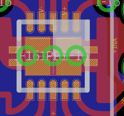

Revised my variant. Rotated the IC and switched the two op amps to allow for better routing. There seem to be two viable, geometric solutions (Olegs and mine). Changed the polygons for the thermal plane fill to be less "floody" around some corners.
- GND is connected to V- with a bridge between the left cap
- EN pin has a connector, and the trace can be cut to control it externally
- Big V- plane on bottom, small on top
- Board can be used "as-is" for DIP-8 replacement without sacrificing usability for prototyping
My experience with paste + stencil + hotplate soldering the OPA1622, was that I needed a couple of PCB revisions to optimize the polygons on the soldermask layer. %coverage and copper surround distance were fairly significant contributors to "%yield", where
%Yield = 100.0 * (# good boards) / (total # boards soldered)
So, I gently suggest building a low volume prototype run first, just to verify that you get high yield when soldering (a) on a hotplate; (b) with a hot air tool; (c) in a legitimate reflow oven. Then when you know all is well, launch the high volume PCB run.
Typical failure mechanism in my first revisions was pin-to-pin shorts.

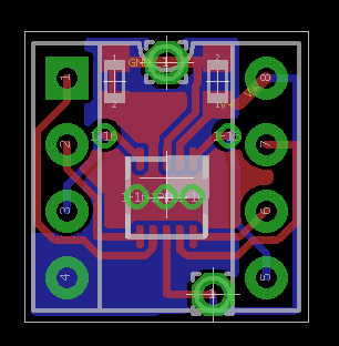

Regarding the layout/your yield: Good point. I suppose bigger copper areas close to the pins on the top layer contribute to pin-to-pin shorts?
If so, this should be mitigated by the layout attached to this post...

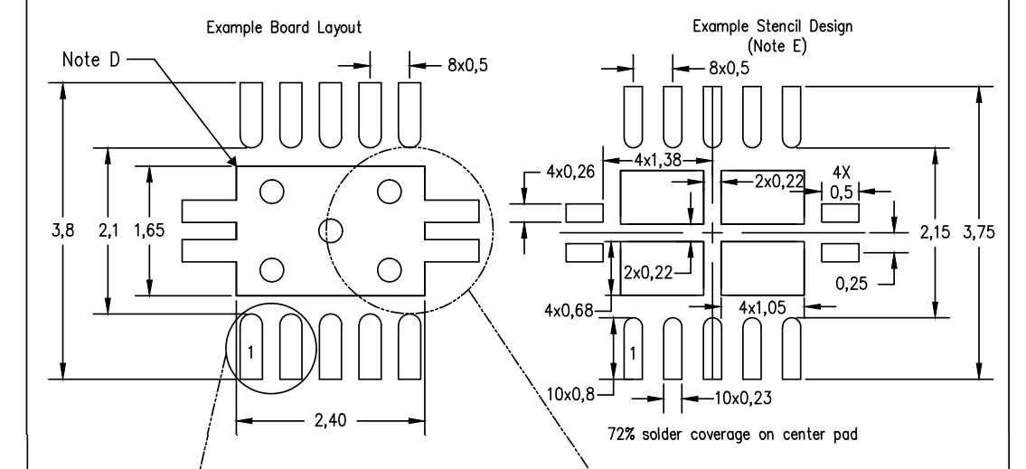

I got pin-to-pin shorts when hotplate soldering my OPA1622 boards, because there was too much solder paste on the heat spreader pad beneath the center of the package, and because the solder paste was too close to the edges of the PCB copper. Somehow it splashed or flowed or wicked over to other pads. Redesigning the soldermask layer (which my stencil vendor uses to create the stencil) improved this a lot.
Attached is TI's example stencil layout. I found that 50% was better than 72% for highest soldering yield -- but I didn't run long term reliability experiments on finished adapter boards, making the OPA1622 pump out datasheet max current while operating at datasheet max Vcc and dataasheet max temperature.
Hi Mark, exported at higher DPI.
And nice insight! I think I could adapt the soldermask [tCream, gold] and solderstop [tStop, gray] layers to be a bit more narrow (assuming the fab can produce it). Attached is the original variant of the VSON10 pad from the eagle texas library.
Edit: Whoops, seems some things went wrong when I resized the board and moved it around. Updated the attached image to contain no obvious errors ;-)

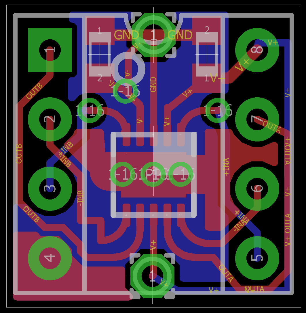

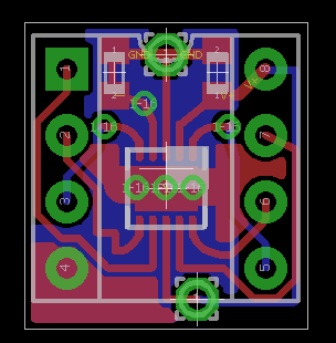

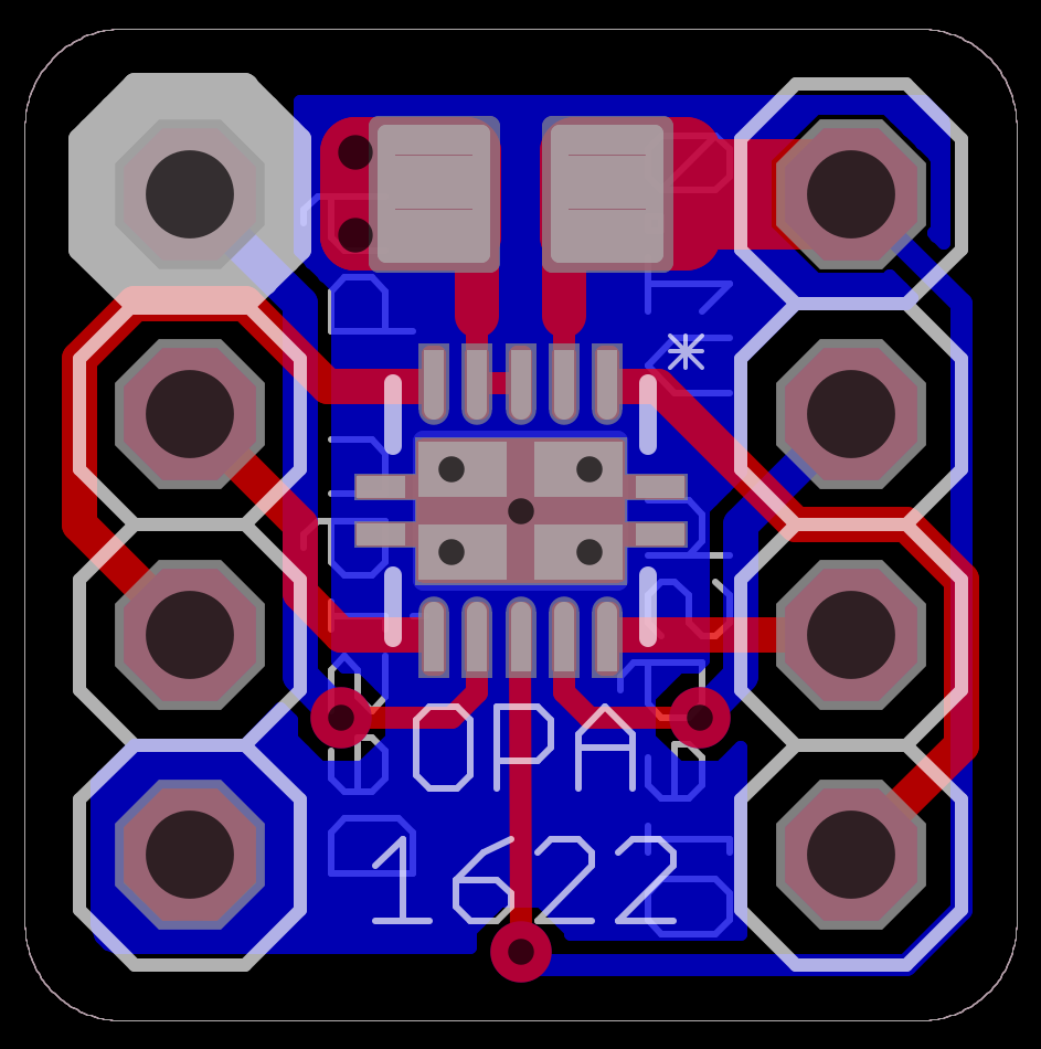

Attached are the finalized layouts of simplified and full featured adapter PCBs. Archives contain the gerber files.

just a little observation on both ArchimedesMP and Oleg's designs.
pin 1 for the dip8 on Oleg's has a full silk screen over it and i dont think the fabricators will pass it. also you have radius corners, the fabricators will want to panellise the boards as they are so small.
the orientation indentation semi circle for the dip8 on ArchimedesMP board is the same as above as it runs over a pad (GND) as does the bottom line (V+).
I used such pin marking with silkscreen over the pad on my other designs produced by PCBWay. They never complained and PCBs were always fine. As for the panelization I would suggest not to use V-score since it is not precise and the groove can cut into the trace or pad. I would go with the CNC router cutting leaving small "bridges" between the boards instead. I think manufacturers can do such panelization on their own if you ask for it. In this case rounded edges are not a problem. Anyways, if someone decides to use the attached designs and needs them modified one way or the other just let me know.
