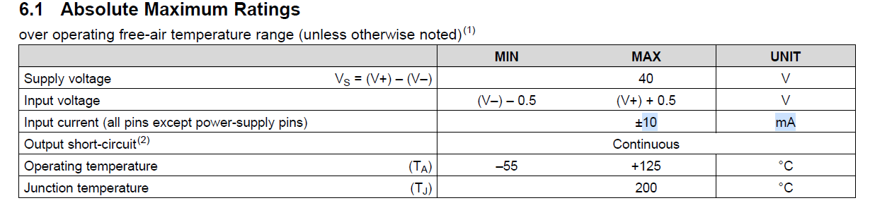

There is a difference: unlike those in the OPA1611, the diodes of Hans are not in a common substrate with the op-amp, so any current flowing through them cannot trigger latch-up.
Yes, but OPA161x datasheet also recommends that applications limit the input current to 10mA.
The fact that this chip fails on other implementations as well does not prove that your design is flawless. It only shows that the failure mechanism is not understood yet, otherwise there would be some work-around designed in. I got the impression that you are not really interested in a work-around that touches your highly experienced pcb design but better blame TI for the hidden flaws inside this chip.
Assuming the problem is latch-up, and not a random chip failure or some circuit design issue, big external diodes may help to divert the current from the chip and may therefore make triggering more difficult.
By the way, that 10 mA is probably related to electromigration of the wiring of the internal diodes, which is a long term reliability issue. Chances are that much higher currents were used for latch-up testing, 100 mA at the maximum operating temperature is a common target.

Assuming a electrostatic discharge triggers a catastrophic latchup - you have two options
1) Keep the trigger impuls off your pcb. I have some experience on this topic and can say this may be very difficult due to the nature of such pulses. Typical ESD pulses have amplitudes of several kV at rise times of 1nsec giving current rates in the ballpark of 10amp/ns. These incredible current rates generate a 10V voltage spike along 1nH - something like 1mm of wire. It is evident that there is no practical way to shunt these even with big SMD MLCC cap or with any clamping diode. All you can do is insert some series impedance that reduces current amplitude.
2) The electrostatic impulse has little energy content and is not destructive per se. It becomes destructive with a powered chip when the pulse triggers internal parasisitc thyristors. If you limit the supply current below the latching current, current flow will stop immediately after triggering and nothing is burned. I propose 47Ohm SMD resistor in each supply line of each IC with local blocking caps of 10nF.
