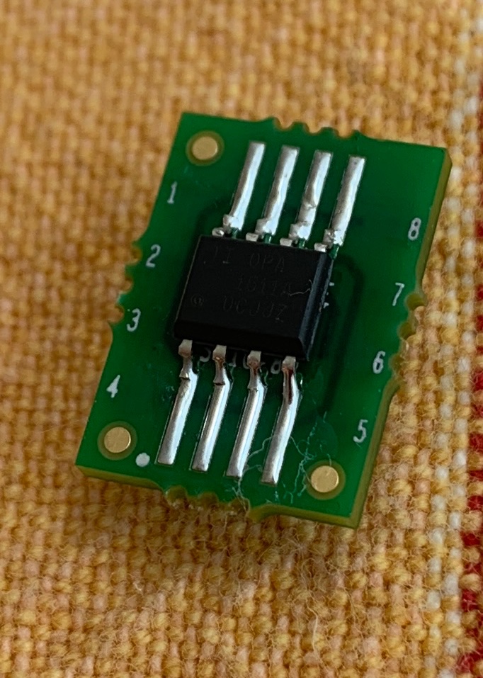

OPA1611 from eBay

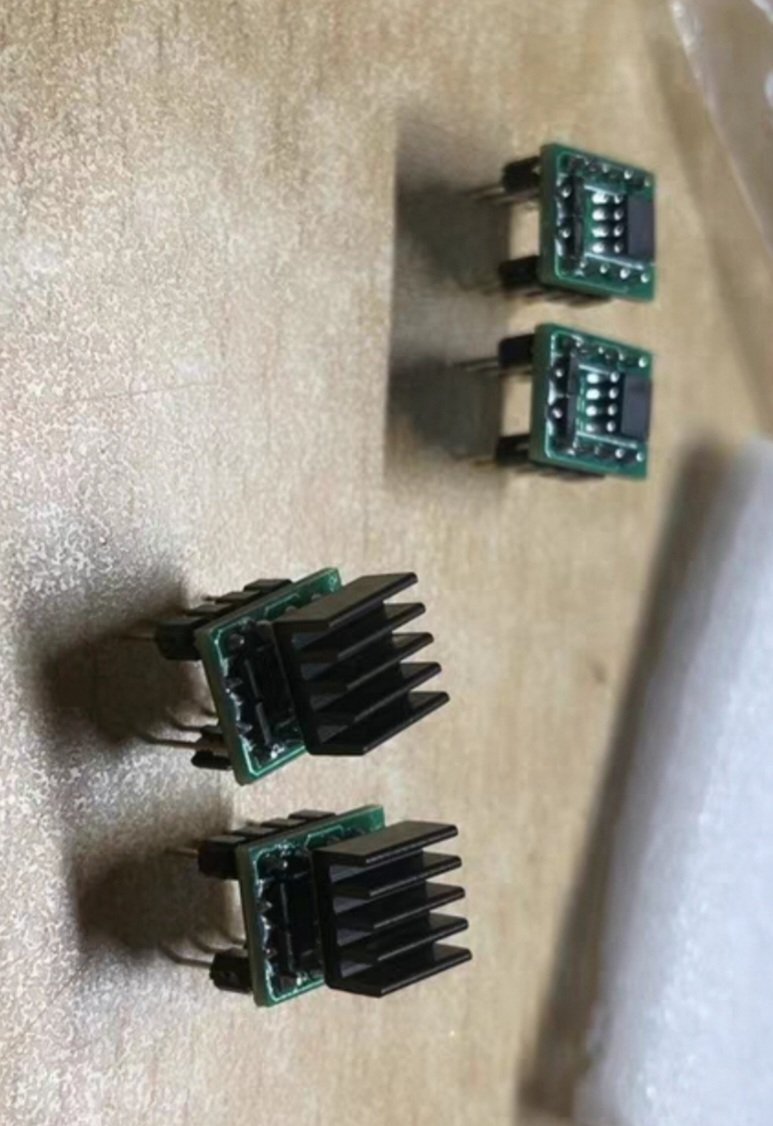

Some random pics I found online, heatsink mounted.
And even those heatsinks are not enough for high quiescent current at +/-15V. That 200mA figure is probably based on peak output current. If we look at the Whammy preamp, and those big coolers needed for 60mA quiescent current, everything is clear. In my opinion, A class or AB class is less important if it sounds good. The opamp is definitely class AB unless the mosfets are on the output with their huge input impedance. For the higher resistance of the next stage, which is usually 10k or more, it will probably always be in A class. For headphones 32ohm it will work in AB.

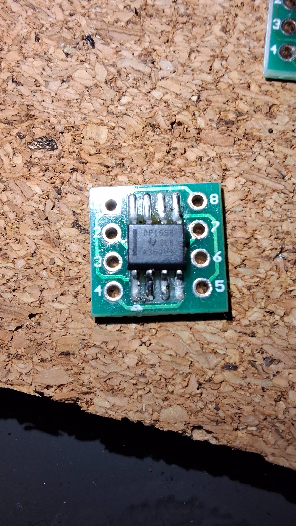

There's no reason for either of those.
Add solder to one of the corner pads. Heat up the solder and set the IC down into it. Make sure it's centred properly on the footprint. Then solder the remaining pins. Solder already has flux in it and there's really no need for more.
If you do drown the part in flux, make sure you clean it off after if you want the full performance.
Tom
I use a flat soldering tip for SMD, which I have been using for years quite successfully. I have a hot blow gun for desoldering SMD parts. It all goes easily and quickly, and the joints are flawless. Flux leftover is easily washed off with Isopropyl alcohol. I see no reason to do otherwise.

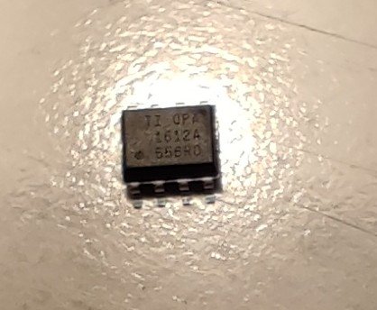

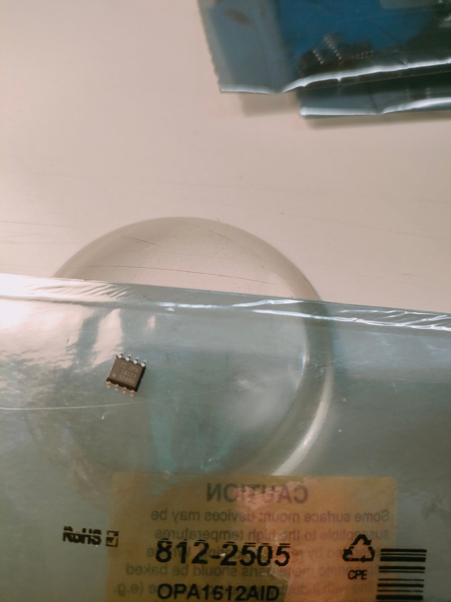

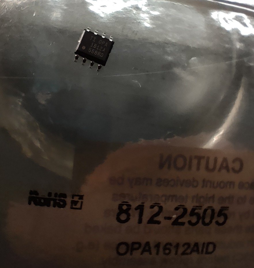

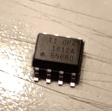

good morning guys, for information purposes, I send some pictures of the ORIGINAL Texas Instruments OPA1612 ( seller RS). Un saluto to everyone. Ros
