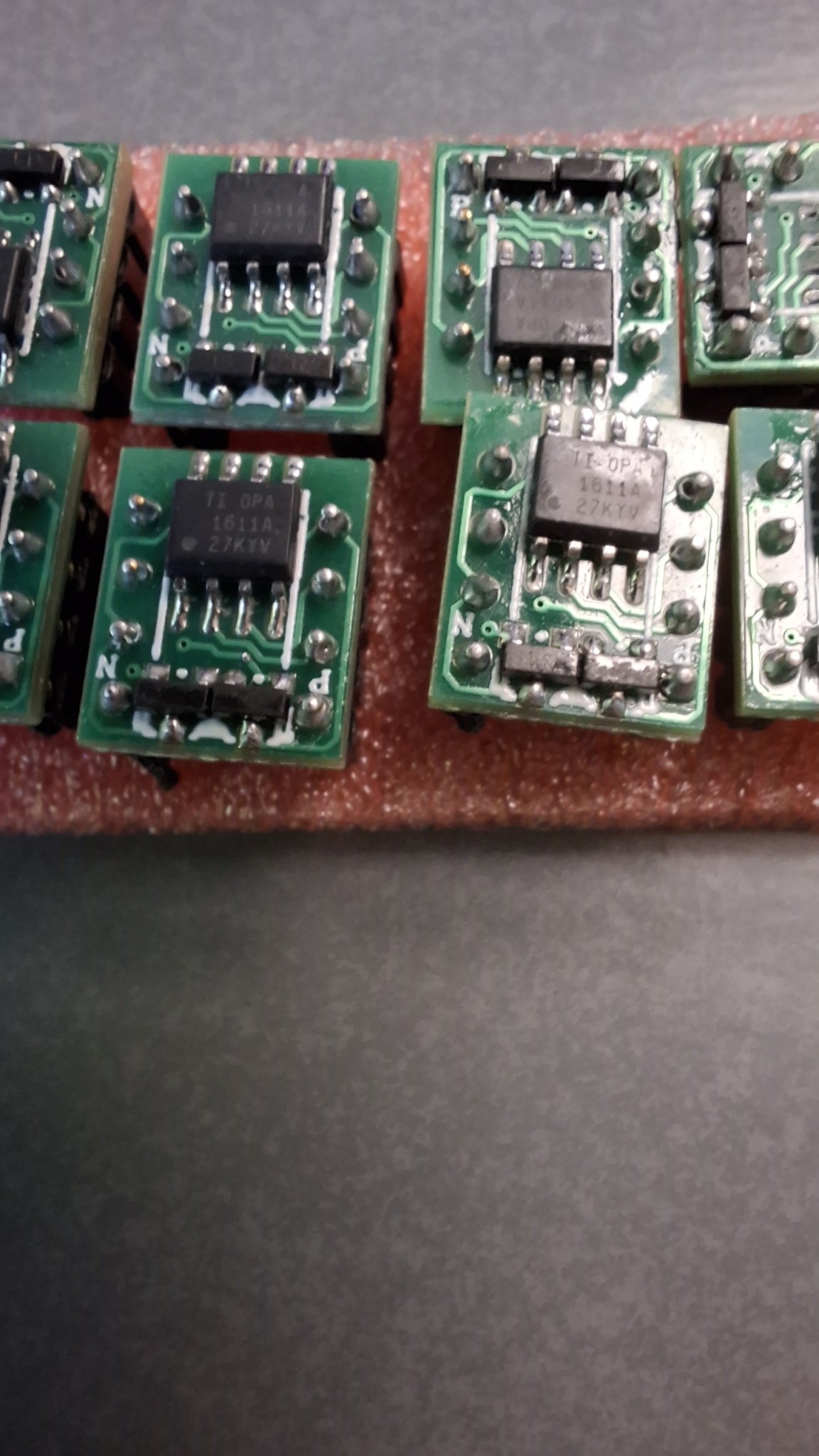

I just wanted to test it! They're genuine Mouser!
This fake/real talk annoys me.
Someone keeps coming up and claiming everything is fake! Whether they know it or not! Just like everything from China is supposedly fake, that's not true either!
Since I started using the OPAXXXX Soundplus, I haven't noticed a single fake. Even on eBay, I've only gotten genuine products.

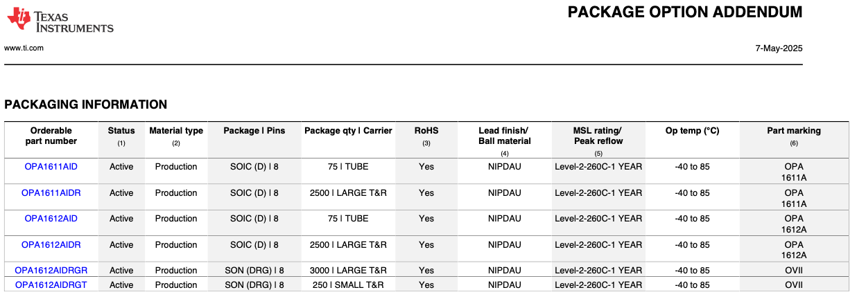

Is this an original OPA1656?
That's what the ones i bought from Mouser look like.

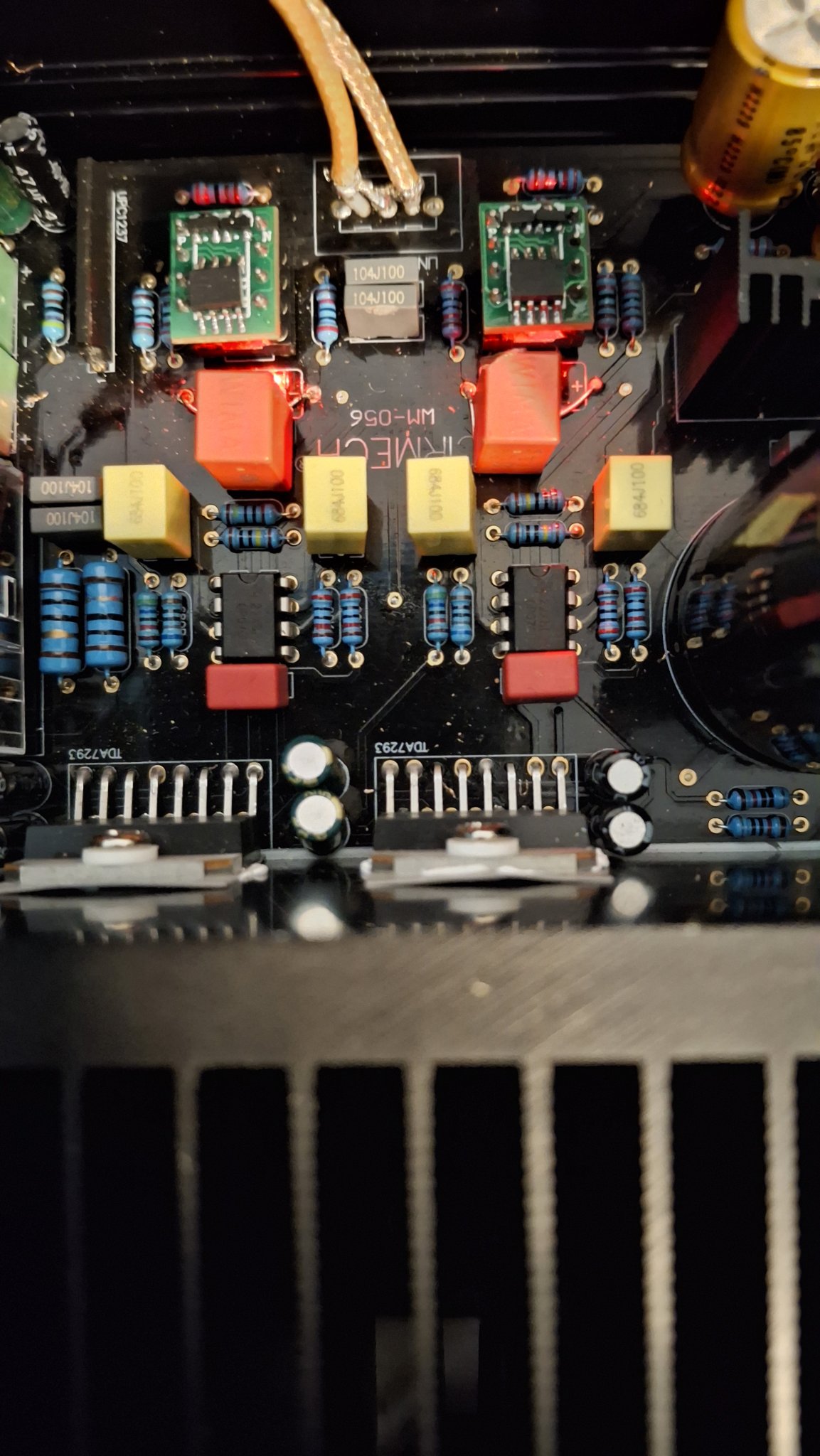

All mentioned opamps are unity gain stable, so it won't oscillate. However, when the schematic is expanded with an additional output stage, this may change. I have published here on the forum the results for one copy of the Whammy headamp. Various opamps, various compensations and anti-oscillation measures. Some opamps work without the need for interventions. In my Whammy headamp, so far the OPA2604, NE5532 Signetics and Burson V7 Classic work without problems. I just take one out and stick the other in. When I move on to other opamps, I'll definitely need to play around. On the previous copy, it was the 1612 that gave me the most problems with wild oscillation (and it is not from China, and the adapter is BrownDog). 🤣
opa1656 works on my ha1452w adapter, but since it's replacing a dip-14 there was plenty of room for some 10pf caps across the feedback loop and an 0.1uf across the power pins on the underside.
Of course, those SOIC to DIL adapters increase chances of oscillation, if only by increasing parasitic capacitance on the non-inverting input and between output and input pins. You get what you ask for.
Jan
So I had no choice, the Whammy design was done for a DIP8 opamp. That same OPA1612 on adapter didn't give me any problems in the second preamp. Everything is finished with compensation capacitors of 22pF to reproduce the square signal perfectly.

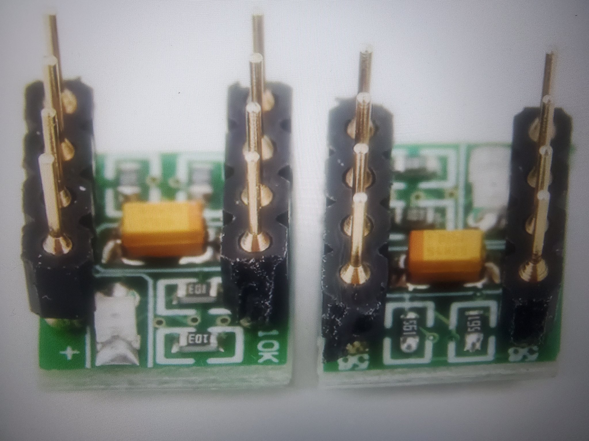

You may think I'm crazy, but I buffered the Chinese op-amp again with 4.7uF MKS capacitors on pins 3 and 7, and this capacitor actually improved the overall impression in detail!
