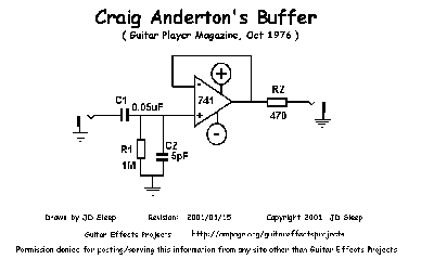

Actually I need to build just a buffer circuit for a guitar and not replace an opamp in a device.
I am currently hoping to build the buffer around the BB OPA134 but since I need this buffer to be as transparent as possible I was going to build a test circuit to evaluate as many opamps as possible.
I need a gain of 1-2 but mostly need the impedance of the guitar pickup to be changed and be able to drive a LONG cord with low noise.

If you want a good buffer chip, try something like the OPA2604 which is high input Z and can drive long lines easily.
Or go hog-wild and get one of these chip replacements: http://www.lcaudio.dk/com/ad8065.htm

You can parallel two opamps.... what you get out of it is increased current drive. Typically, a small value resistor, 10 - 50 ohms is inserted on the output of each opamp before they are combined to the signal output. This insures that the opamps share the drive more equally.Can you parallel two opamps like that with direct connections?
regards, Jack

Parallel opamps has no advantages to the buffer in this application. Sure you get more current, but it is unecessary. Furthermore, you increase the noise level which would be amplified few hundred times later in the amp.
Something worth tweaking, try biasing the opamp into class A. It has been done successfully with audio circuits, and I believe it could do some miracles for guitar buffer too.

Well I grabbed a 741 OPAMP from radioshack to play with until the OPA627 arrives.
I did not see any method of biasing the opamp..
Any suggestions?
Can the OPA627 be biased class A?
What OPAMP would you recommend as a buffer biased class A?
And sorry for the questions, but does an opamp biased into calss A require a heat sink? I could glue on to the top of the package maybe...

Try this link for more information:
http://www.diyaudio.com/forums/showthread.php?s=&threadid=38984&highlight=
Basically you connect a resistor between the -ve supply to the opamp output. The preffered bias current is between 5-10mA. Lets say your -ve supply is -4.5volts, and you want to bias it to 10mA. Just use R=V/I, you get the resistor value of 450 ohms(470 preferred value)

Using a pair of opamps in parallel will actually decrease the noise by about 3dB due to random cancellations... four opamps in parallel would reduce it even further but that's about the practical limit.Parallel opamps has no advantages to the buffer in this application. Sure you get more current, but it is unecessary. Furthermore, you increase the noise level which would be amplified few hundred times later in the amp.
I don't see any reason to try to force the opamp into class A operation since this cuts the available clean headroom in half... though it certainly is a point for experimentation. 🙂
rabstg, there are some practical examples of buffers on my site at:
http://www.muzique.com/lab/buffers.htm
