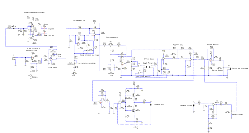

What about your schematic? Could I see it?

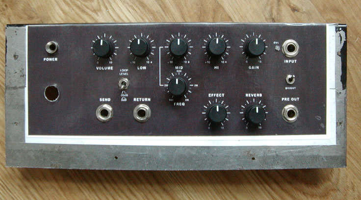

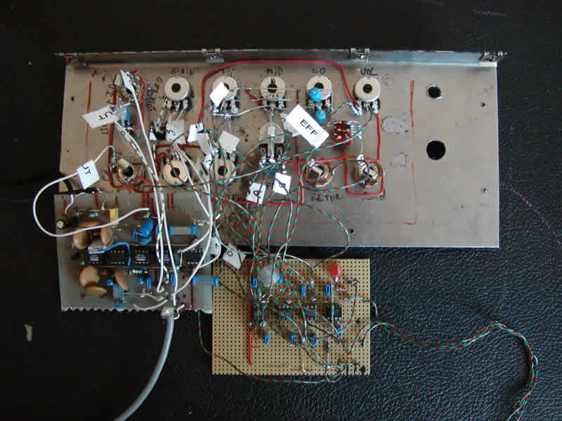

I have allready my amp running as a prototype. Need to layout a PCB for it.

No schematic yet
I'm pretty new at designing my own gear but I'd have no problem sharing the schematic once I have everything sorted out.
I'm basically combining some of my favorite individual cirtuits into a pre that I will later add an amp to. Next I'll build a head case or possibly a combo cabinet for it.
Looks like a really good pre you built there. If I'm right it looks like you have active op amp filters which I'm just recently really interested in. When I had spotted this pre on the other page I was assuming it was tuibe based. Tube is great but I've heard some solid state sound just as good.
