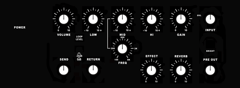

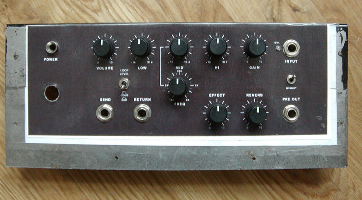

BTW: I'm designing my own guitarpreamp at the moment.
- Peter
