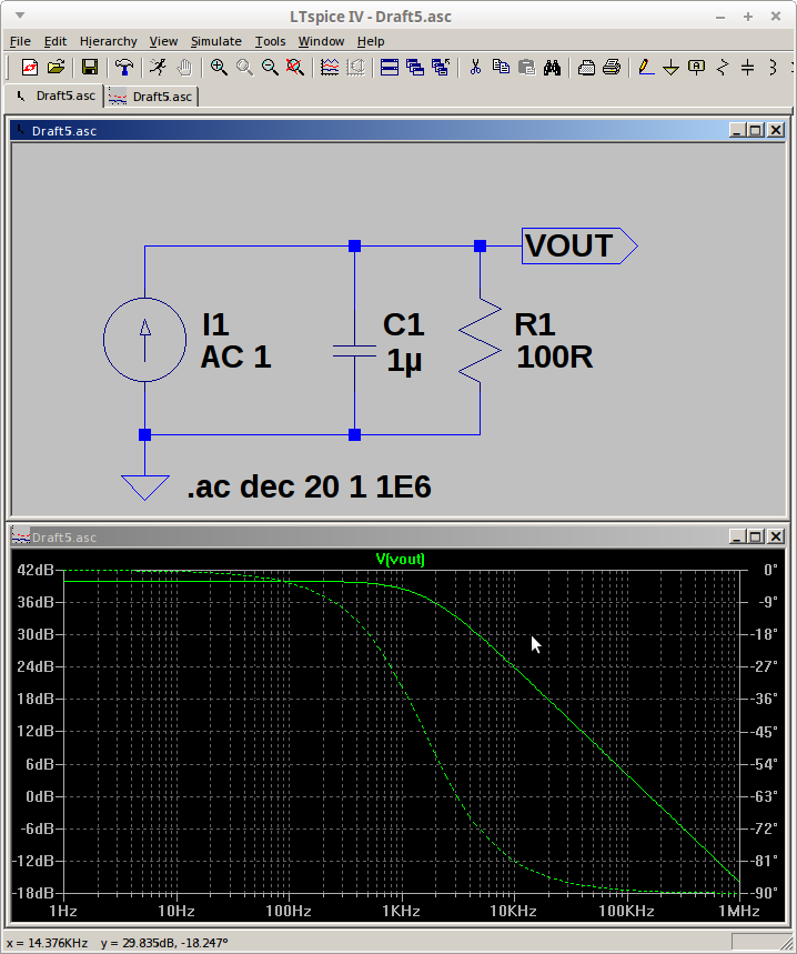

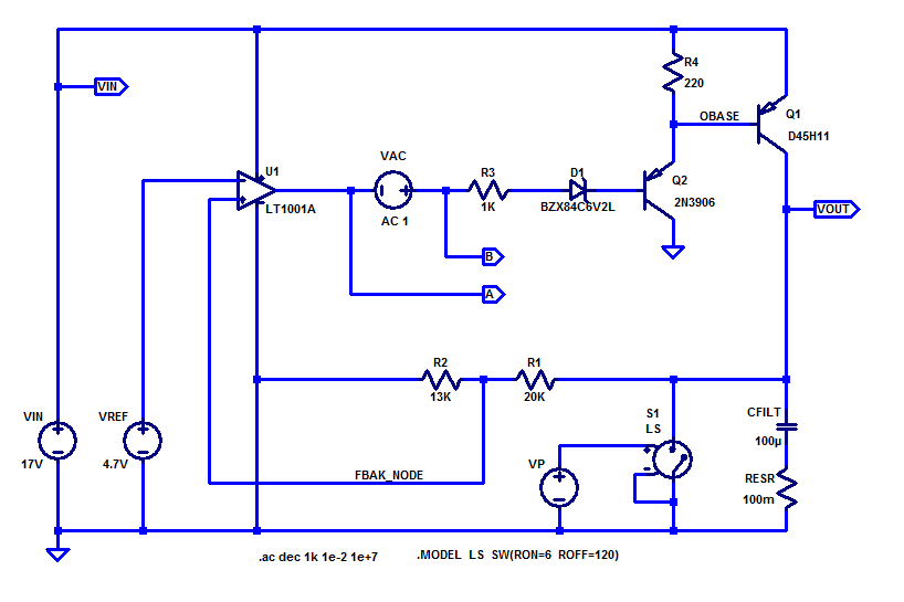

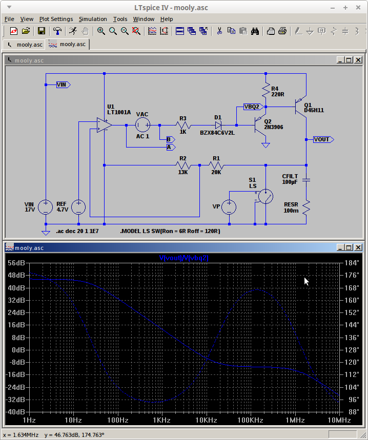

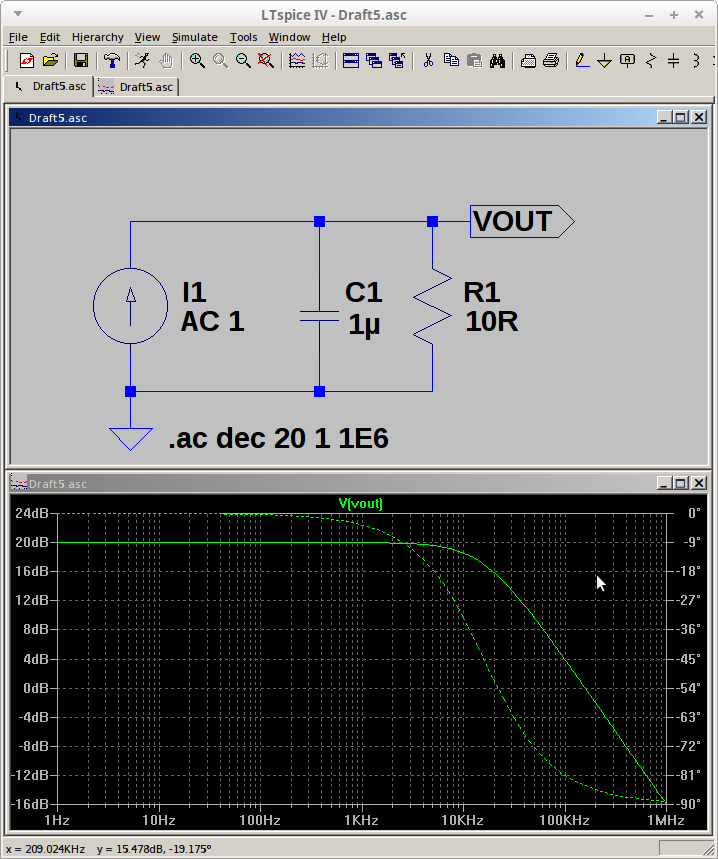

Is C1 an ideal capacitor or a model of a typical electrolytic capacitor?
Good question 🙂 If you look at the image above your post you will see the symbol of the cap is different... its a 'real' one 😀 with 1 ohm E.S.R.
I looked into this and tried several different types including ideal PLUS a series resistor. All seemed to work well.
I had noticed the different symbol, I just wasn't sure what it stands for. I don't use LTSpice very often.
If I understand it correctly, you use the ESR for frequency compensation, so C1 is not allowed to be replaced with a film capacitor or a low-ESR electrolytic unless you add an extra resistor. Is that correct?
That's pretty much it, yes.
This shows an ideal cap vs ideal plus 0.1 ohm. The spiky nature of the output voltage is simply the very noisy raw supply reflecting into the result, however the voltage scale puts the absolute amplitude into perspective. The ideal cap is tending toward high frequency instability. An ESR of as high as 5 ohms was still OK.
Under stationary sine wave excitation you can substitute jω for s, but you don't substitute j for s. That is, XC = 1/sC, not XC = 1/sωC.
Thank you for the correction.

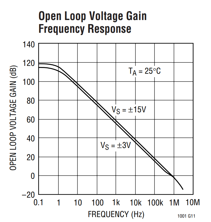

2 poles at 'DC'. One due to the op-amp one due to the D45H11 driving the output capacitor. ESR zero just above 10KHz.
I'm not seeing any poles at 'DC' ; Instead I see the first pole at 1.1 Hz, which coincidentally is very close to the opamp's pole frequency: datasheet figure attached.

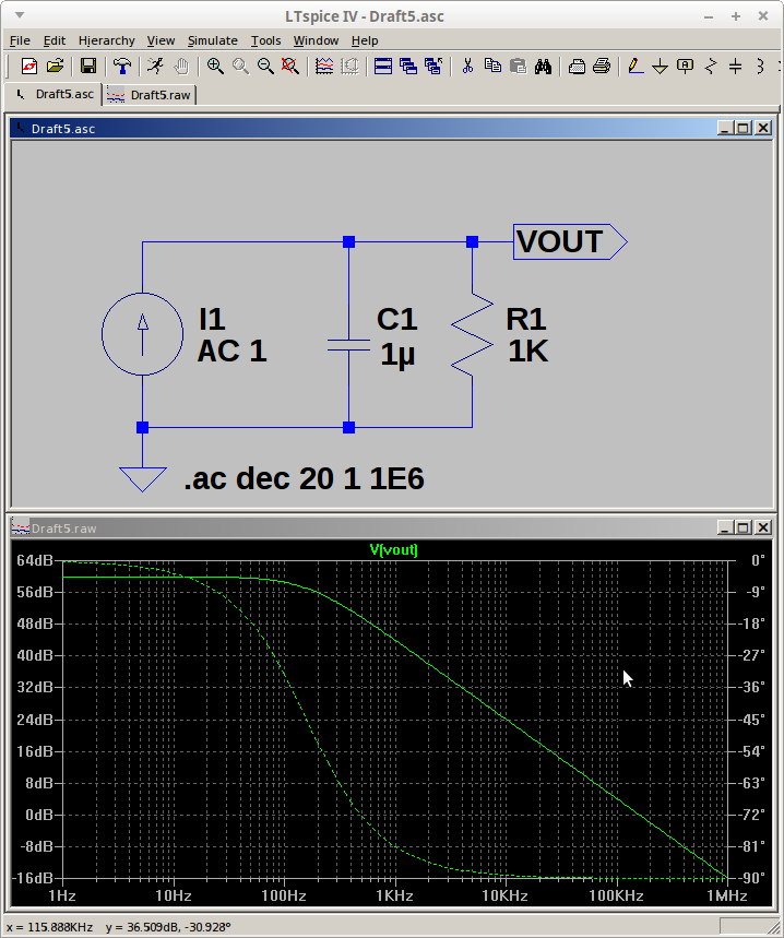

Let's define DC as being Don't Care frequencies. Obviously you do care about their effects at higher frequencies, in particular at crossover, but...
Picture 1) Don't Care.
Picture 2) Don't Care.
Picture 3) Don't Care.
The poles are at different frequencies but crossover occurs at the same frequency and the phase lag is at or is approaching 90°.

Oh... Yes you are seeing the op-amps pole frequency. The other pole is due to the Darlington driving the output capacitor. The wrong term would be its output admittance which, in effect, appears in parallel with the output capacitor via the input supply.

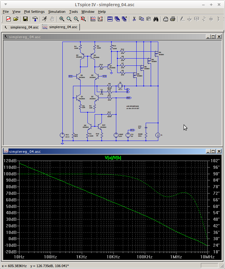

I think most linear regulators are inherently unstable, its the nature of the beast, but what surprised me here was just how 'resistant' this one was to various measures thrown at it. That's why it needed a re-think.
So...

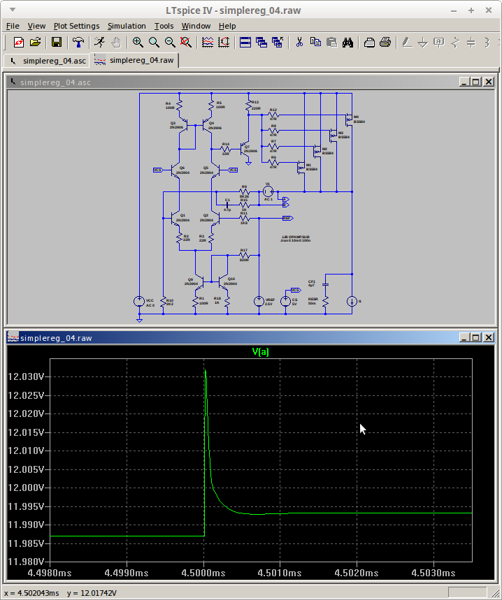

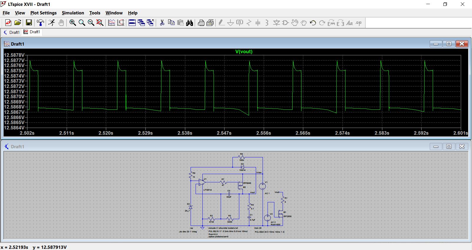

In post #1 mention was made of having a P channel power FET available. So lets use it. This allows two advantage to my way of thinking. The 'level shifting' zener can be dropped thanks to the higher Vgs needed to get the device to conduct (compared to traditional Vbe for the transistor) and most importantly, it relaxes the current demands on the opamp output which would be unable to support more than around 15ma. That's important for high load currents if we used a single series pass transistor.
To tame the stability we now have a small electrolytic on the regulator output. The feedback network also has a small cap added that seems to help under certain conditions.

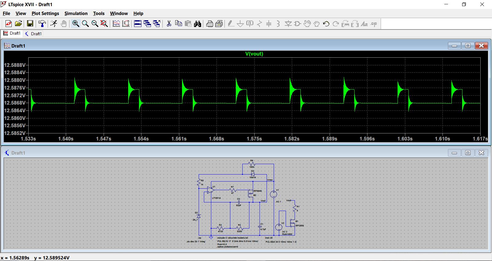

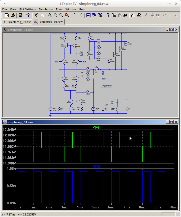

This shows the output voltage (set to 12.6 volts) and a new 'noisy' raw supply which has both significant impedance and also simulated ripple superimposed on it.
The second graph shows the ripple at a transition where the load current is abrubtly applied.

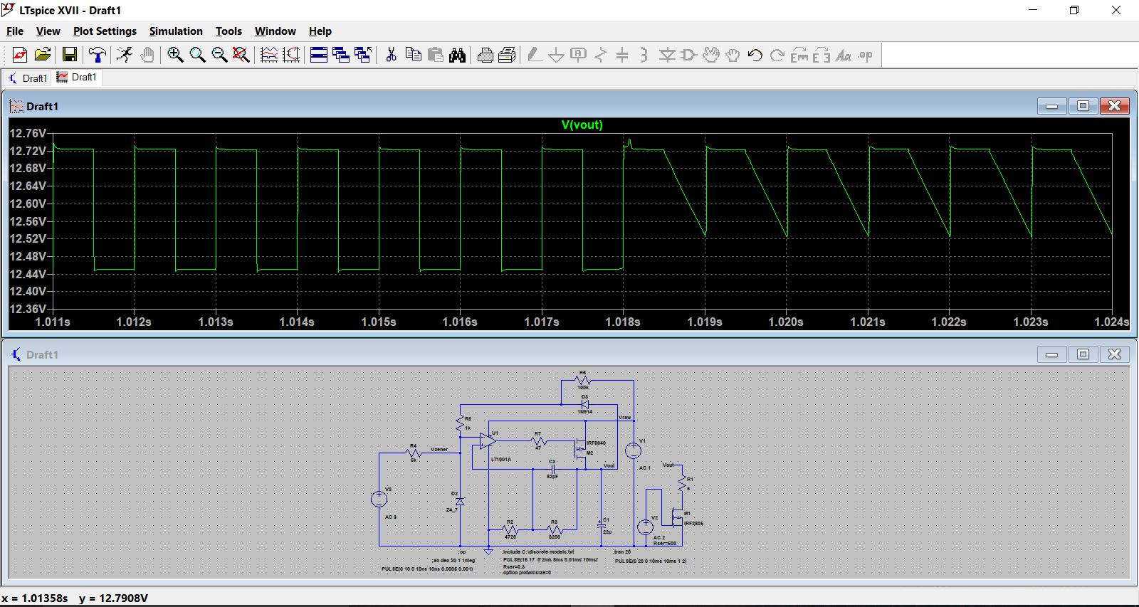

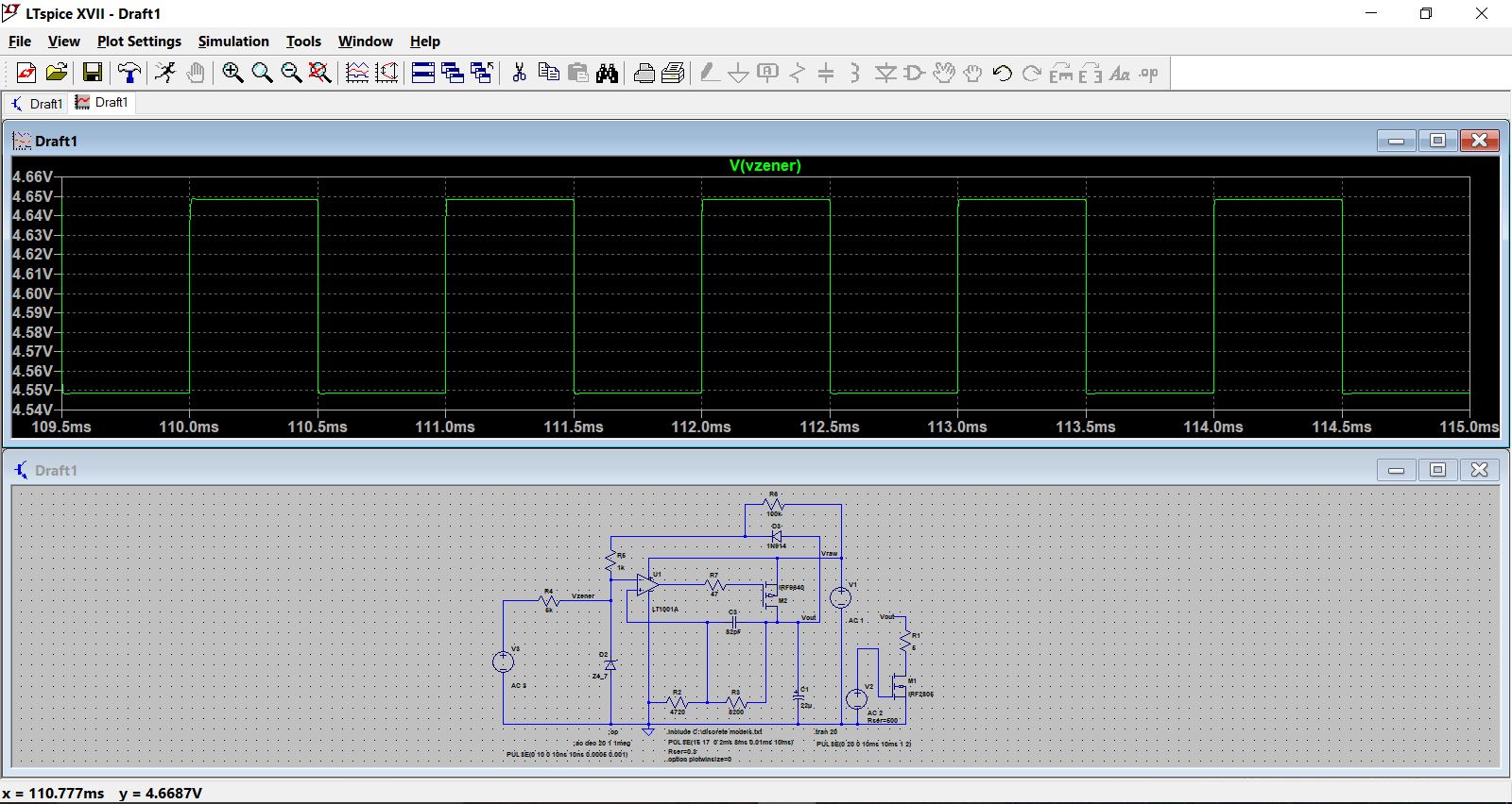

Can you inject a low-frequency square wave somewhere? Oscilloscopes often have a built-in square wave oscillator for probe calibration. The response to a small square wave injected at the reference or added to the load current also shows you whether the stability is good, marginal or non-existent.
A 22uF electrolytic seems fine in simulation. A 22uF ultra low ESR or similar showed a tendency to instability.
This is using Marcels idea of modulating the reference with a squarewave. Shown is the zener voltage and the output voltage at the transition between full load current and no load current. Last shot is the load current. This is with a 22uF cap.

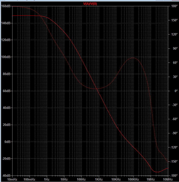

It's a shame to see MorbidFractals excellent practical demonstrations of reliable oscillation-free power & control loops ignored like this, in favour of arbitrary methods of stability testing.
Closing the loop around an op-amp-driving-a-power-transistor without checking the phase margin is like flying blind.
A circuit may appear to be stable at first measurement, but all kinds of things that affect the open-loop gain (temperature, sample-to-sample variation of transistors, load current, reactive loads etc etc) are likely to change in real life, and between one person's build and another.
Unchecked, uncompensated designs are highly likely to go bad a some point.
But if your circuit has, say 40-90° of phase margin, you can build with more confidence - and preferably do some practical testing.
Using the LTSPICE circuits that MorbidFractal has offered generously, you can explore all this. Look at the phase shift between A and B on his .asc files, especially as the gain approaches 1 at higher frequency (the « crossover » 0dB).
If anyone has not studied control systems, and does not know what "phase margin " is: try to read the "frequency compensation" paragraphs in Horowitz & Hill.
On the other hand, anyone not wishing to learn and measure, but just build a prepared design would be better served by using one of the circuits he presented that show good phase margin - including the one with the opamp (post 76), if desired.
