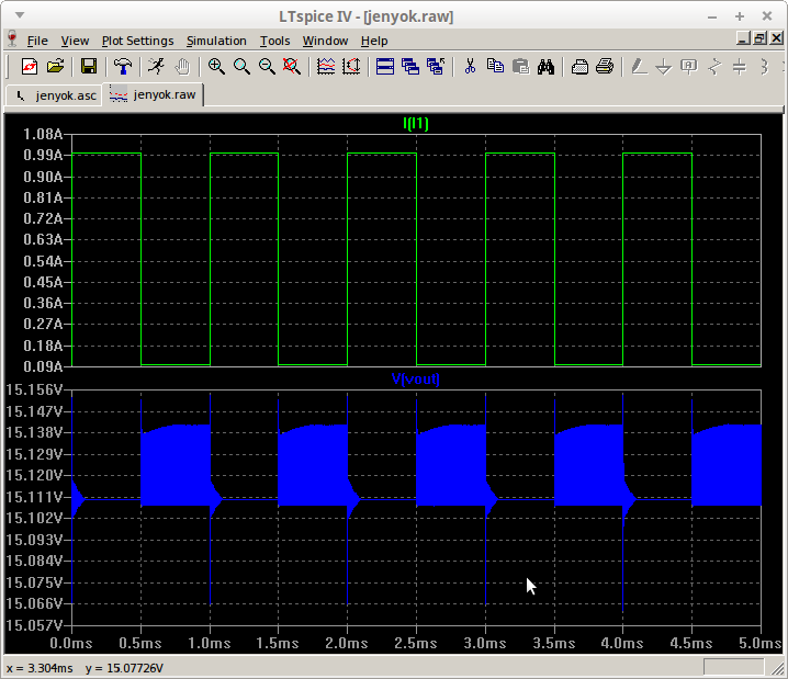

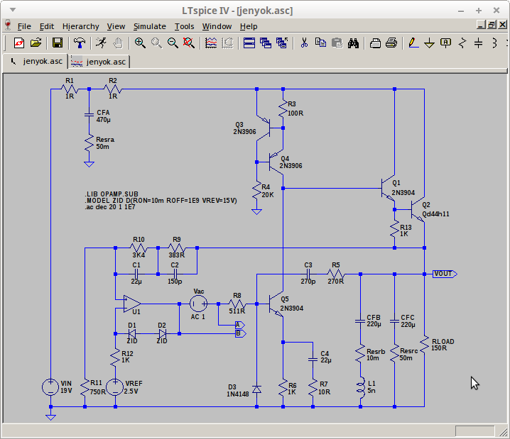

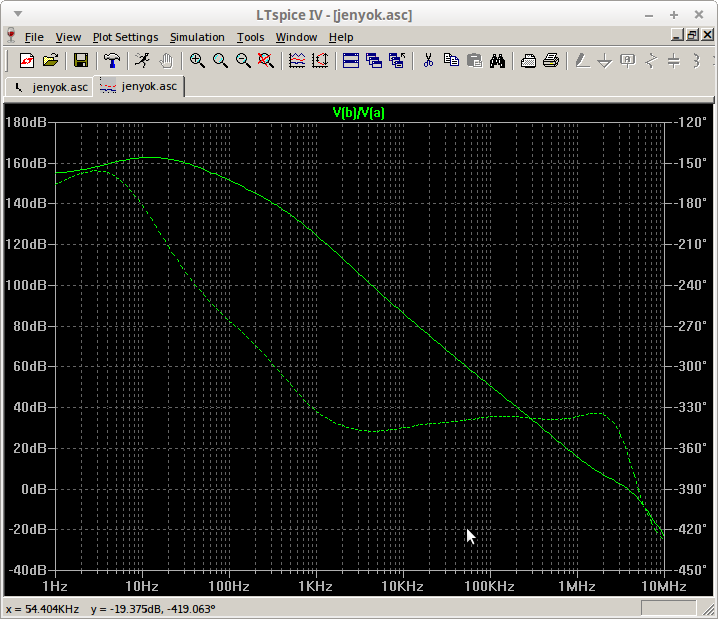

No it is not. It is an Oscillator!
Picture 1) Circuit.
Picture 2) Loop Gain.
Picture 3) Transient performance 100mA-1000mA @ 1KHz
Why do you replace the D44H11 with a 2N3055 and assume the 330 uF to be perfect?
Closest model in a 'base' LTSpice install. The original circuit used a perfect 330uF capacitor.
Here, now with D44H11

Picture 2) Loop Gain + Phase
Picture 3) 100mA/1000mA 1KHz transient response.
Morbid,
look again at your gain/phase plot.
See the change in slope of the gain curve @ 1MHz to 5MHz.
A small change in component values will move that steep part that crosses the 0dB line to a better location and make the circuit stable.
Small changes in device models would be enough to make this circuit stable. Your sim is not proving the circuit is unstable, it is proving you have deliberately massaged the selection of device models to make the circuit perform badly.
I am sure you have the expertise to show what changes are required to make this stable and with adequate phase and gain margins.
Giving that extra information would do your reputation a lot more good than stopping with post 45.
In the documentation as well as here in the thread we have repeatedly made the case to use an output cap with some ESR, NOT a boutique film cap but any lowly electrolytic.
Replacing a D44 with a 3055 and expecting similar results is hilarious. A D44 model can be easily downloaded from the 'net if you take the trouble.
Please... I modelled the original circuit as presented with a 330uF ideal capacitance. Yes the 2N3055 was not as given and not as given when I included the parasitics provided later.
Do try to look at the latest model. It is using a D44H11 and is as close as I can get it to being as later presented so do not accuse me of deliberately massaging things.
Jan
Did you miss the part of Post #45 where I specifically state that I have included a D44 model?
It might be nice to have a 'discussion' but if you are not going to pay attention then there is little to no point.
It is weird that a circuit that apparently works well in real life oscillates in simulations, it is usually the other way around. Is there much difference between different brands of D44H11? There are huge differences in fT and collector-base capacitance between different brands of BD135, could we have something similar here?
A few observations that may or may not help to debug the simulation:
R2 is not in the original circuit. It could increase the impact of the reverse capacitance of the output and driver stages.
The input and output decoupling capacitors have different values than in the original circuit, but not much different. If that's enough to make the circuit oscillate, it is not very robust.
There is one part of the loop that still has a rather ideal model, the NE5532:

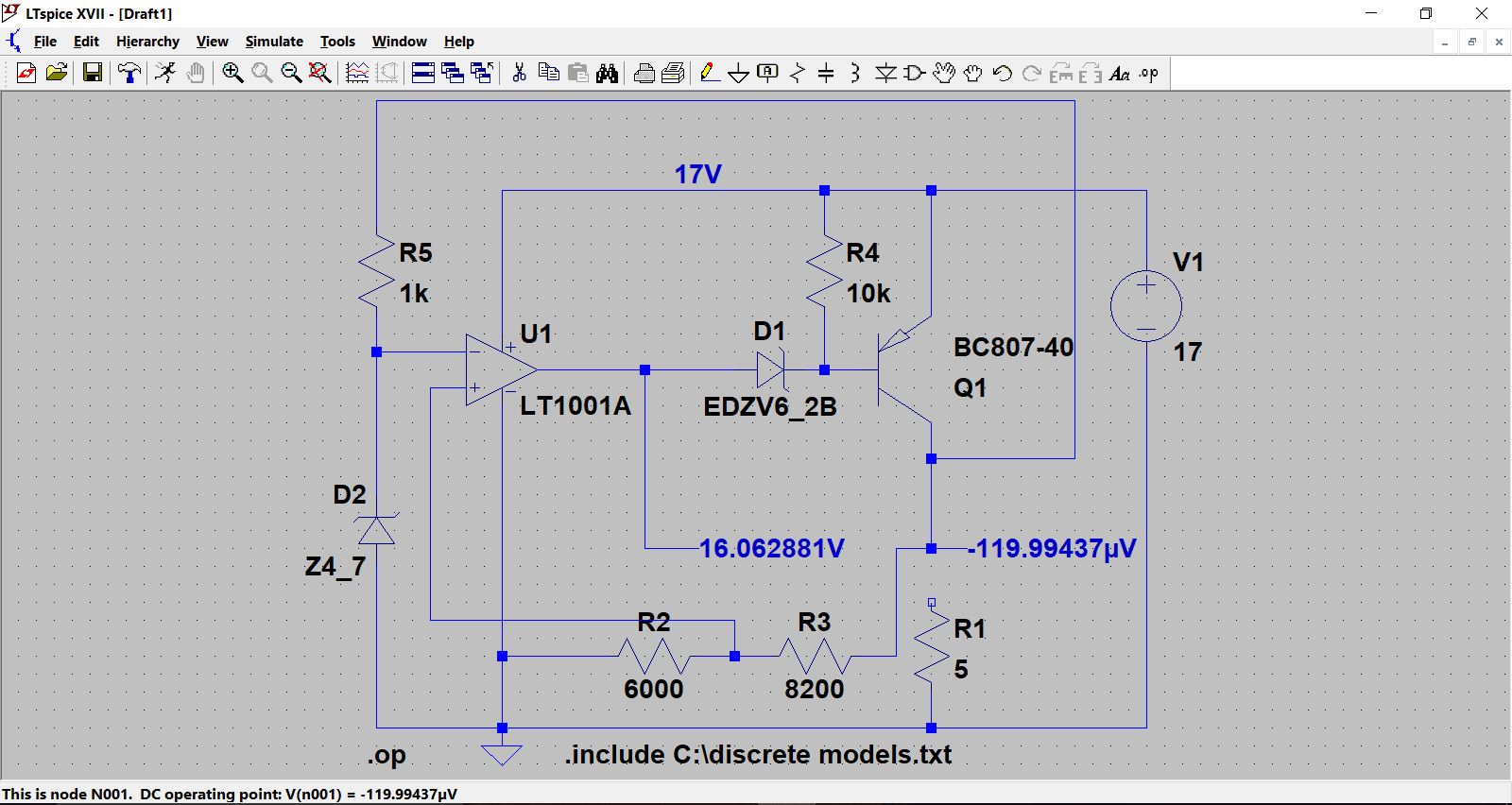

All, I appreciate all the responses to my original question. Mooly, I tried to reconnect the zener to the output and the circuit still failed to start with the capacitors. The capacitors did help. that circuit regulates to 90 millivolts across the load range of 10 to 50 ohms with the TIP42C. I do not have the equipment to check ripple, like an oscilloscope. I have read all the responses here and some of the circuits I do not have the parts to try the circuit. As I mentioned, I am a basement hobbyist at best learning the basics by trying things I read on the internet and in electronic circuit books. some are successful and others not so much. I do apologize but something are above my education level right now, but I am learning from folks like you. I do know I like the learning process.
Thanks....Mark
Thanks....Mark
Its good to hear you are having fun and enjoying all this 🙂
So... not starting up. Hmmm. That's a little unexpected tbh so lets try something really simple such as adding a high value resistor across the series pass transistor which should generate a tiny initial 'difference' voltage between the opamp inputs and so kick start things.
Try something like 10k initially, and if its OK work up in value until the circuit fails to start and then pick something midway... best empirical practice 😀
I suspect a different opamp type would not do this but see how you get on.
Out of interest I can actually get the circuit to fail to start in simulation as in the first picture. Second picture with a resistor R6 added, and here even 100k worked.
With the load R1 connected you probably need a lot more to get it to start.

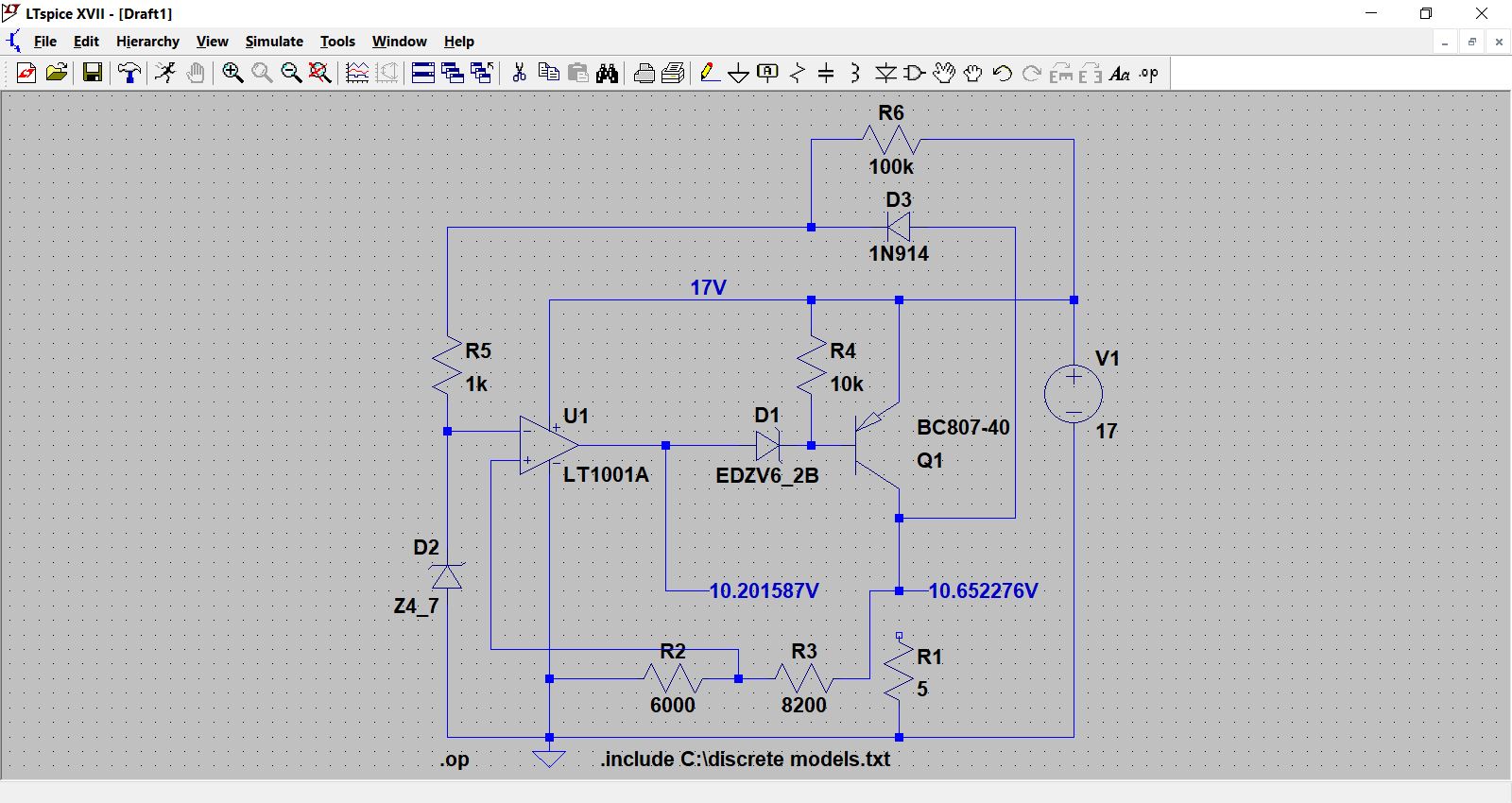

How about this?
-Connect a diode from the collector of Q1 to R5, anode tied to Q1, cathode to R5
-Add a high-valued resistor from V1 to the cathode of the extra diode
A load pulling down the collector of Q1 then can't hamper start-up. After start-up, it is the regulated voltage minus one diode forward drop that supplies the current to the Zener, so the PSRR should not be degraded much.
How about this?
Thanks Marcel 🙂

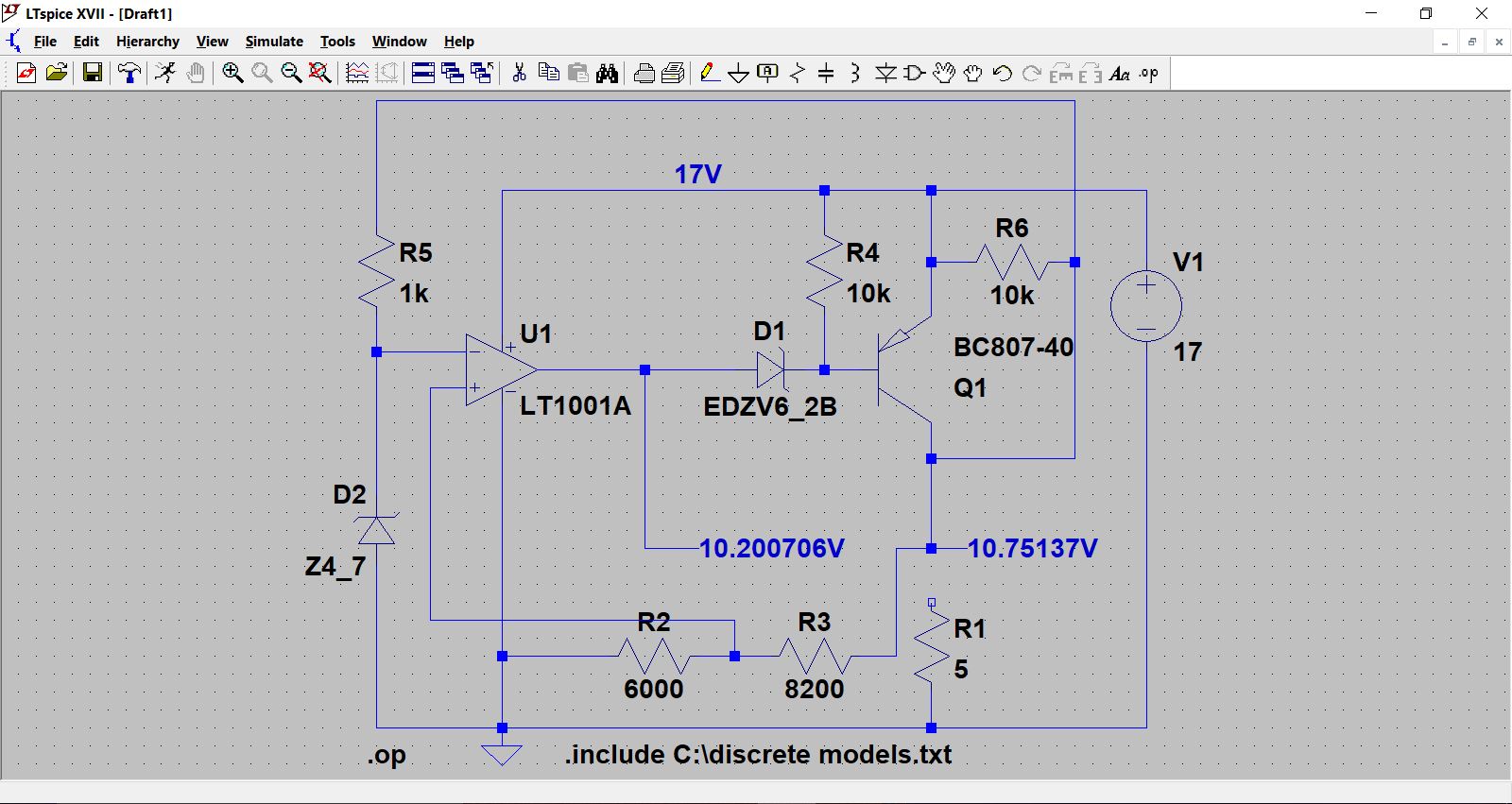

Curiously, the simulation only failed to start with no load attached. Also, different transistors worked OK which is very odd.
I think you mean like this. Adding just the diode (no resistor) also worked. The peculiarities of LTspice. Remember also the sim is using a tiny transistor to supply 2 amps to the load. Fortunately no hole was burnt into the screen 😀
I like your idea though, it should definitely work under all conditions.
That's not so strange: when a circuit has more than one solution, a simulator's DC analysis just more or less randomly converges to one of them. It's not a peculiarity of LTSpice, exceedingly expensive professional simulators have the exact same property.
The circuit you've drawn is precisely what I meant.
All, I will try this circuit in both configurations, Mooly & Marcelvdg with the resistor added and then the resistor diode. I managed to burn up a 741 and I don't know what I did. It is okay I know I am going to have these "occurrences". I bought 20 741's for $5 they seem to work better than the one i had. I can definitely say adding the capacitors on the output helped the regulation. There is only a 90 MV change between loads and hat is very tolerable to drive tube filaments. I do have two nte928 op amps. Also I have some TL061 & TL071's Jfets and I do not know how to make them work right now. They require dual rail supply (i think) and I do not have anything to power them right now. I am having fun experimenting. I am also going to work on a high B+ voltage regulator for the PAS, but i have to work on that another time. I only need about 10 MA total at 355 VDC and another one regulated at 210 VDC for the Dynamo PAS3. I am in no hurry. Again thanks.
