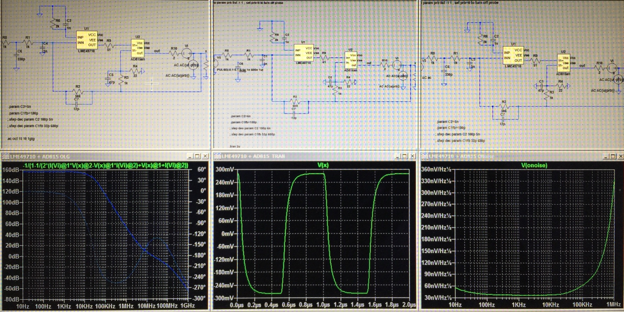

Thought I would start a thread on this topic. The motivation is a preamp with over 20dB of signal gain and lots of output voltage capability that can be used to drive unity gain amplifiers (specifically for me a MoFo).
I'm not all that technically skilled in discrete circuits, or in general with circuit design, but I know some basics of design and have worked up op-amp circuits in the past. Also, I happen to already have a bunch of PCBs that I could use to try out the circuit before making a dedicated one.
The idea I have in mind is to have a 2-stage op-amp gain circuit: the first gain stage using a conventional audio op-amp (e.g. OPA132/OPA2132) for 10dB or so of gain and the second stage using a high-rail-voltage op-amp like the LTC6090 for the remainder of the gain, and for its ability to work with high rail voltages (Vrail,max=140V!). Separate "high" (> +/-24V) and "low" (< +/-18V) rails power the two stages.
I would jump in and simulate this immediately, but simultaneous SPICE modeling of circuits that use a combination of Linear and AD products doesn't seem possible because models are not easily transferable between simulators. If this is not the case, I would like to know how to do it, please!
Before I dive into working this up in two separate simulators, is this approach destined to fail because of one reason or another? Is the relatively low GBP of the 6090 a concern? Should most of the gain be achieved with the OPA2132? Is this just a bad way to go about making a gain stage, in general, or can this approach work well when appropriate design rules are followed?

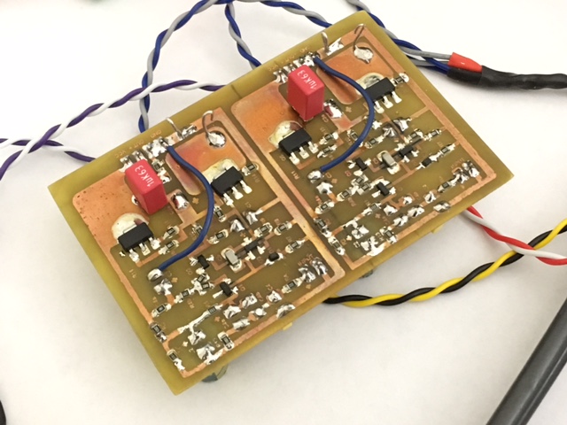

I built this preamp specifically with the MoFo in mind. It's 20dB, but doesn't use opamps. The performance with 6 actives exceeds an opamp though and output voltage currently is 40v p-p. It could be higher with a few adjustments in the LTP current.
AKSA's Lender Preamp with 40Vpp Output
I just tested it with a MoFo (sans inductor) this morning. Plenty of drive. THD of 0.002% is right up there with the best opamps.
Here is test with MoFo:
http://www.diyaudio.com/forums/pass-labs/313649-build-mofo-23.html#post5247923
The level of output of this pre allows me to drive the MoFo as loud as I want within limits of the MoFo and powersupply. It's quite transparent.
Here is the latest version of the preamp's measured performance at 20vpp with with 21dB gain. This is assuming a 7kohm load (MoFo is a much easier load at 200k):
Here is the preamp, uses single 48v supply. I made it in SMT but JPS64 made a through hole PCB layout specifically for the MoFo already.

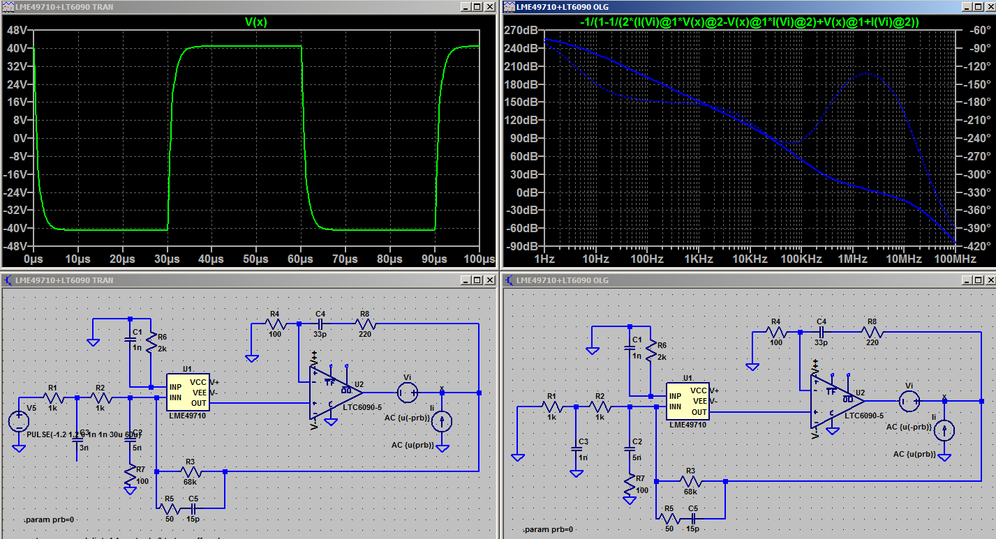

Charlie, I think you'll find that LTSPICE will gladly simulate any of its presupplied LT opamp models, with higher-than-datasheet power supply voltages. That's not an error condition the software checks for. An LT1498 will run just fine from plus-and-minus 60 volt supplies, and swing its output over 100 volts --- in simulation.
But you don't even need to mess with that. You can simply find an LT part which is a reasonable equivalent to the OPA132 and drop it into your simulation. You'll simulate with LT and build with AD. Such as: the LT1022 is an FET input opamp whose GBW is 8.5 MHz and SR is 23 V/usec. The OPA132 is an FET input opamp with 8.0 MHz and 20 V/usec. Pretty close.
So go ahead and simulate the first stage using the LT1022. Drop in the LTC6090 for the second stage. Hook up their respective power supplies, connect up their feedback networks, and go to town.
Me, I'm a bandwidth lover so I would choose the gains of the two stages in such a way as to maximize the end-to-end bandwidth. Keeping in mind that the LTC6090's bandwidth is (12/8)ths as high as the OPA132's bandwidth. Oooh! A quadratic equation! Back to 9th grade algebra class!
- G_overall = G_opa * G_ltc
- G_overall = G_opa * (1.50 * G_opa)
- G_overall = 1.50 * (G_opa squared)
- G_opa = square_root(G_overall / 1.50)
- G_ltc = 1.50 * G_opa

Thanks for the advice on the modeling approach. I will download LTSPICE and give that a try. For some reason I imagined a higher value for the GBP of the OPA132 - it's actually LESS than the LTC6090. Thanks for bringing that to my attention.

Do you need help with arrangement like this:
It's very hard to see due to poor photo quality and screen raster bit/fringe interference. Please use CTRL + Print Screen to capture your screen to a bitmap. Then save in "Paint" or other graphic program and upload as JPG or PNG file.
Within your sim program, there is usually a screen bitmap capture function. I know LTSpice has it and so does TINA.
Thanks,
X
Excuse me for my laziness.
http://www.diyaudio.com/forums/pass-labs/299645-common-emitter-ops-5.html#post5010335
Most of the info in graphs for easy of understanding, entirely nominals will be different, so there are only main idea.
First opamp doesn’t have local feedback.
