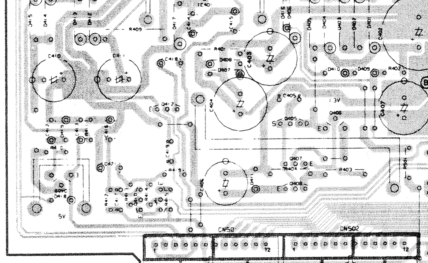

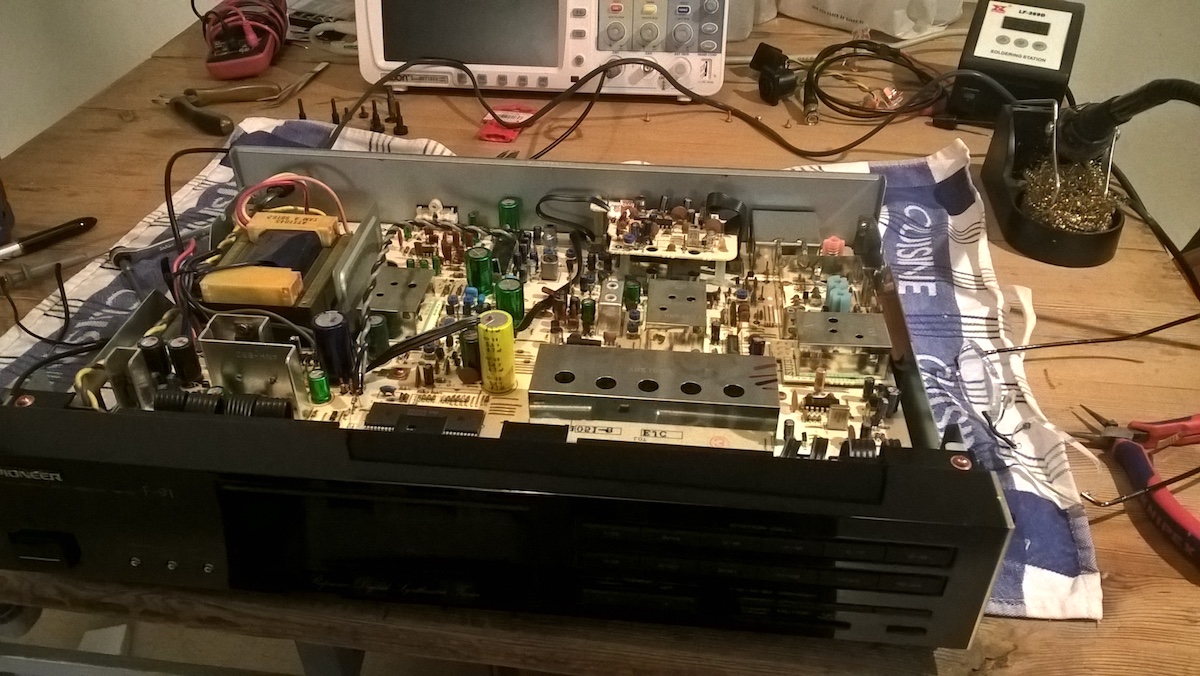

Please help me troubleshoot my beloved Pioneer F-91 tuner. There is just noise coming out all of a sudden.
Service Manual here.
Any help or advice appreciated!

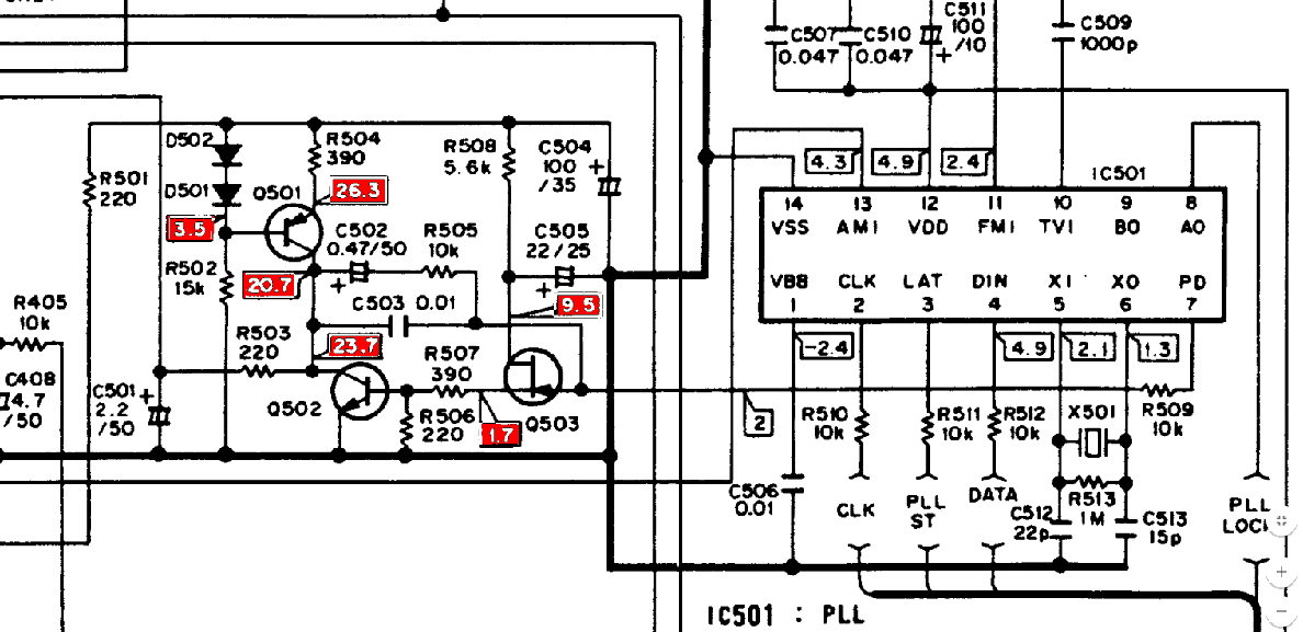

Jon, appreciate your help!
I could not immediately find C404 but the thing actually tunes and locks to stations. And in fact, behind all static I do hear a faint trace of the actual broadcast.
PS. The rec cal comes out clear.
