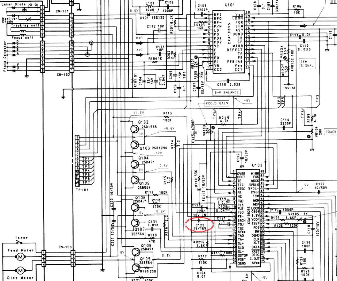

i found that the focus voltage coming out of the sony servo IC oscillates from -0.4v to -3.5v so it never goes into positive driving of the focus coil. the lens goes down and returns to original position, never goes up to reach focus point. -5v and +5v on the ic are correct. The IC is CXA1082BS, maybe replacing it will fix the unit...

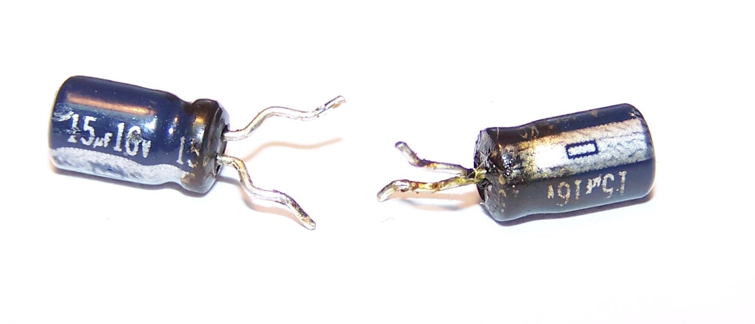

SOLVED warmup problem on CD Player 4
i found the solution!
i tried replacing the ic CXA1082BS with no success.
Then i searched around the ic and i found a defective capacitor C122 (15µF/16V) and when i removed this capacitor, there was some brown juice on the leads. (see photos)
I tried to replace it with 22µF and it does not work. Then i tried with 10µF and it works fine! Now the focus is doing it's normal oscillation, the lens goes up and down normally.
I have 2 units of this CD Player4 here and these 2 units have the same problem, solved by replacing this capacitor. So i think this can help someone else!
You can see the attached circuit with the capacitor C122 in a red circle.
Have a good day!
