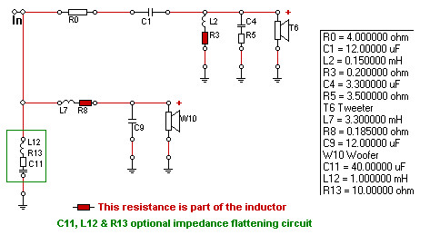

I'm trying to design a crossover for an MTM system using a pair of SEAS ER18RNX wooofers and a 27TDFNC/GW tweeter. Zaph Audio has a 2-way system, the SR71, using the same woofer, but a different SEAS tweeter. Specs for his drivers are:
Tweeter: 6 ohm (nominal) Re = 4.8 ohm
Woofer: 8 ohm (nominal) Re = 5.9 ohm
Crossover 1750Hz.
Actual component values Zaph uses:
Hi-pass filter: C1 = 12uF
L1 = 0.15mH
Lo-pass filter: C2 = 12uF
L2 = 3.3mH
Both filters are LR2.
But two different calculators give these values:
--- if you use nominal impedance:
C1 = 7.58 uF
L1 = 1.09mH
C2 = 5.69uF
L2 = 1.46mH
--- if you use Re:
C1 = 9.48
L1 = 0.87mH
C2 = 7.71uF
L2 = 1.07mH
2-Way Crossover Designer / Calculator
mh-audio.nl - Crossover Networks
The audio.nl calculator indicates you should use Re. The DIY merely asks for "speaker impedance," which one would assume to be the nominal impedance.
Which should one use?
In either case the values are wildly different from those Zaph is using. He does have a notch filter on the tweeter. Does that resistance need to be included in the tweeter Re? Does it affect the values of the woofer cap and coil also?
I've done these comparisons with a couple other actual v. calculated crossovers. None of them agree.
Are these calculators of any value? Am I misusing them?
Thanks for any help!

The calculator only take into account limited data (e.g. impedance), and is just an approximation. Good speaker design take into account a lot more data, like the real frequency response of the drivers.
The calculator calculates a "gross crossover". Unusable for probably 99% of situations.

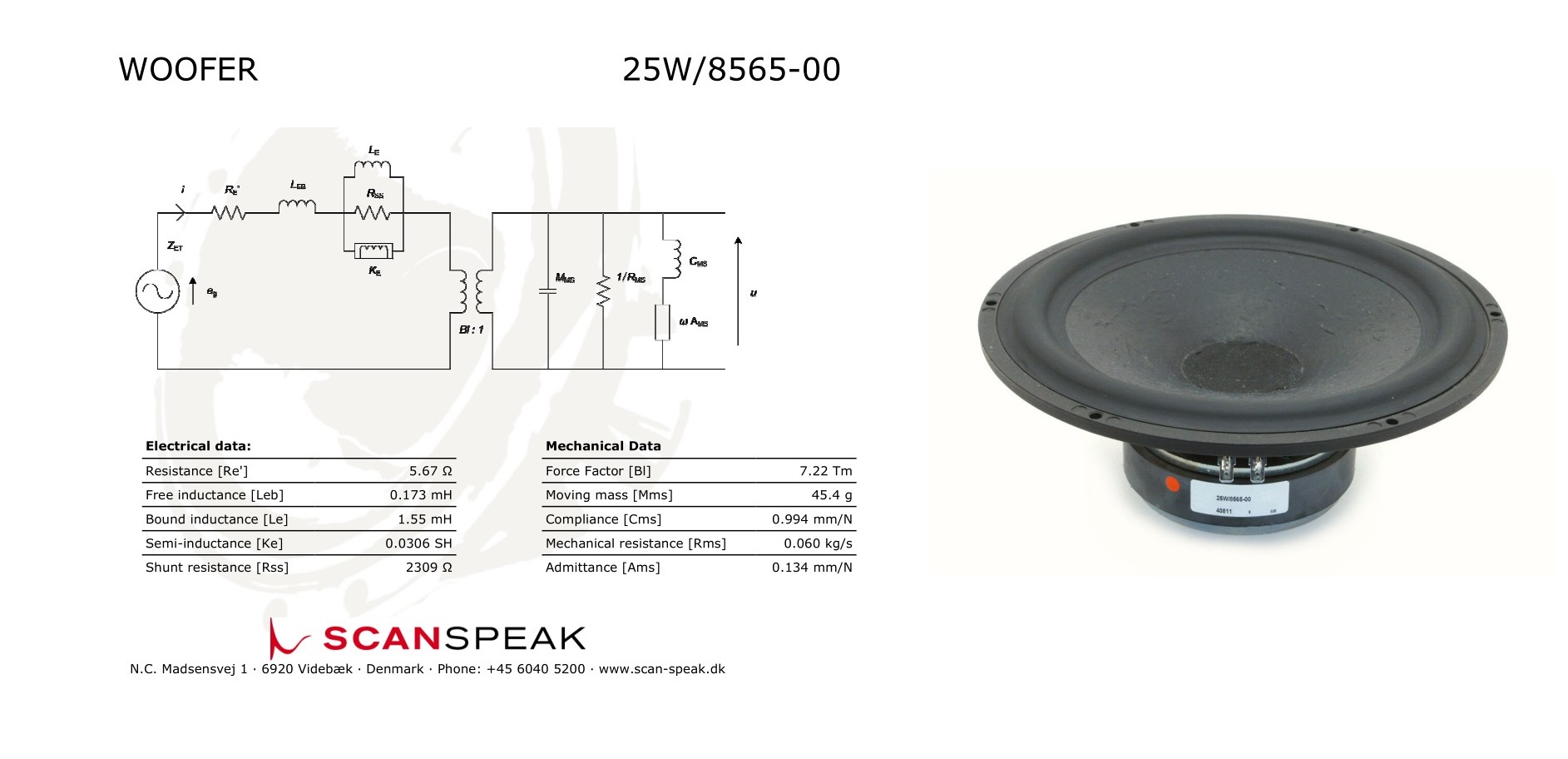

Gary, as newbie you should look into loudspeaker crossover design and Spice software for approximation to the final simulated projects.
Those calculators you show are only for a limited set of inputs like approx. calculation at one and only frequency, like using Re. Data sets from drivers (go look at spec sheets for your drivers) are in the time domain like impedance from 20Hz to 20KHz, so it's a curve. When calculating the crossover with a Spice type software you use variables (in the time/frequency domain or continuous/curves datasets) like impedance, output, phase in relation to each other. Those are many times called the frd/zma variables or data, that were measured and transfered to numbers to be used by the applications.
Vented-Box Loudspeaker CAD With SPICE
A Spice application works very much with those sets of data like the electric simulations of the ideal drivers as you can see in this simulation in the pic by Scan-Speak for driver 25W/8565-00 here. Notice Re that you mentioned, a T/S parameter, on the left of the picture. 🙂

the online calculators if you give them the actual impedance at the crossover point are good for getting a starting point, but that is about it.
Proper measurements (impedance and spl) and simulation with Jeff Bagby's PCD and Spekaer workshop should get you MUCH better results than what you could possibly get using online calculators. using SPL trace from manufacturers curves + above mentioned software should also give you much better results than the online calculators.
The simulators take into account the changing impedance of the driver AND the changing spl. The calculators assume these are both constant.

Even if you use the specific impedance value at the crossover point, a crossover isnt a brick wall... Impedance will rise with frequency. At the minimum you should have someone figure out a zobel circuit to achieve a completely flat impedance curve, which will get you closer to usable results. I can easily do this for you if the drivers you're using have a manufacturers curve available.
You still will have no way of adjusting the response based on the acoustic offsets, for proper phase integration, but you can at least have a speaker without large peaks and dips.
